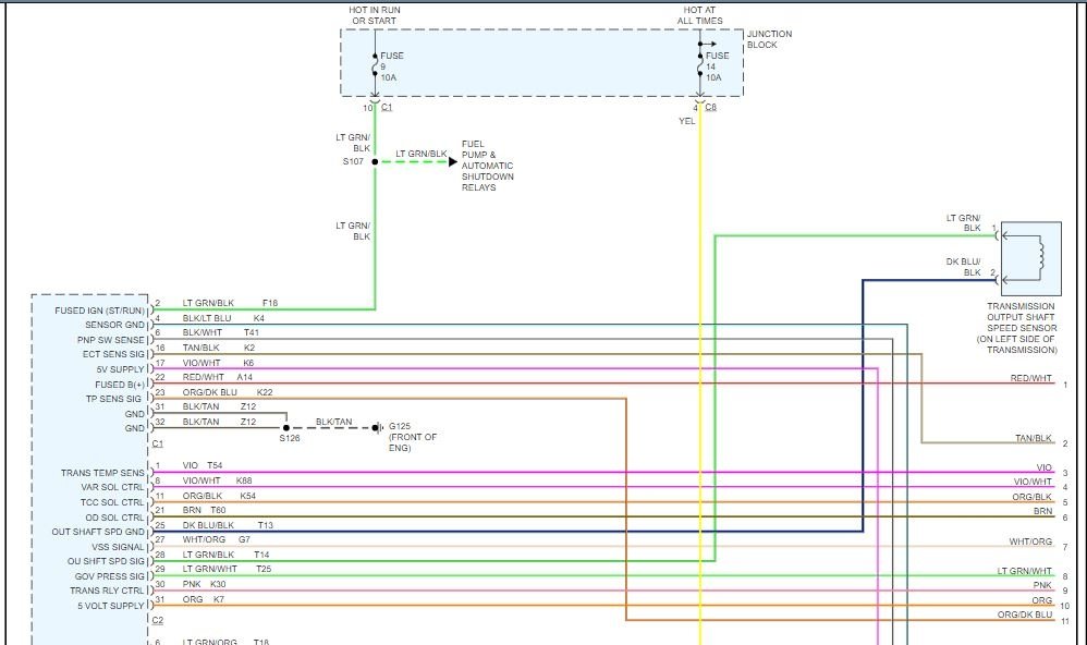

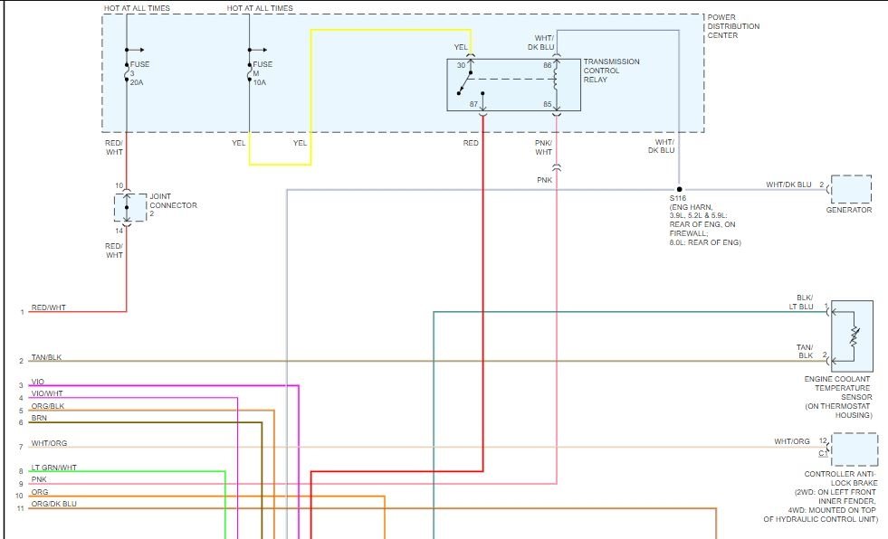

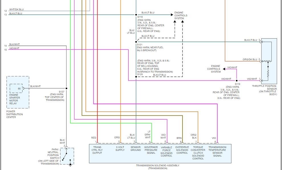

Good afternoon,

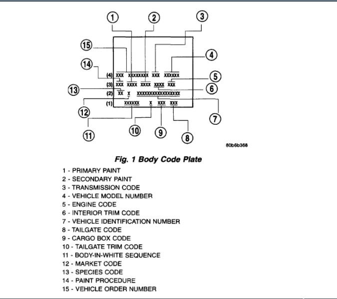

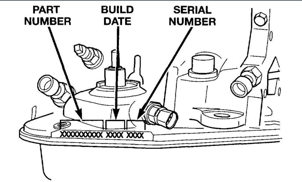

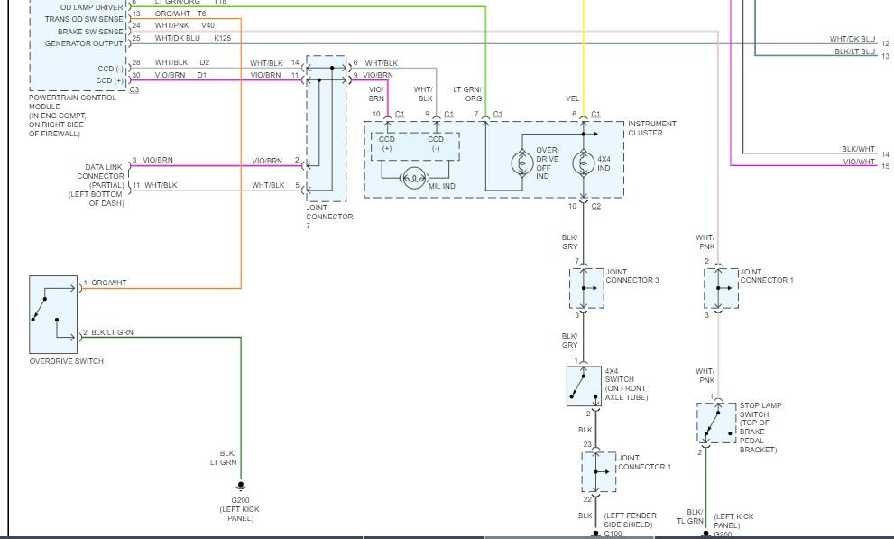

I attached the possible transmissions for the trucks. The 1998 only offered one but the 2001 offered a few. You need to match up every sensor and connector to be sure they are exactly the same. All the transmissions will fit but the wiring is more important.
I attached the wiring diagram for your 98 below for you to match up with the donor.
DIGITS 13,14, AND 15
Transmission Codes
- DGP = 4-speed Automatic (47RE)
- DGT = 4-speed Automatic (46RE)
- DGK = 4-speed Automatic (42RE)
- DDP = 5-peed Manual (NVG-4500)
- DDX = 5-speed Manual (NVG-4500 Heavy Duty)
- DDC = 5-speed Manual (NVG-3500)
- DEE = 6-speed Manual (NVG-5600)

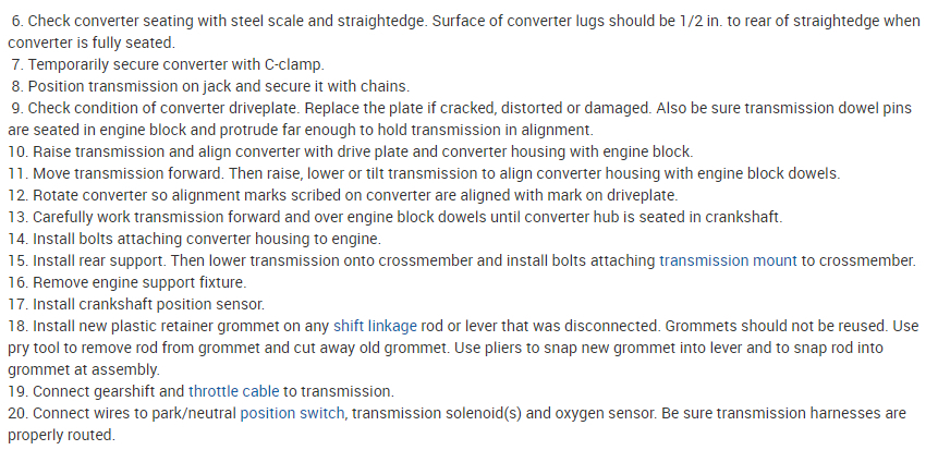

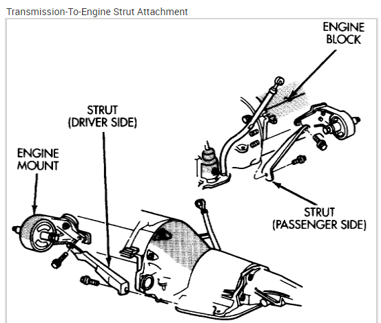

Hello, I'm Danny.

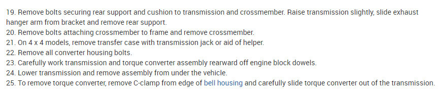

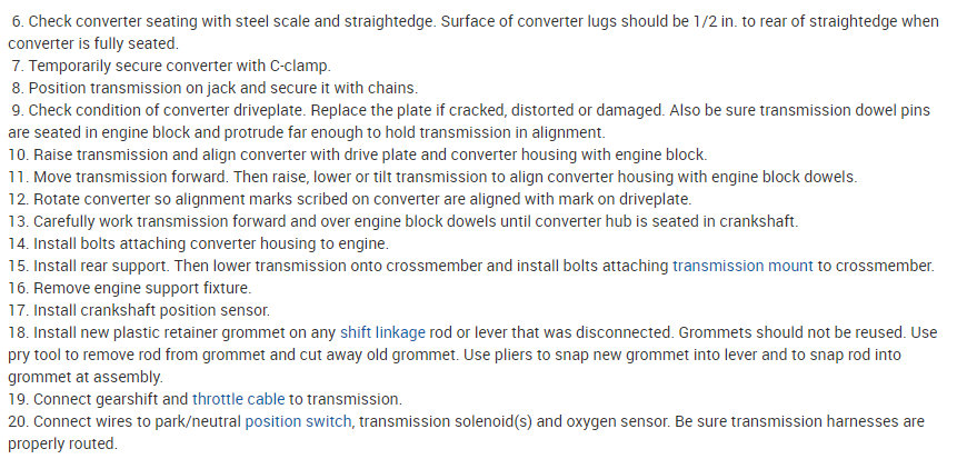

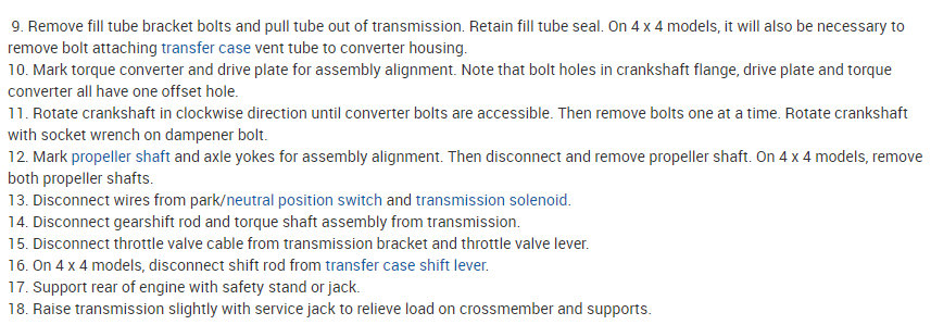

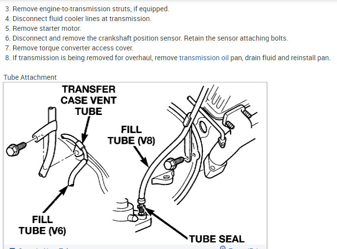

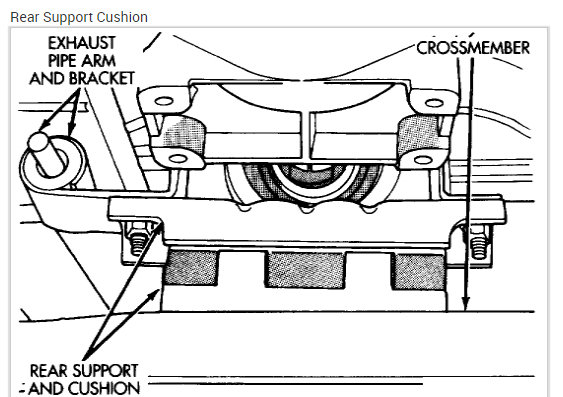

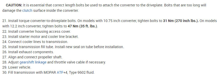

Here is a tutorial showing how to remove and replace a manual transmission which is similar:
https://www.2carpros.com/articles/transmission-replacement-removal-manual

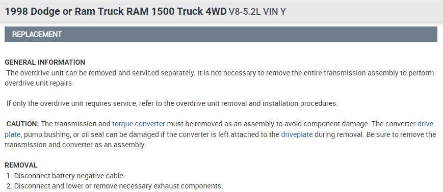

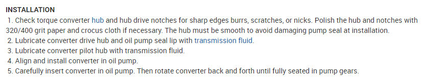

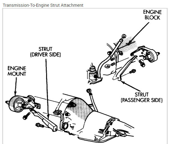

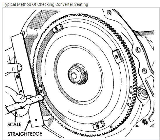

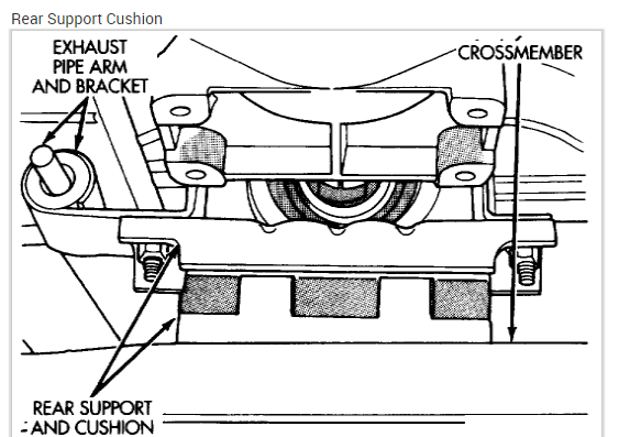

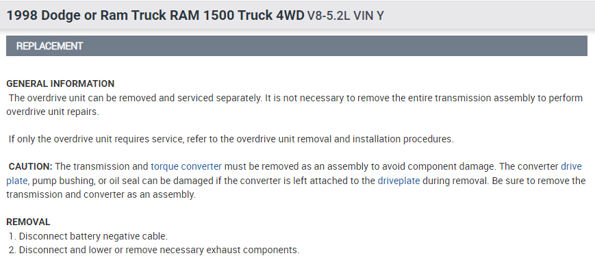

I've attached picture steps below on how to remove and replace the automatic transmission on your truck. Hope this helps and thanks for using 2CarPros.
