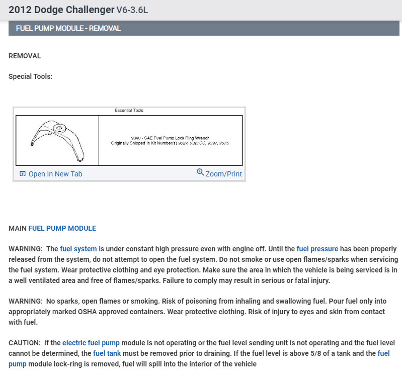

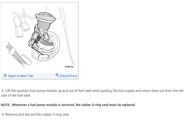

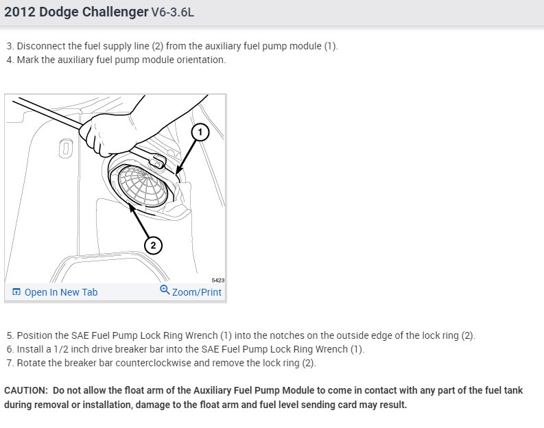

My fuel pump is out, and I know because I've already changed the fuel pump relay and fuse. Had the pump tested and it's no good. The pump that is available costs $469.99 (that's a lot of money for me) however, my friend had a 2014 Chevy Camero v6 and she bought a fuel pump, and it turned out to be her relay. Her pump was only $81.00 and I was wondering if they were interchangeable. Murphey's law was written for me so I'm sure it won't work but there are times I get lucky.
Thank you in advance!
A broke single mama that is hoping for a lucky day,
Jerimie
Jul 21, 2022 at 9:48 PM
SQM
  • 6,383 POSTS

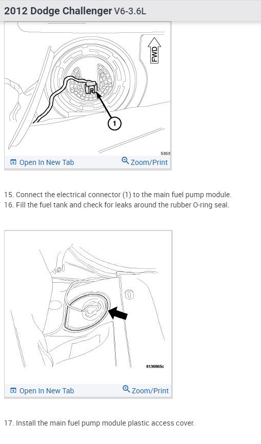

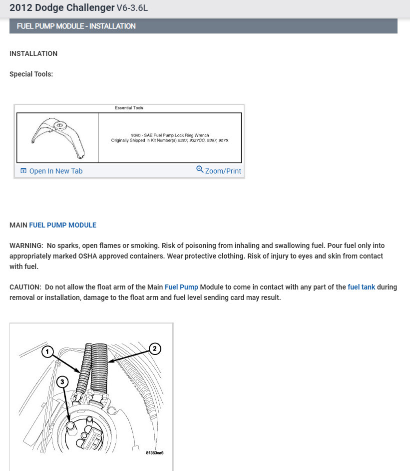

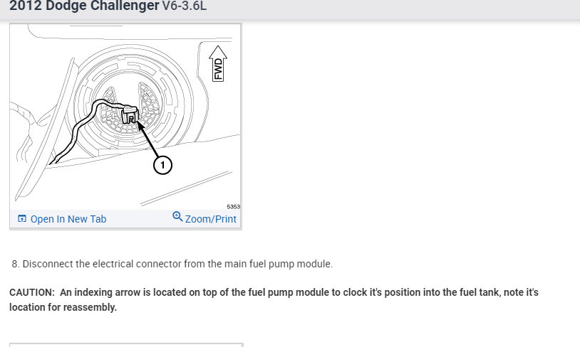

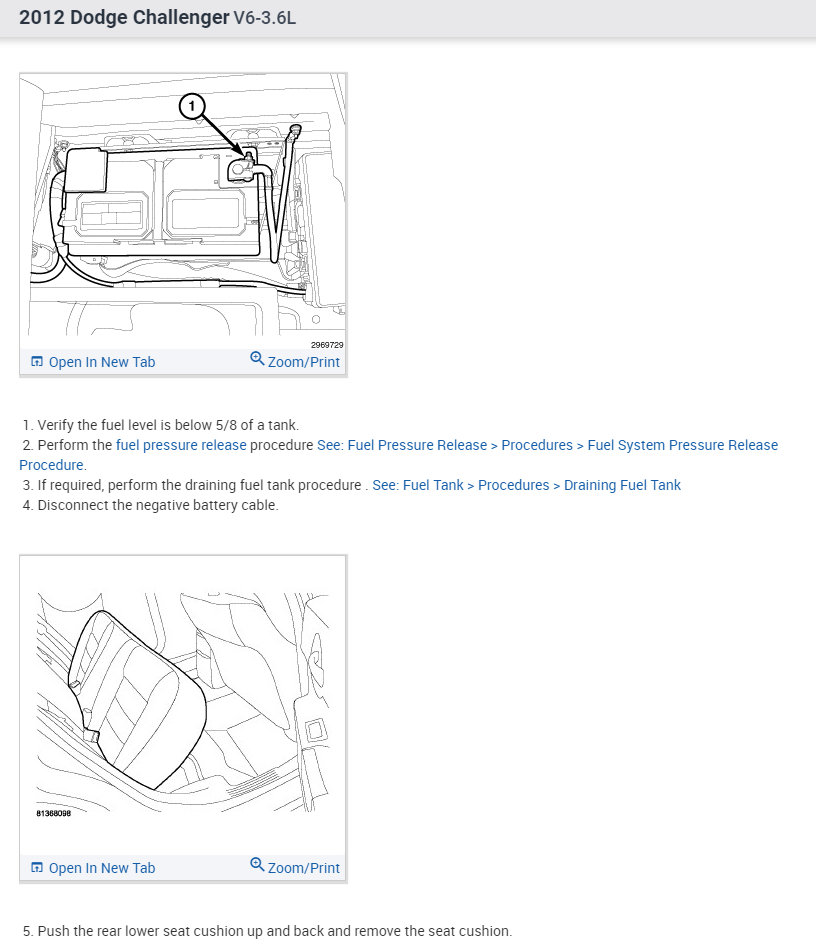

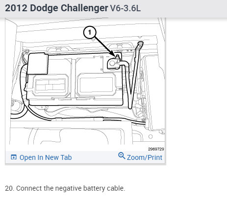

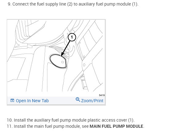

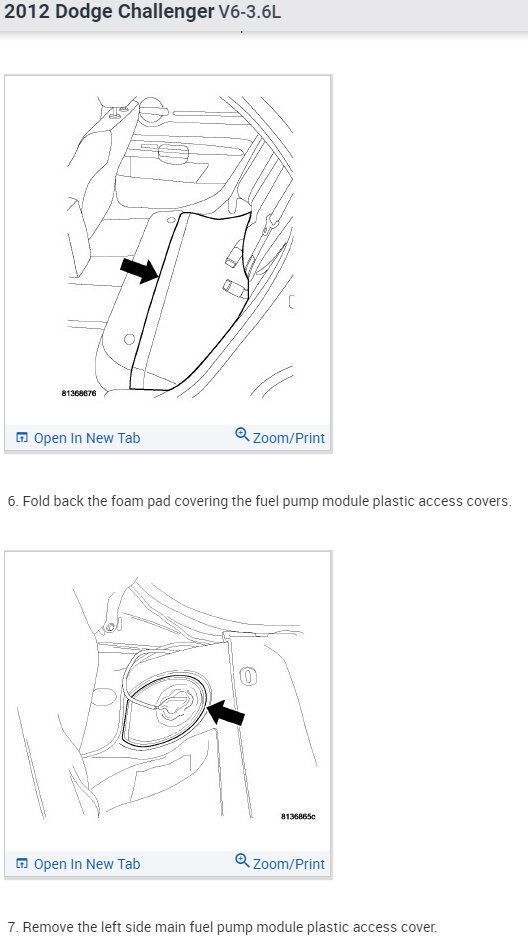

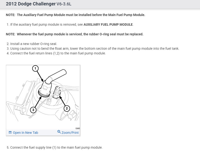

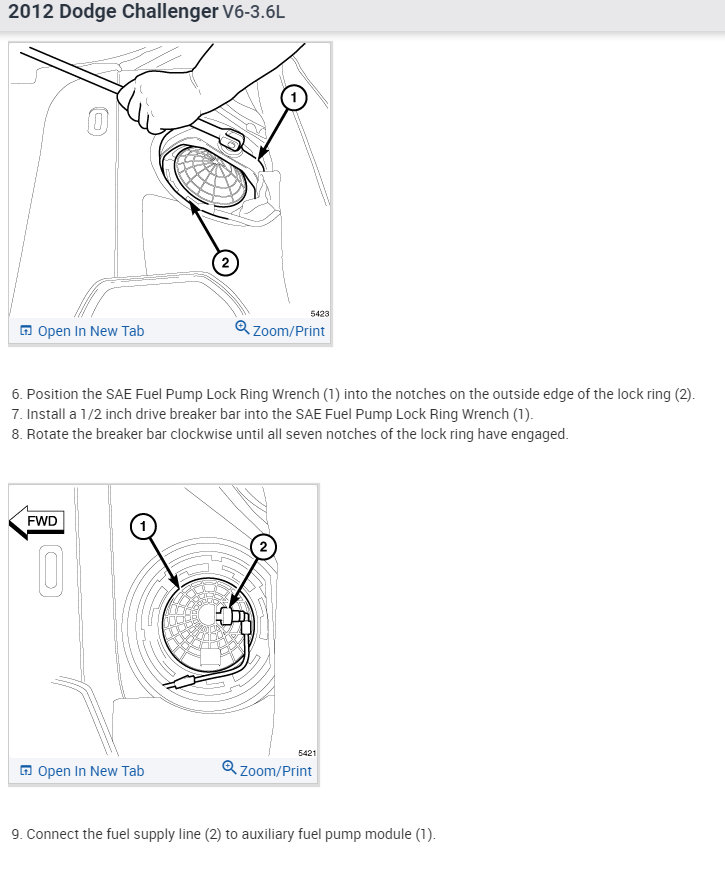

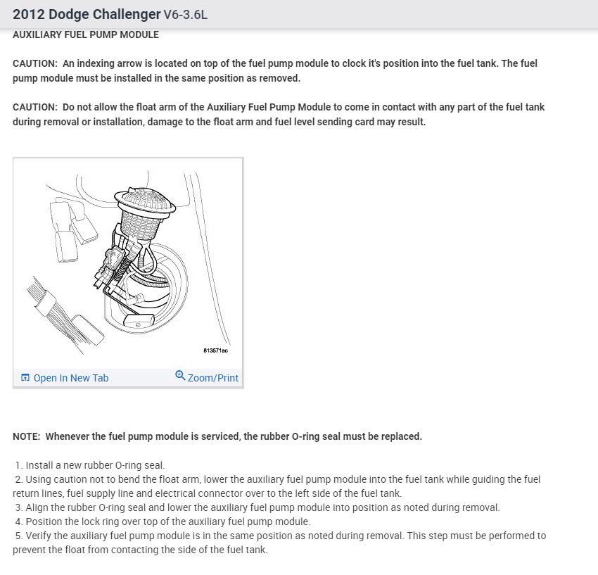

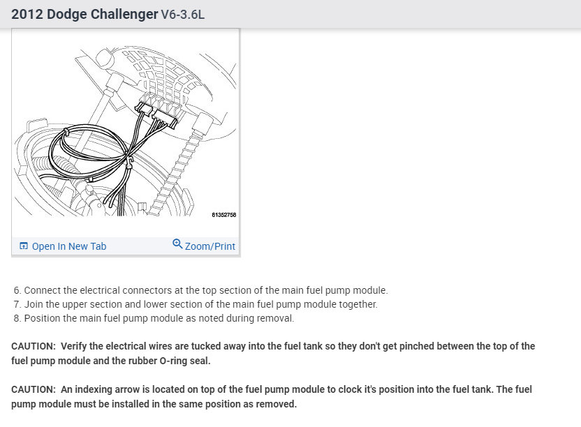

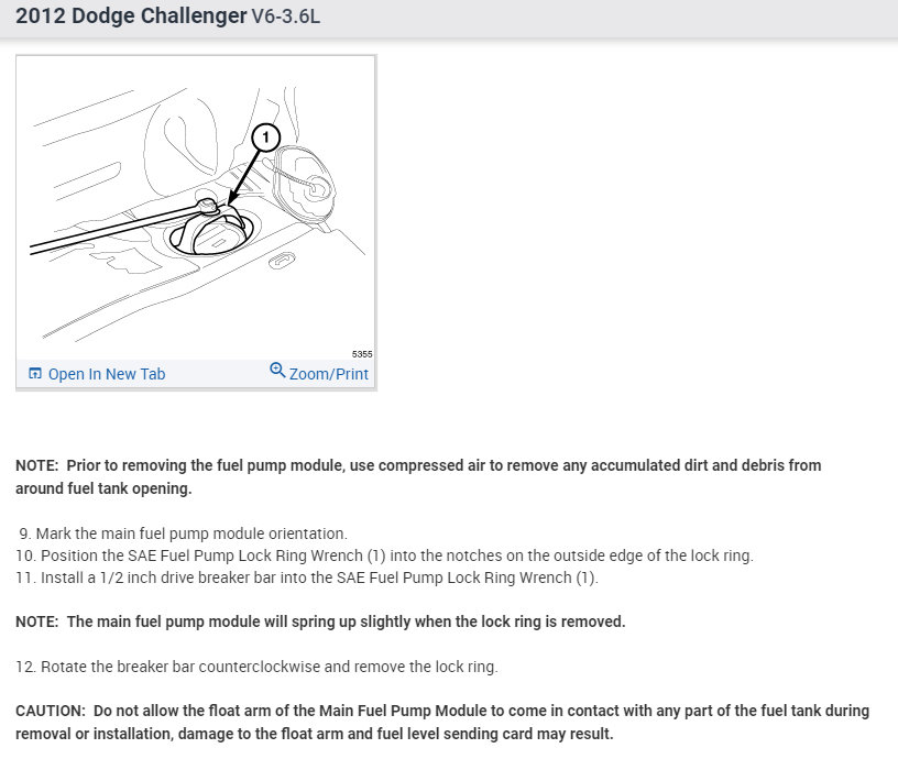

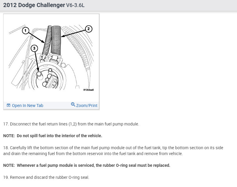

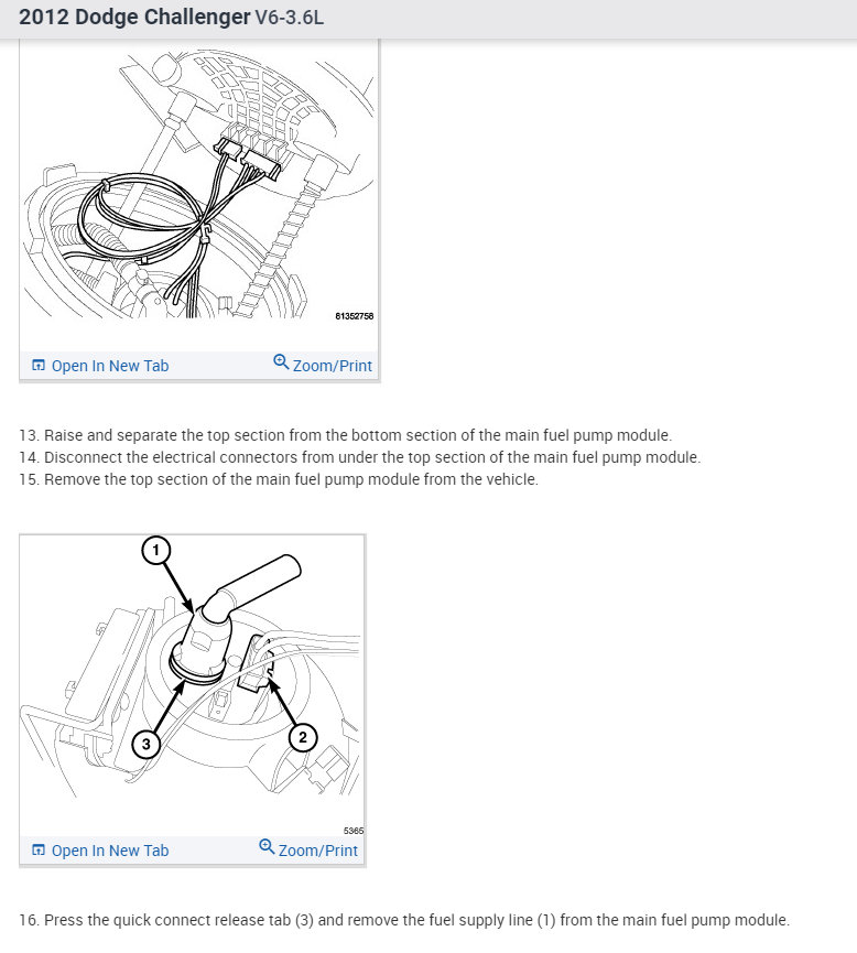

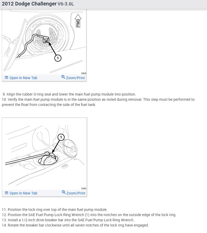

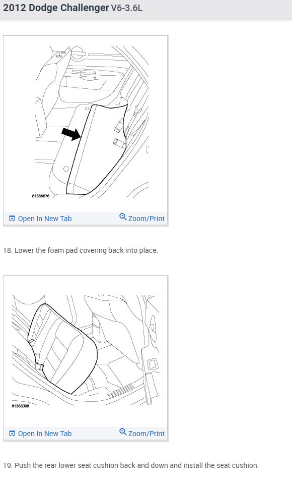

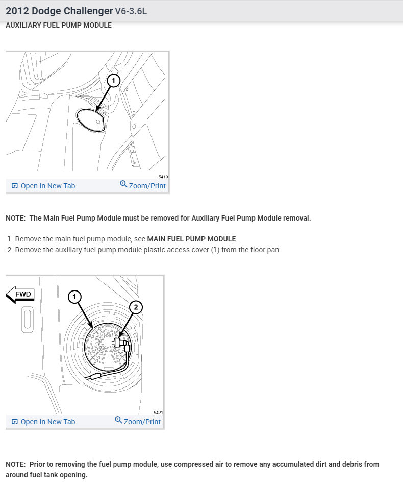

Unfortunately, those fuel pumps are not interchangeable as they have different specifications and dimensions.
https://www.2carpros.com/articles/how-to-replace-an-electric-fuel-pump
I have attached the fuel pump replacement procedure below for your reference.
Let me know of any questions.
