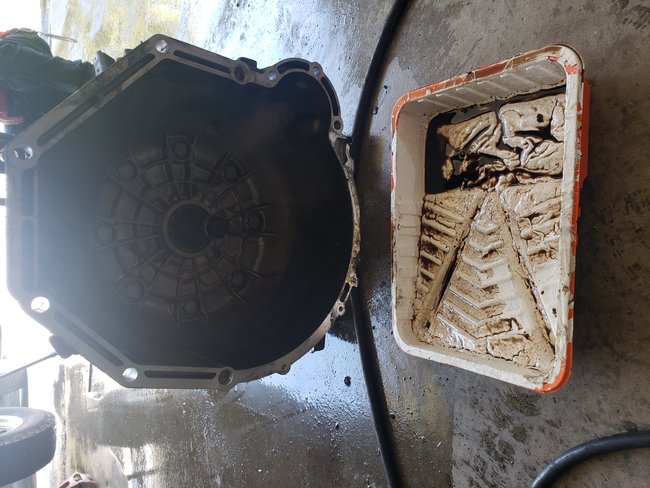

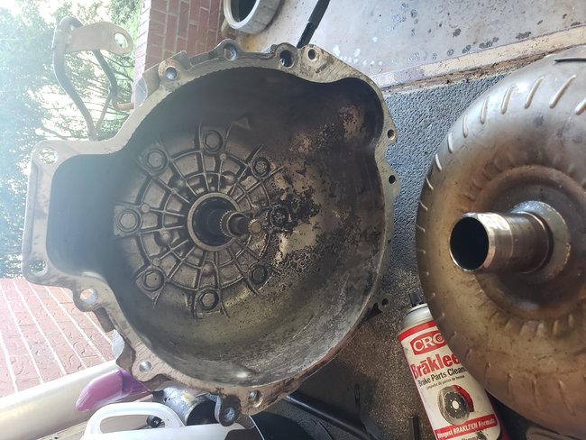

Replacing the burnt transmission in this truck. Tag says 4L5P and the replacement transmission says 5L5P. Everything looks identical, the electronics , wiring, tail housing, even trans filters. But the bell housings look different. Input shafts are identical. Torque converters were not identical. Can the bell housings be swapped? Replacement transmission came out of a 2005 Ford Explorer sport trac.

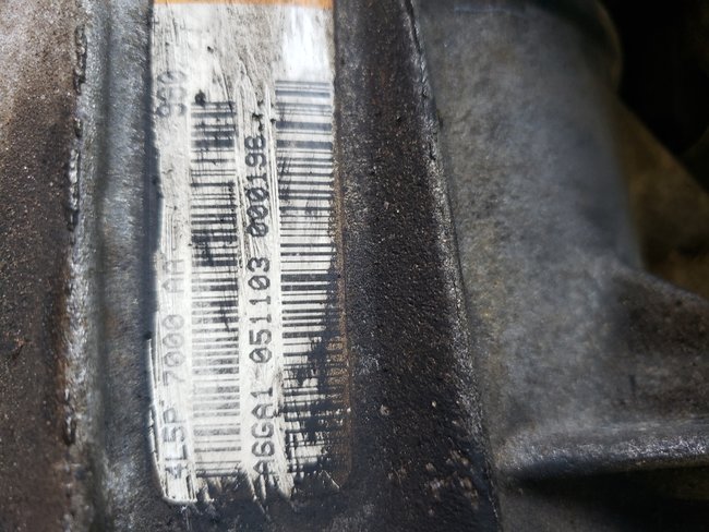

Even though the tags are different they are both 5r55e though?
Sep 30, 2020 at 4:42 AM
DANNY L
  • 5,648 POSTS
Hello again.

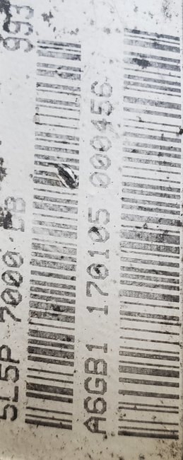

Can you take a picture of the tags on both transmissions with you cell phone and upload here? Let us know and we'll go from there. Thanks again for using 2CarPros.
Danny-
Sep 30, 2020 at 6:42 AM
CANNON1349
  • 861 POSTS
Here you go:
Sep 30, 2020 at 6:46 AM

Well, I went to the junkyard today and got a transmission out of an 2005' Ranger, same bell housing and everything so I should be able to hook them up, right? They look identical all the way around and I should only need to put a new filter in it. The old tag from the old trans is 4L5P-7000-AA and the tag from the junkyard trans is 5L5P-7000-AB.

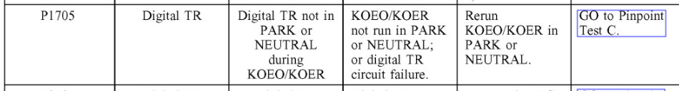

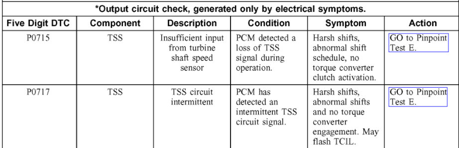

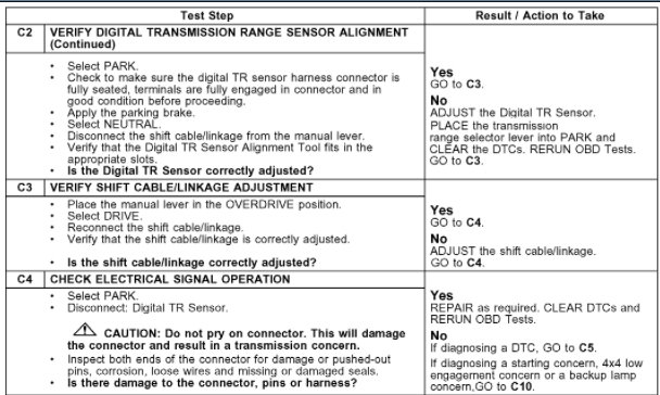

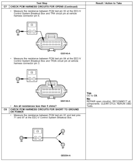

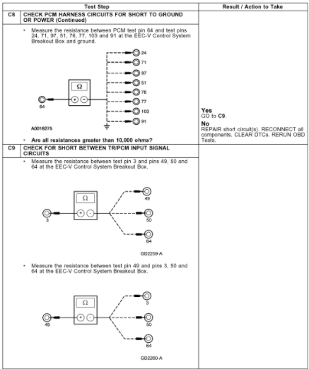

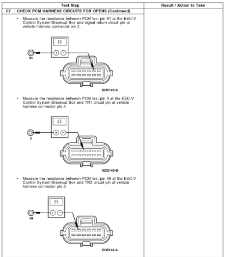

I got the transmission from the 2005 Ranger installed, with its matching converter, and new converter nuts. Poured in 5 quarts before I started it (as fluid just sat in the funnel), and got to 8 quarts before the stick began showing full. However, the transmission will not engage. When I select a gear I can see the rpm changes and hear the buzzing/whirring noise of engagement while under the truck, but there is no physical engagement. I feel like I'm missing something simple here. I am getting the following codes:
P1705
P0717
P0715
Oct 11, 2020 at 11:01 AM

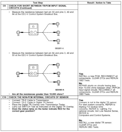

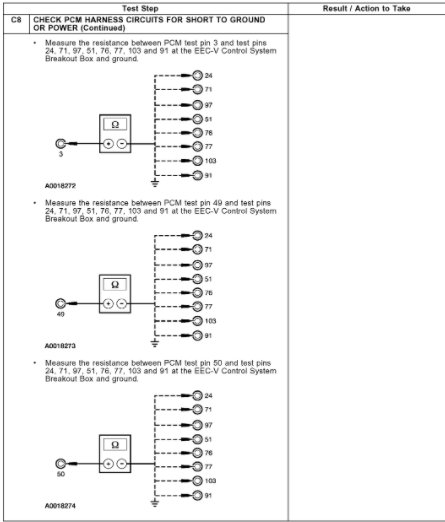

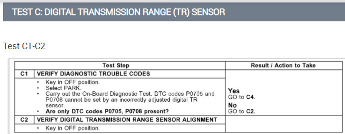

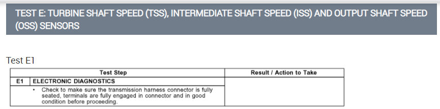

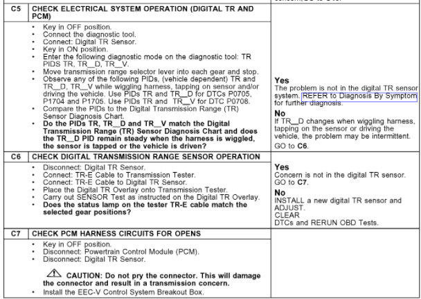

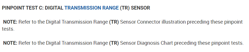

DANNY L
  • 5,648 POSTS
Hello again.

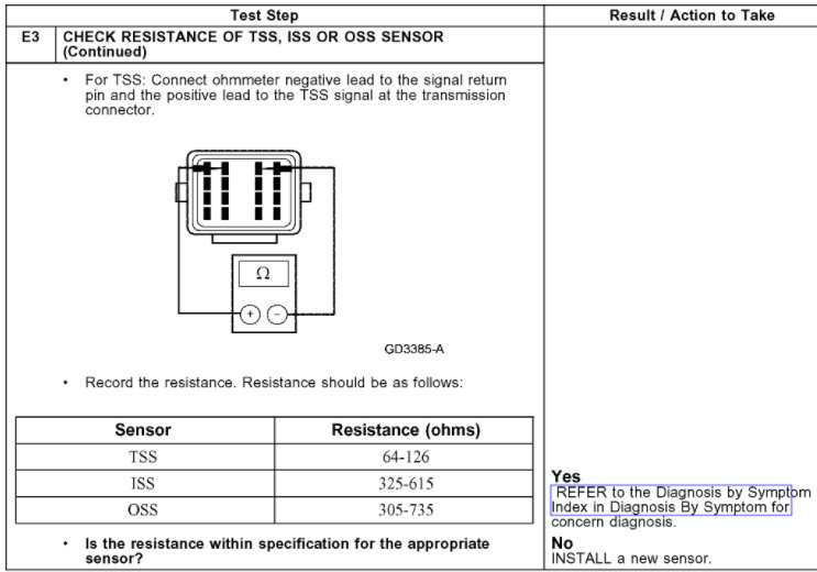

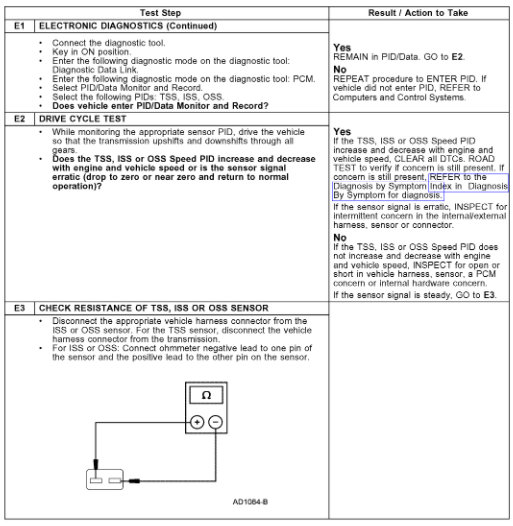

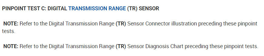

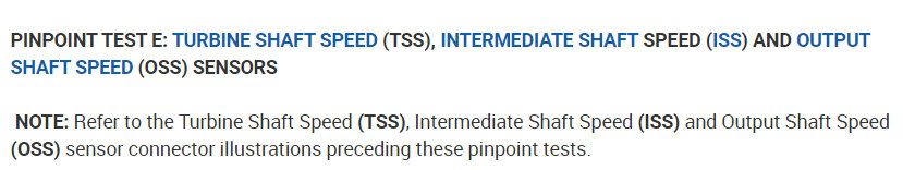

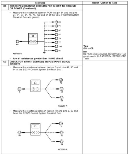

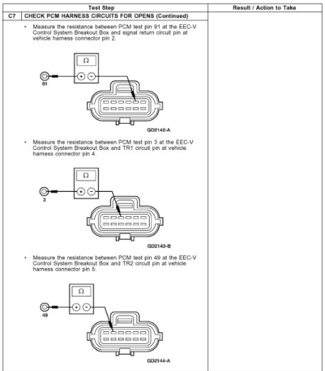

I've attached picture diagnostic steps below for the transmission codes you provided. Some includes wiring testing so here is a tutorial showing how to test wiring:
After testing get back to us with the results and we'll go from there. Hope this helps and thanks again for using 2CarPros.
Danny-
Oct 11, 2020 at 4:55 PM
CANNON1349
  • 861 POSTS
So at the TSS and ISS I am getting a resistance of 1. however, on a different terminal on the TSS I can get a resistance of about 460 ohms, not that it matters I guess. I'm really confused, I have backup lights and everything but this stuff was working prior.
Oct 12, 2020 at 8:57 AM
CANNON1349
  • 861 POSTS
Wait, I think I messed up. The instructions want me to measure the resistance of the sensors connected to the transmission, or the wires going TO the transmission? The TSS on the trans right now is reading 78 ohms. Which should mean the sensor inside the transmission is good.
Oct 13, 2020 at 7:50 AM
CANNON1349
  • 861 POSTS
And the ISS is 389 ohms.
Oct 13, 2020 at 8:25 AM
CANNON1349
  • 861 POSTS
Okay, so the PID for the TSS is 0 when engine is idling or revving. So since they pass the ohm test I guess we should move to checking wiring?

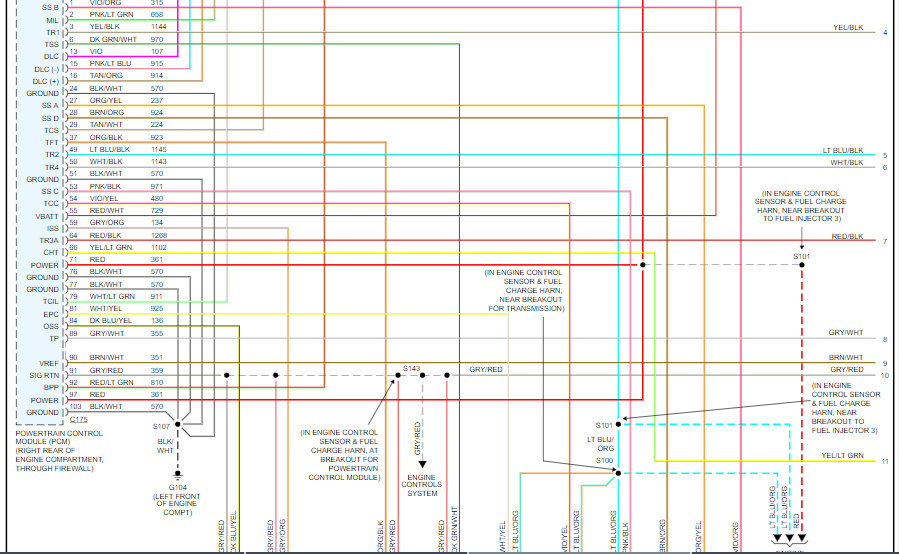

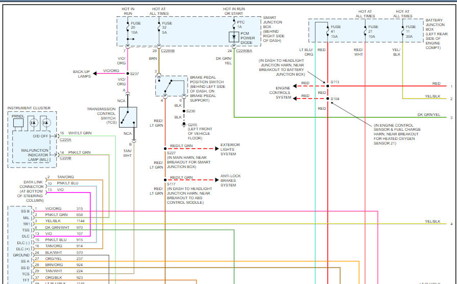

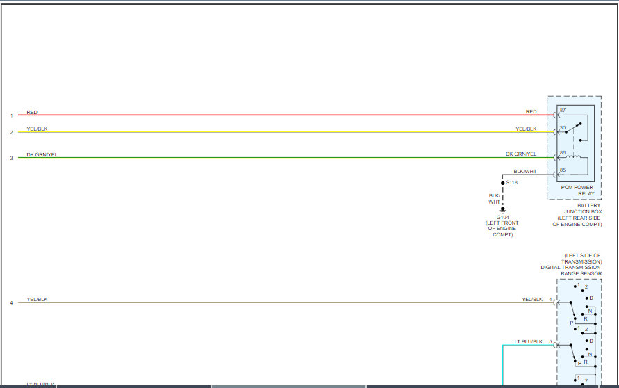

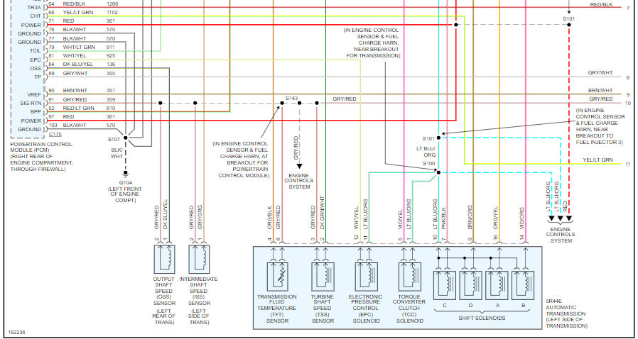

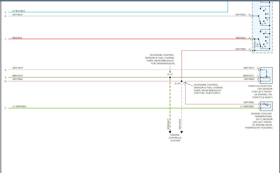

DANNY L
  • 5,648 POSTS
Hello again.
Okay, I've attached the wiring diagram for the automatic transmission for your truck below you requested. I've cut the pictures into a few pieces so you can view larger so it might overlap a little. Also, When you mentioned adding transmission fluid the actual capacity shows 10 quarts. Is this a good known used transmission? Was it tested or know to work when removed? Any warranty? Hope this helps and thanks again for using 2CarPros.
Danny-

CANNON1349
  • 861 POSTS
I guess as far as wiring goes, how many volts should be at those terminals on the TSS and ISS connectors? And should it be the same at the PCM end?
Oct 13, 2020 at 12:36 PM
CANNON1349
  • 861 POSTS
I'm checking for voltage on the same 16 pin connector to the transmission. I'm getting no voltage for the 2 pins that are supposed to be for the TSS.
Oct 13, 2020 at 11:40 PM
CANNON1349
  • 861 POSTS
So the signal return wire for the tss, oss, and vss is giving no voltage. So, the connectors down at the trans are giving zero readings. However the TR sensor has voltage and the computer does know when I select a gear.
The red wire splits to those 3 trans sensors, and joins at the transmission break out according to your diagram. It then splits to the TPS sensor and ECT sensor and goes to the PCM. At those sensors, I also have no voltage at that red wire.
Oct 14, 2020 at 1:48 AM
