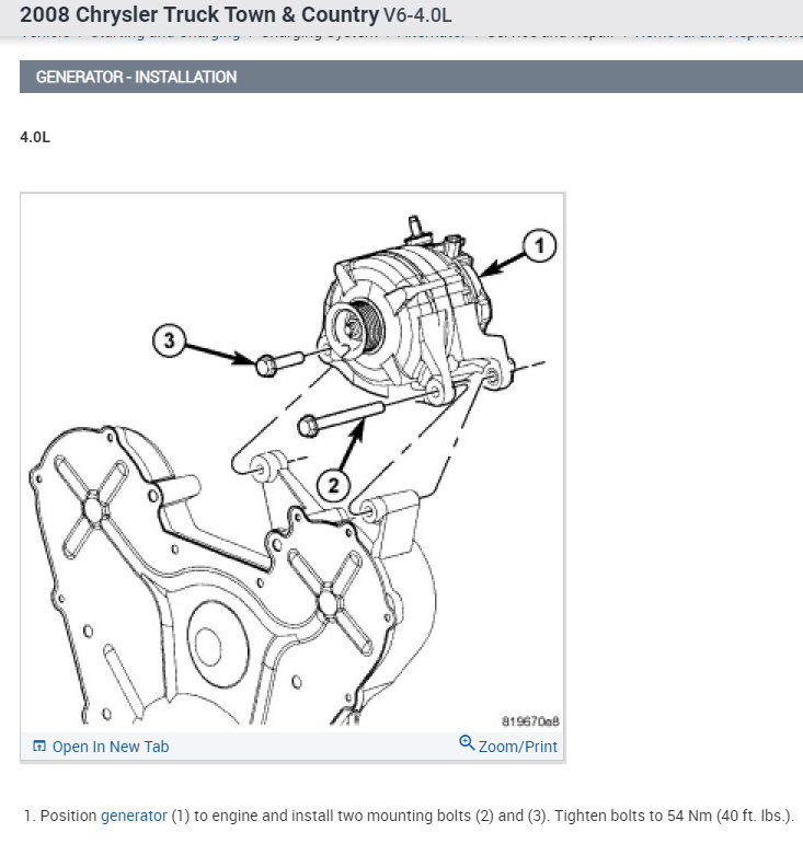

Are there any other vehicles that have the same alternator as the van listed above?
And will they bolt up the same?
Thanks!
Jun 22, 2022 at 3:22 AM
SQM
  • 6,383 POSTS
This alternator is used on Town and Country and Dodge Caravans for the years 2008 - 2010, with the 4.0L V6 engine.
The OEM part number for the alternator is 4801480AB.
https://www.2carpros.com/articles/how-to-replace-an-alternator

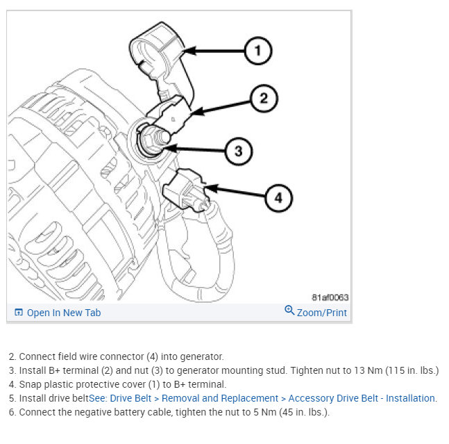

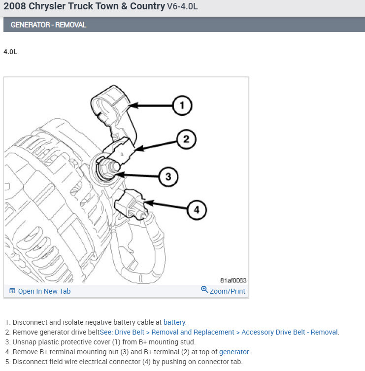

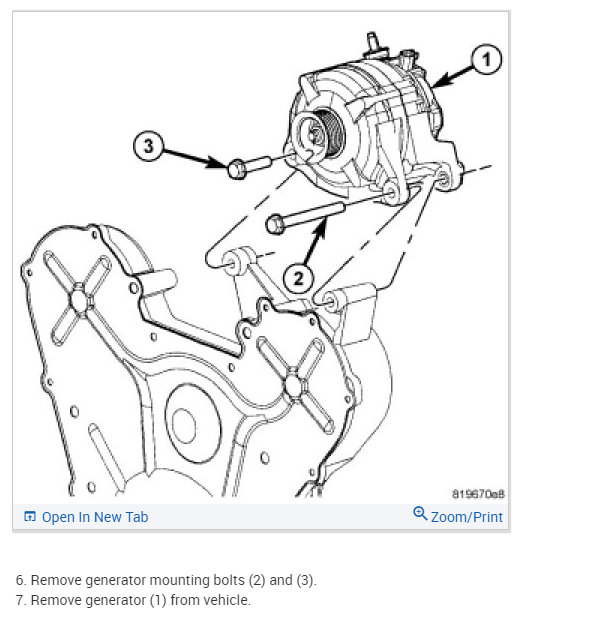

I have attached the alternator replacement procedure below for your reference.
