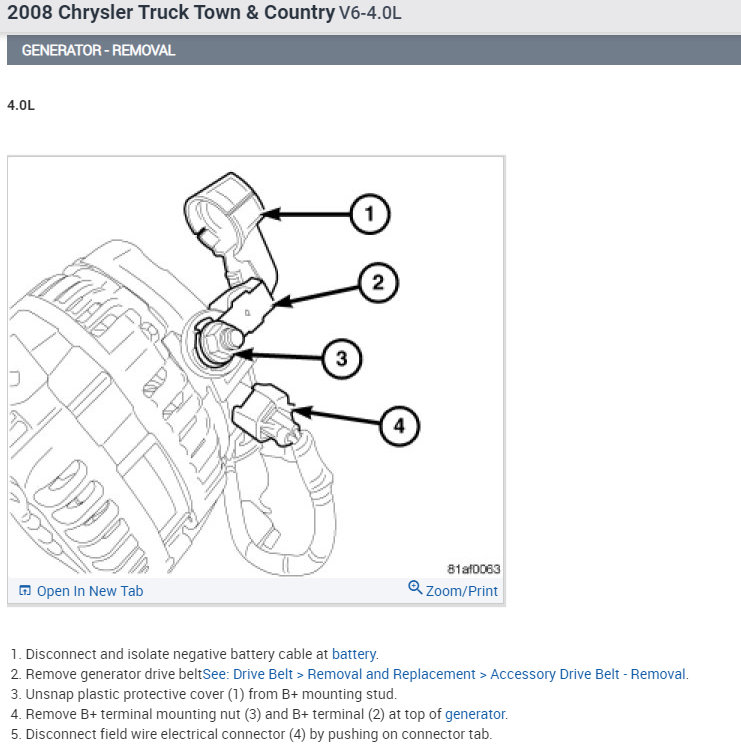

Are there any other vehicles that have the same alternator as the van listed above?
And will they bolt up the same?
Thanks!

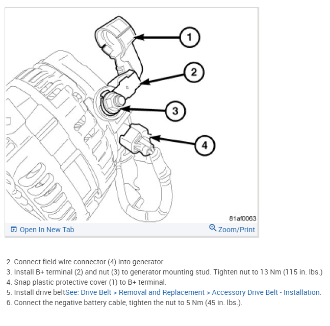

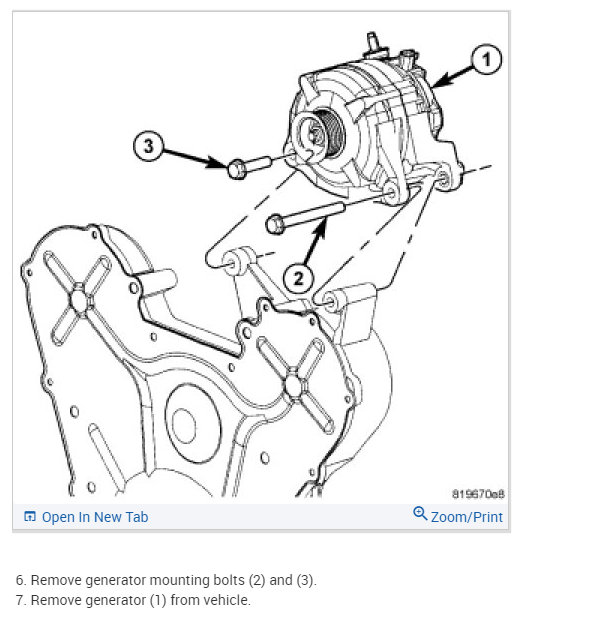

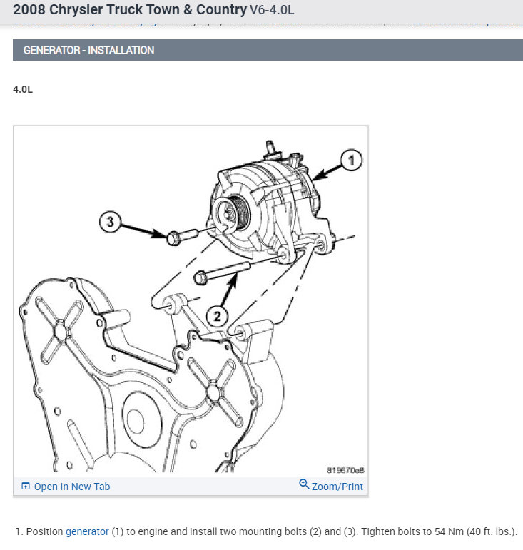

This alternator is used on Town and Country and Dodge Caravans for the years 2008 - 2010, with the 4.0L V6 engine.
The OEM part number for the alternator is 4801480AB.
https://www.2carpros.com/articles/how-to-replace-an-alternator
I have attached the alternator replacement procedure below for your reference.
Let me know of any questions.
