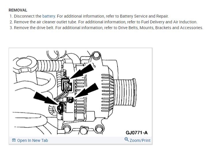

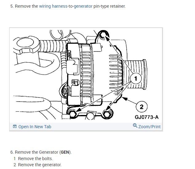

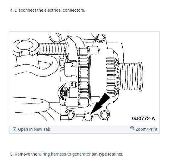

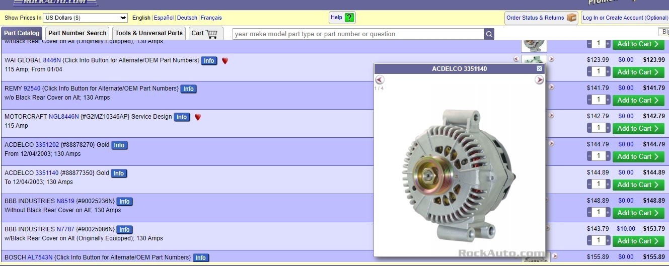

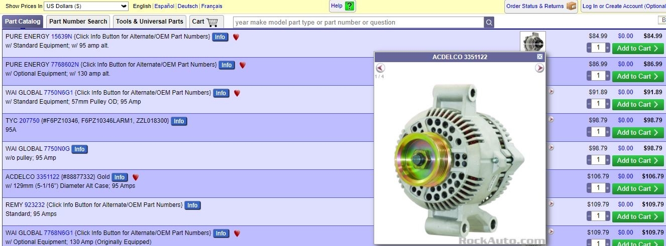

I need to know if the alternator off a 2000 Ford Explorer will fit a 2004 Ford Explorer trac.
Aug 6, 2021 at 9:08 AM
Experienced Mechanic
52,796 POSTS
Good evening,
I checked the part numbers and they are both the same. As long as 2000 has a 4.0 engine, they are the same.
https://www.2carpros.com/articles/how-to-replace-an-alternator
