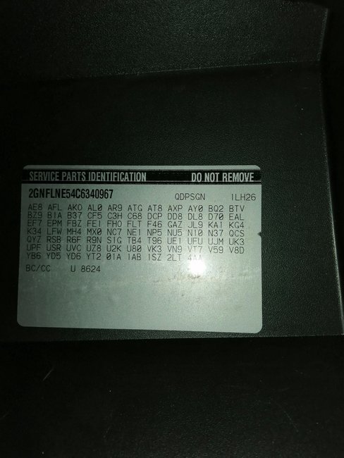

Vehicle listed above is an LT2, with VIN 2GNFLNE54C6340967.
I want to buy and change a Transfer Case (Getrag 760). I am not in the USA. There are no auto repair shops in my area. I know one original number of the Transfer Case GM 23247710. But the Transfer Case with this number is rare, I cannot find it. In order to expand the search area, I would like to know which Transfer Case numbers will fit my car. For example, I saw numbers 23247709, 24244573, 24246665, 24248012, 24255141, 24257133. But I'm afraid to buy them, because I'm not sure if they will fit my car. Can you tell me exactly which Transfer Case numbers will fit my car?

That should be able to use PTU assemblies - 23247710, 24244573, 24246665, 24248012, 24248520, 24255141 and 24257133 as they are interchangeable and simply updates of the original. Those were used on the Equinox, GMC Terrain 2010-16, Pontiac Torrent 2008-09 and Saturn Vue 2008-10 that have AWD and the 3.0 You cannot use one from the other engines as they have different mounts and electronics.
