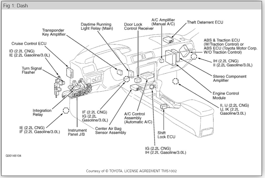

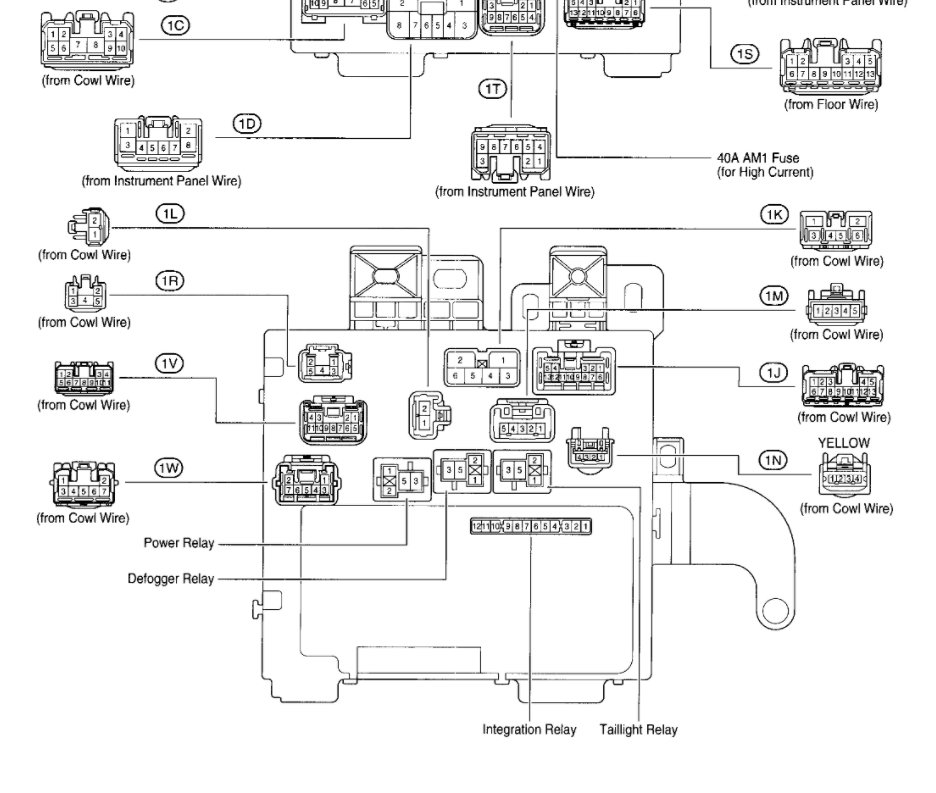

what are the steps to remove the integration relay without having to remove the fuse box?

It looks like the relay box needs to be removed, here are two diagrams that will help you located the relay and a guide to help you test it:
