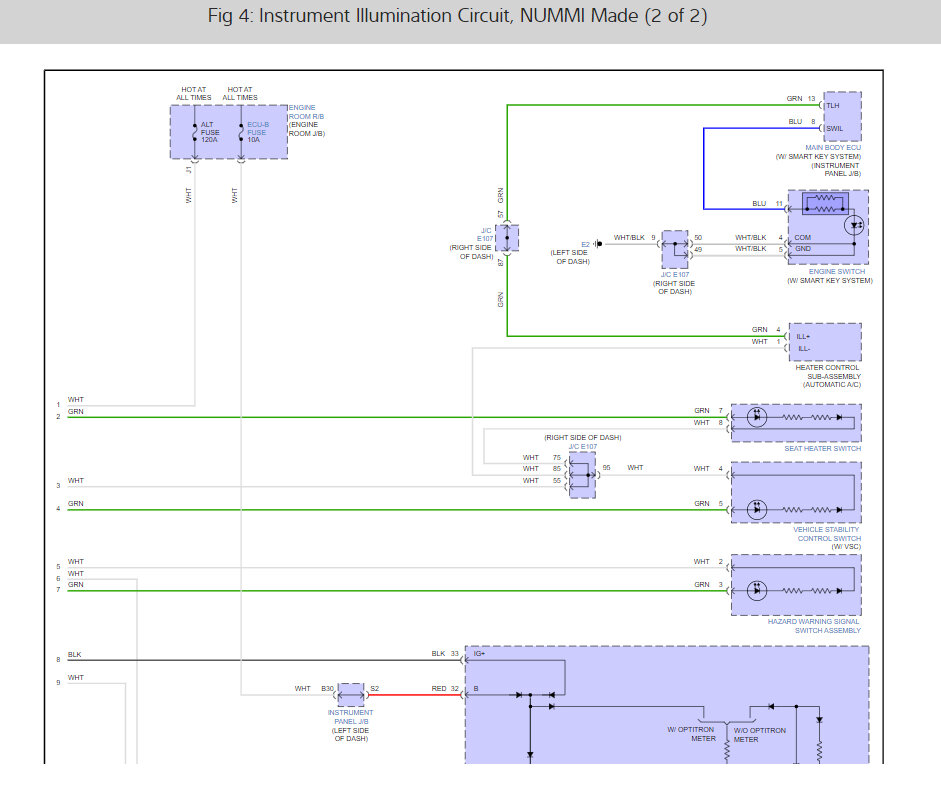

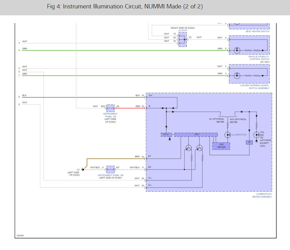

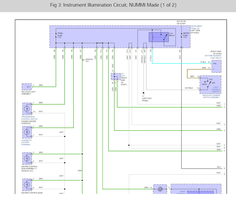

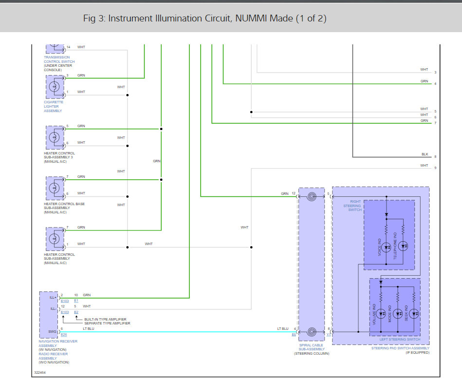

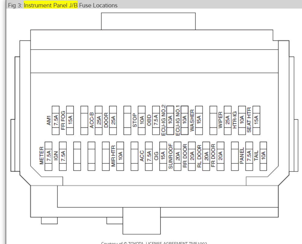

Hello, I have the car listed above S. When I turn the headlight on at night the dashboard light turns off but when I turn off the headlights the dashboard is on.
Help me please....
Oct 12, 2022 at 6:56 PM
  • 55,433 POSTS
In the fuse panel on the left side of the dash we need to check the Panel and Meter fuse both are 7.5 amp. here is a guide to help and the fuse locations as well in the images below, I have also included the dash illumination wiring diagrams so you can see how the system works.
Check out the images (below). Please let us know what you find. We are interested to see what it is.
