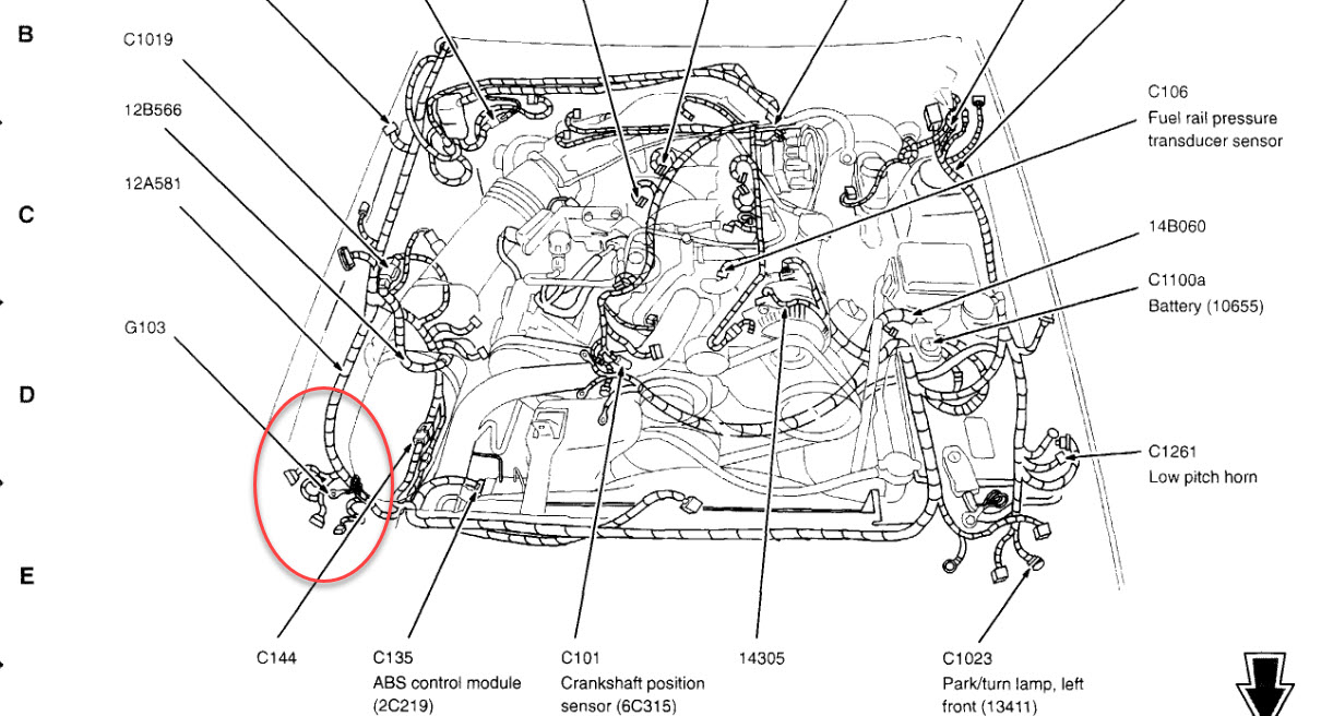

If have codes P2006, P1233, P2014, I replaced the intake runner control valve and the fuel driver module and it still stalls on me and those codes come back, my right headlight is dim and when it stalls the pass market light is stuck on. any ideas?

The intake manifold runner control and the constant control relay module (CCRM), and the right headlight share the same ground, which would make sensor of all of the codes indicated, along with the dim headlight. I would start by cleaning this ground before doing any extensive testing. Here is the location of ground G103:

Thanks a lot! You might have bailed me out.
