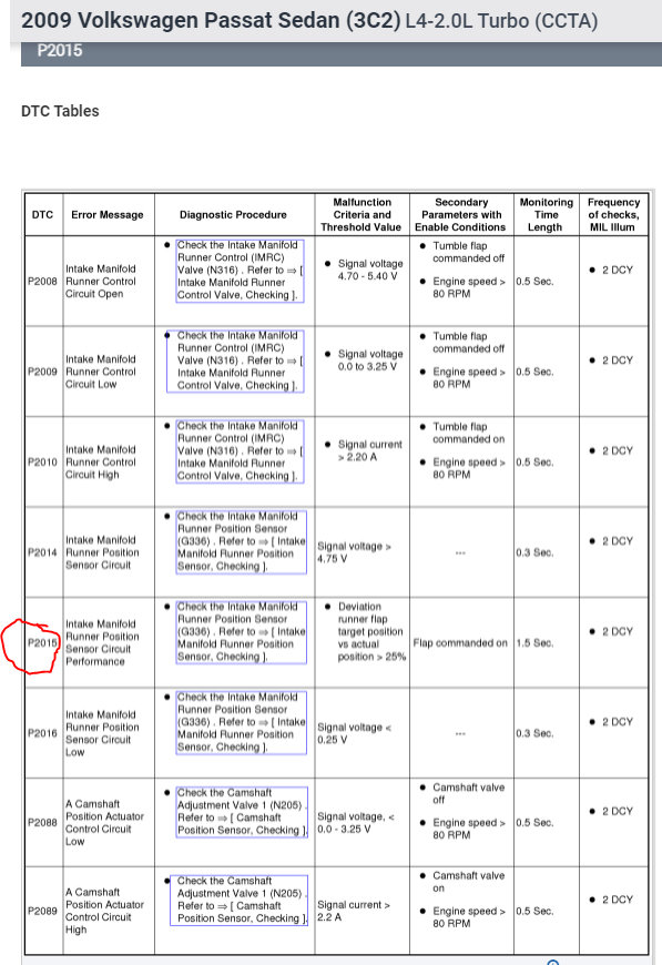

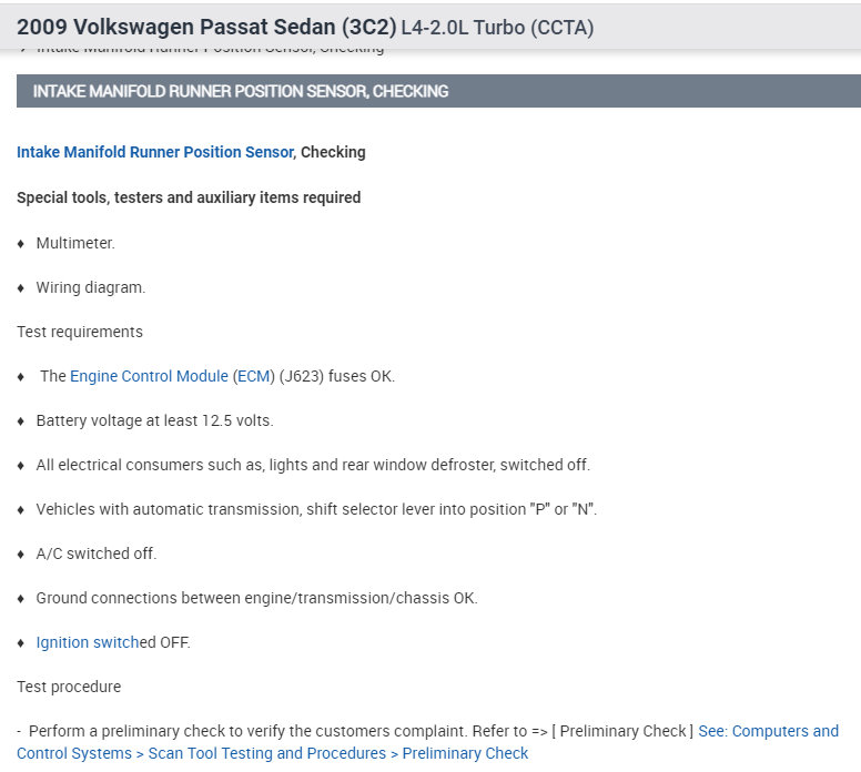

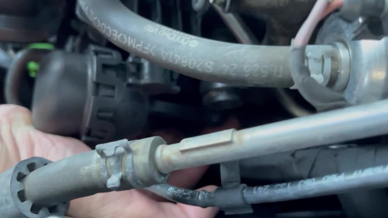

I know this is common on these cars and other makes. I have replaced it on another VW years ago, just wanting to see what you can help with here. Only has one code: p2015. What can be tested to make sure this is an electrical or mechanical issue?
Oct 22, 2021 at 8:10 AM
SQM
  • 6,383 POSTS

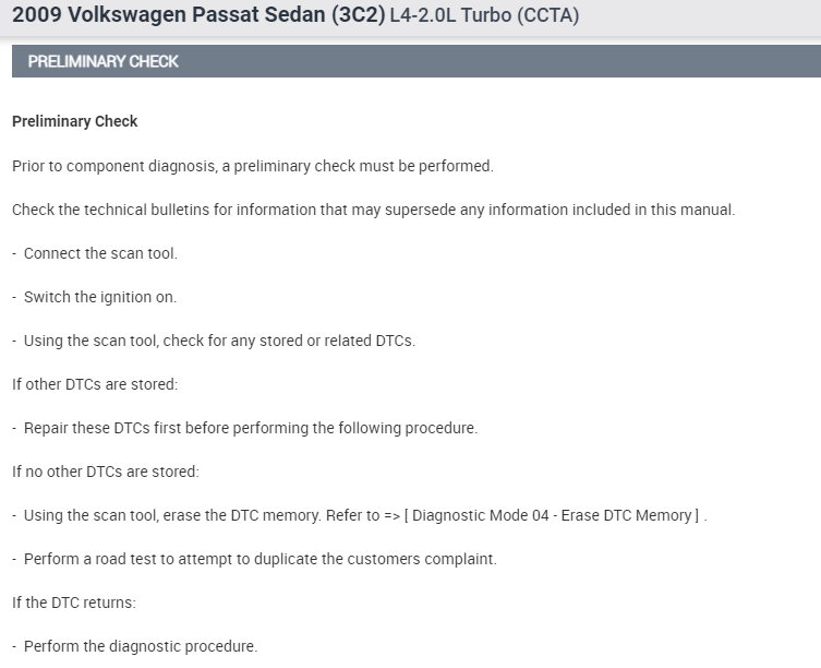

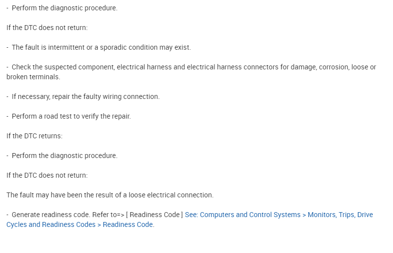

Those runners do have a tendency to go bad.

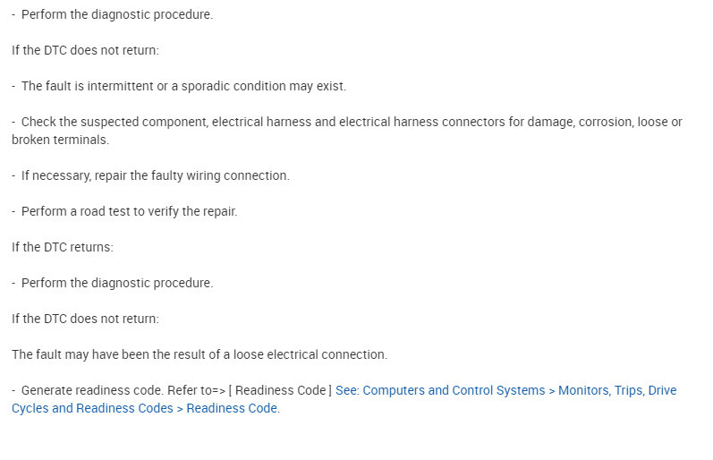

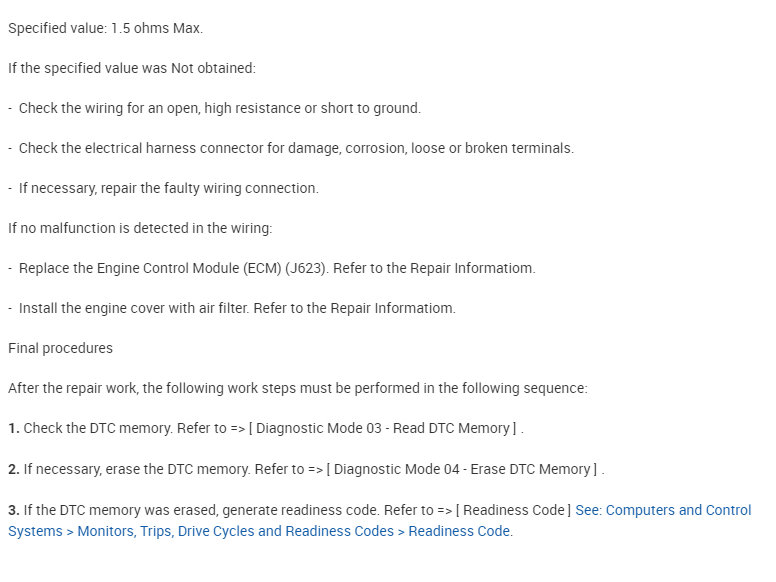

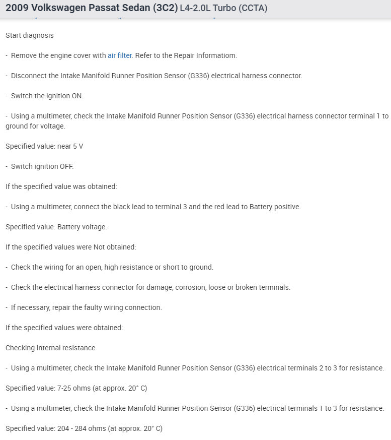

Look below, I have attached the trouble shooting guide for the P2015.
Run down that process it should help you determine the issue.
Let me know of any questions.

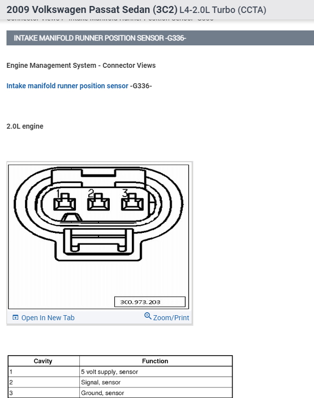

DIVIDES
  • 903 POSTS

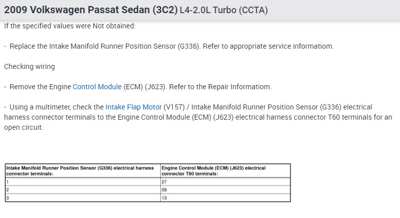

Which is considered terminal 1?
Oct 22, 2021 at 9:22 AM
SQM
  • 6,383 POSTS
Look at the diagram below.
Oct 23, 2021 at 1:27 PM

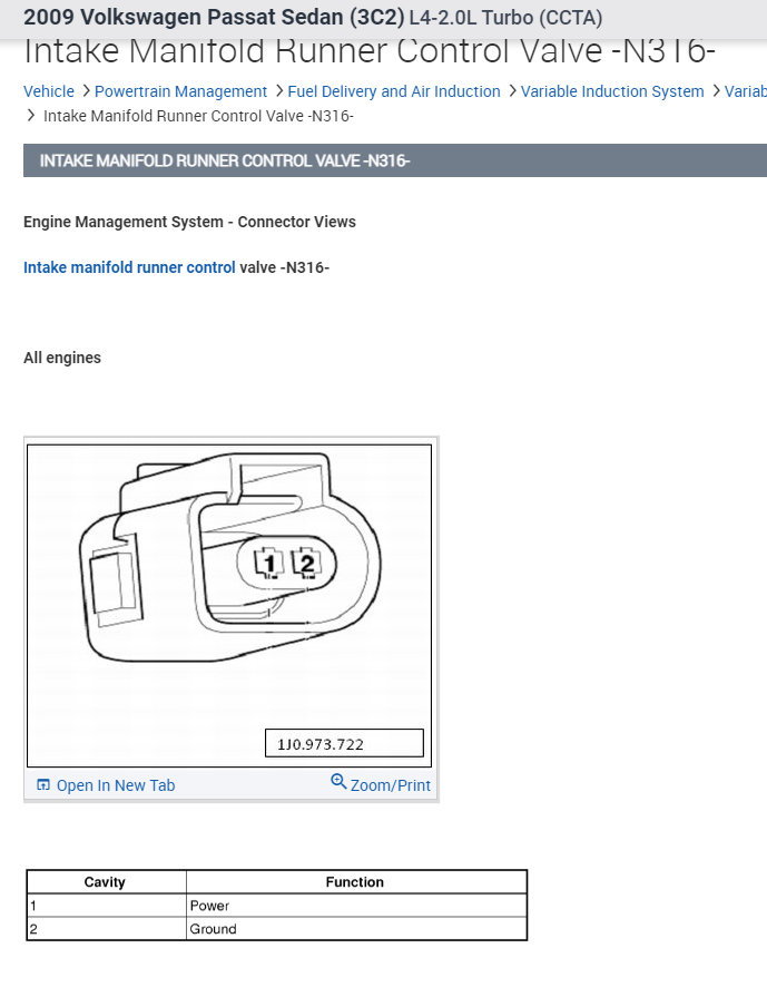

DIVIDES
  • 903 POSTS

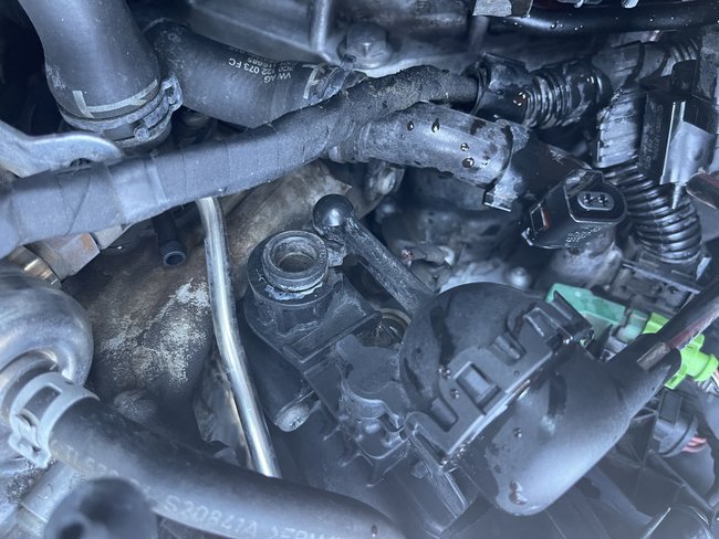

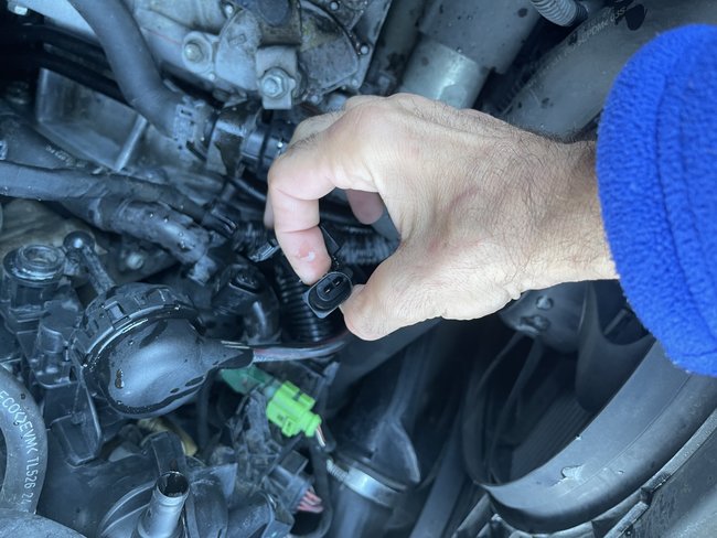

Nothing underneath or by the flap has 3 connectors, only underneath it there is a 2 wire connector.
Oct 26, 2021 at 8:12 AM

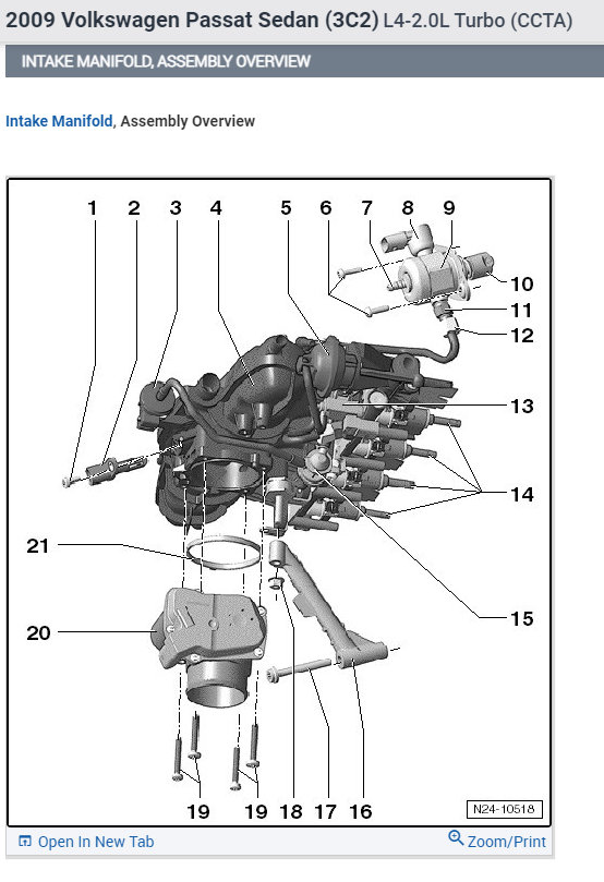

SQM
  • 6,383 POSTS
Look at this diagram below, more like it.
Oct 26, 2021 at 11:52 AM

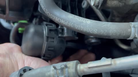

DIVIDES
  • 903 POSTS
Yes, this is the vacuum valve. I think the sensor is on the other end, under the oil filter.
Oct 26, 2021 at 11:58 AM
SQM
  • 6,383 POSTS
Yes. So this is the connector you needed the terminal 1, designation right?
Oct 26, 2021 at 12:06 PM
DIVIDES
  • 903 POSTS

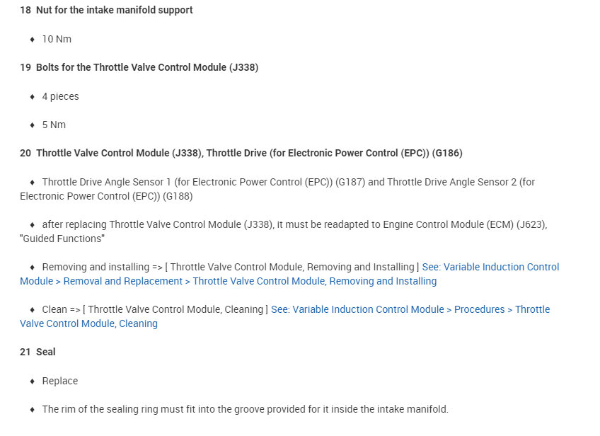

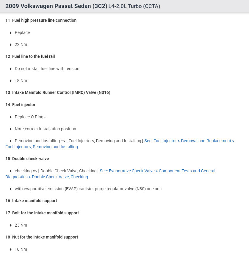

Yes, but based on the looks of the intake online it's on the end, have to remove the intake to disconnect it.
Oct 26, 2021 at 12:12 PM
SQM
  • 6,383 POSTS

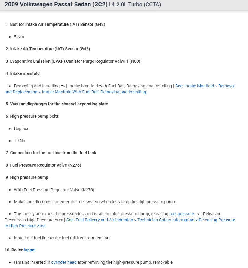

That's right the intake has to be removed.
I have attached the torque specs should you end up removing it.
