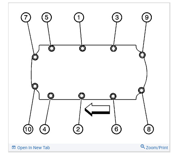

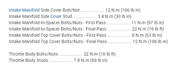

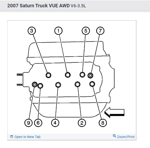

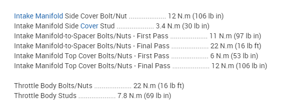

I am looking for the torque specs and tightening sequence for the intake manifold bolts.
Sep 16, 2023 at 7:27 AM
  • 110,236 POSTS
I'm not sure if you need the info for the upper or the lower intake manifold, so I attached both. (see pics below)
Let me know if this helps or if you have questions. Also, note that some of the torque specifications are in inch pounds and not foot-pounds.
Take care and let me know how things turn out.
