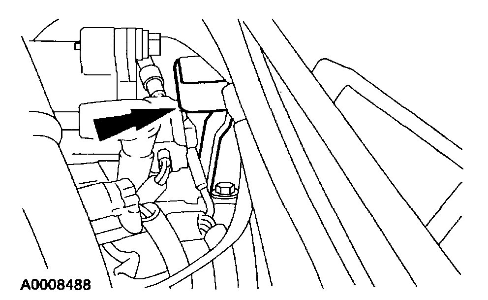

I replaced the upper intake manifold gaskets. And have been searching for a vacuum leak ever since. So now the reason i would like to know where this part is located is i ended up having a black o ring 2 or 3 inches wide left over. I checked to be sure it wasn't from the air intake before the throttle body.
Dec 14, 2020 at 1:24 PM
  • 110,194 POSTS
I believe you are referring to intake manifold tuning valve. It's in the rear of the intake. Here are the directions for removal and replacement. The attached pics correlate with the directions.

REMOVAL
1. Disconnect the battery ground cable.
2. Remove the cowl vent screen.
pic 1

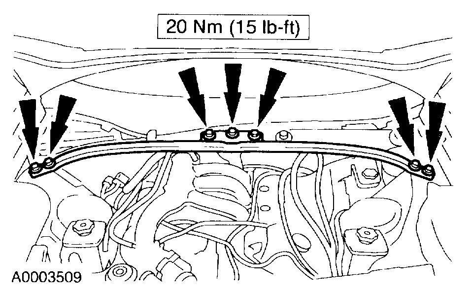

3. Remove the bolts and the cross-vehicle support.
pic 2

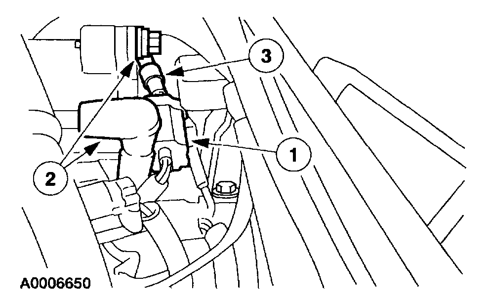

4. Remove the wiring harness bracket.
pic 3
5. Remove the Intake Manifold Tuning (IMT) valve.
1 Disconnect the electrical connector.
2 Remove the two bolts.
3 Remove the IMT valve.

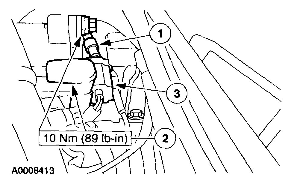

INSTALLATION
pic 4
1. Install the (IMT) valve.
1 Coat the IMT valve with clean engine oil and install into the intake manifold.
2 Install the two bolts.
3 Connect the electrical connector.
CAUTION: The IMT valve must be fully seated in the intake manifold prior to installing the bolts, or damage to the IMT valve may occur.
