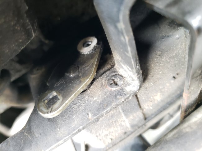

Where exactly am I supposed to connect these pins on the engine? I am going to replace the plastic bushings but I can't find where to place the pins other than where they both connect on the rotating mechanism.

Can you post a picture of what you see on the actuators?

I thought these had already posted, sorry about that.
Jul 9, 2019 at 4:14 AM
No worries.

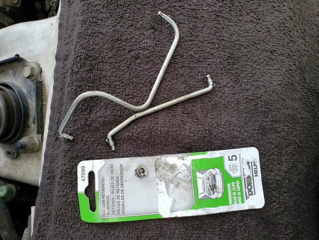

The rods just push through the bushings on the runner itself.
Are the rods missing from the actuator to the runner?
Jul 9, 2019 at 4:23 AM
CL927012
  • 5 POSTS
Yes, the rods were missing but I got replacements which are the ones in the picture. Now I know the rods go connected in the holes on the second photo but after that I can't where the end of both rods are supposed to be connected.

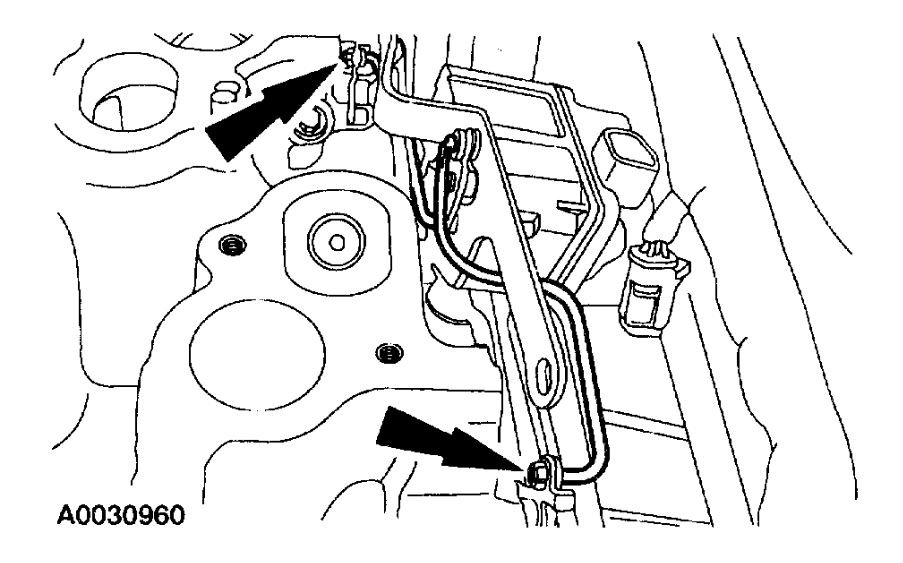

Does this picture help?
Jul 9, 2019 at 4:48 AM
CL927012
  • 5 POSTS
Yes sir. Thanks a lot for the help.
