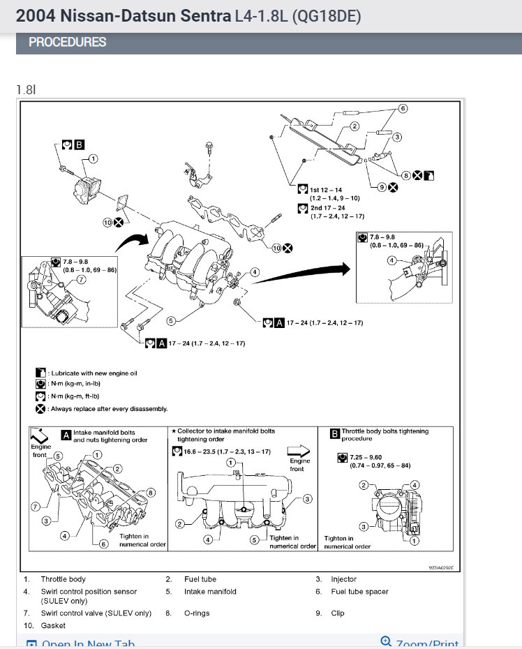

Since some parts that are built into the manifold and it has been discontinued, are there any other aftermarket options or anything from another car that would work? Or could anyone suggest a remanufacturer that actually has one by any chance?

That is a tough one because wrecking yards tend to keep the engine together so they can sell it as a whole. Here is the part number Intake Manifold 140018U310 $483.77 and the instructions on how to replace it in the diagrams below. Check out the diagrams (below). Let us know what happens and please upload pictures or videos of the problem.
