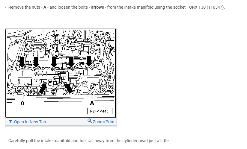

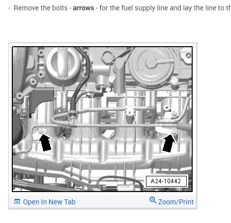

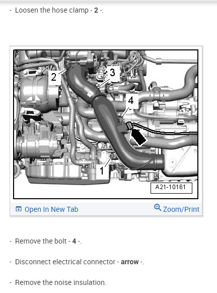

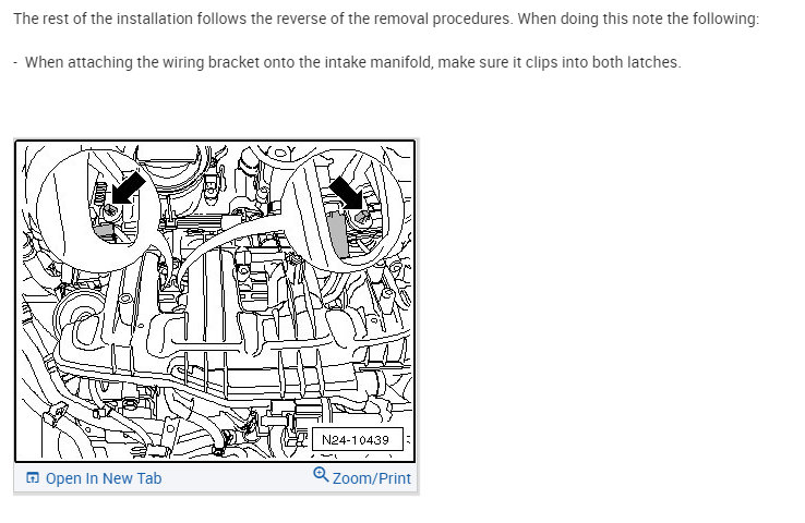

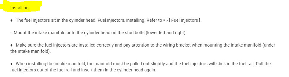

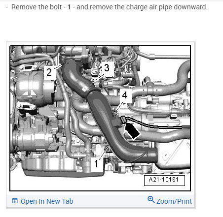

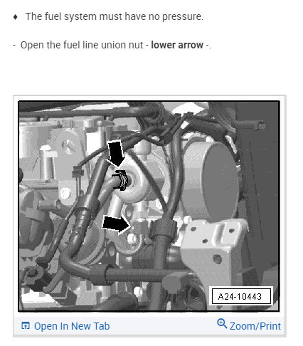

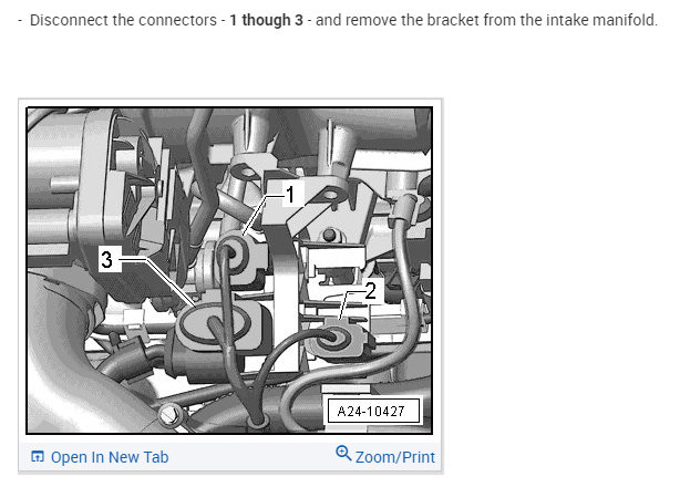

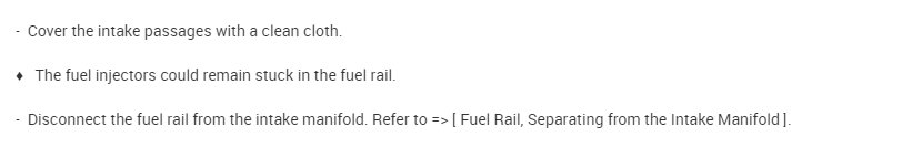

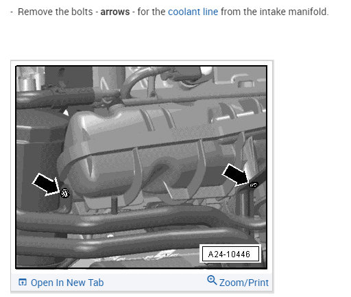

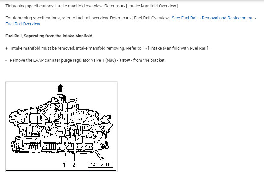

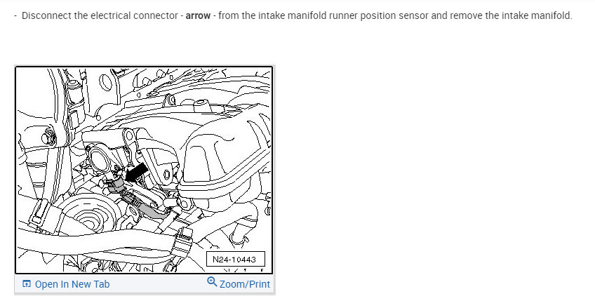

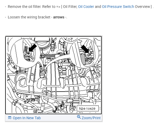

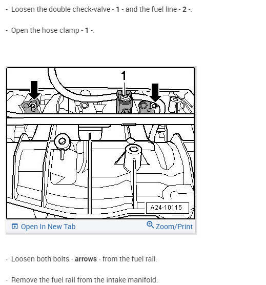

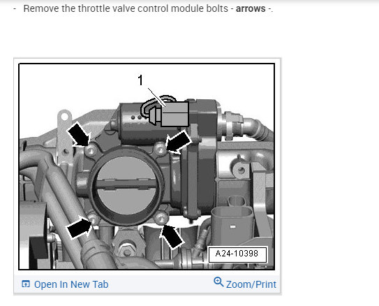

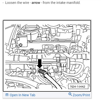

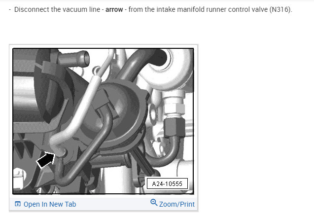

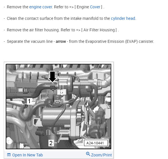

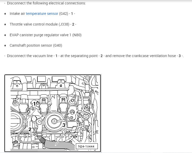

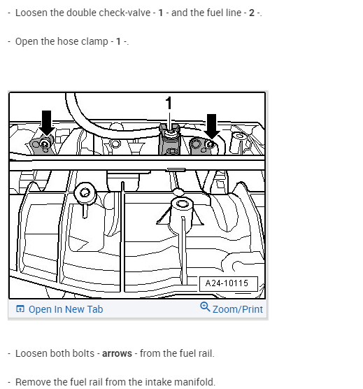

May I please have the instructions to replace an intake manifold on the vehicle listed above?
Aug 21, 2022 at 12:06 AM
  • 110,241 POSTS
I don't know how you keep getting these crazy ones. LOL I wish you were my neighbor. We could work on these together. Actually, I do think I would run if you had this one to work on.

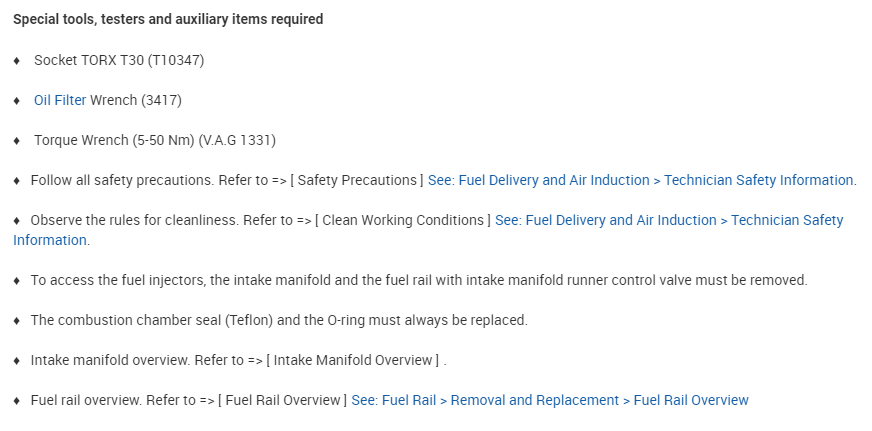

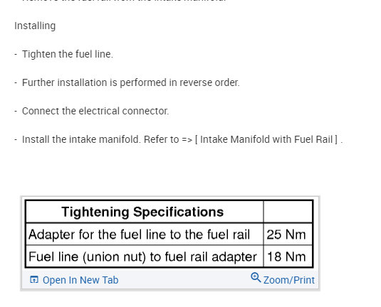

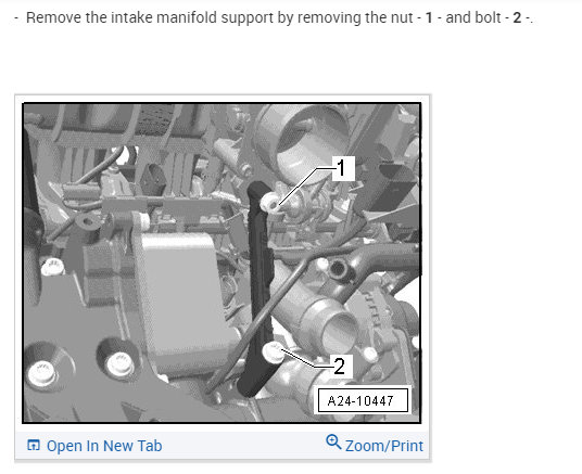

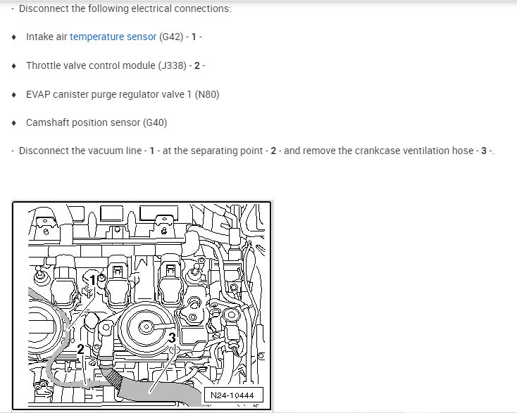

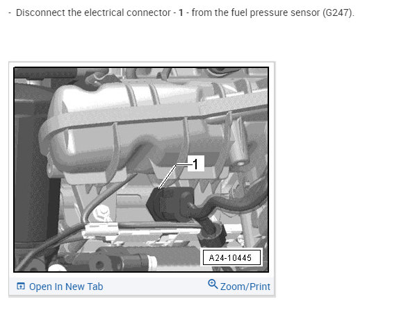

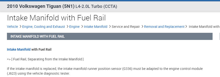

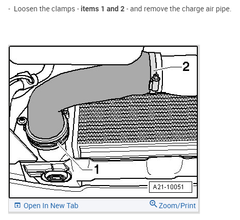

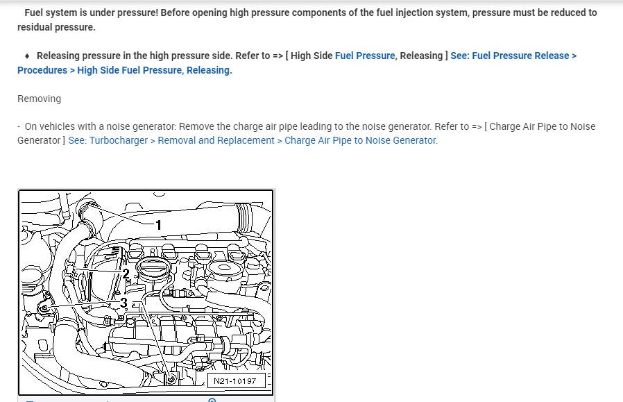

If you are replacing the manifold, you will need to program the runner sensor using a scanner that is designed for VAG.
Okay, the directions are listed below. Please take your time on this one. I have found that anything made by VW, Audi, and Porsche is extremely sensitive.

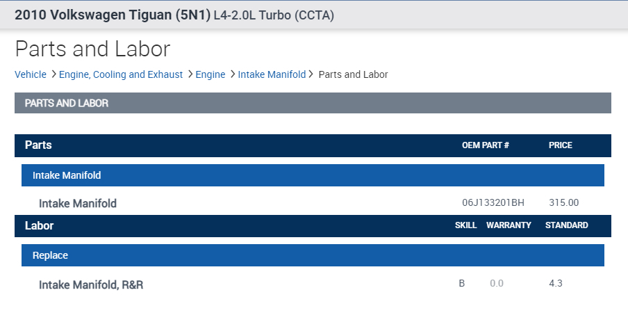

Let me know. Also, the last pic shows a flat rate for the job, which I feel isn't enough time to do it. It calls for 4.3 hours. I would charge for at least 6 hours.
Take care and let me know if I can help. Are you working on vehicles full-time now?
See pics below

And I told them I would only charge $200, so I can’t change it now. I am still learning how to charge obviously, lol.

Also, I did have an autel scanner that i was using, but my friend needed it back so I don’t have a scanner now. Once I finish replacing the intake can I drive it to the dealer and have them do it or can I not drive it at all until it’s reset?
Aug 22, 2022 at 3:31 AM
  • 110,241 POSTS
Ariana,
It should run but it won't be pretty. LOL You should be able to get it to a dealer. You are doing this for way too cheap. Ugh!!! Labor should be at least $500.00.
I'm here, so when the next one comes to you, let me know what is being done and I'll let you know the flat rate time for the job. You're too good to cheat yourself. Plus, you're in CA. I can imagine anyone there would charge less than $100.00 an hour. I know the average labor rate in CA is near $150.00.

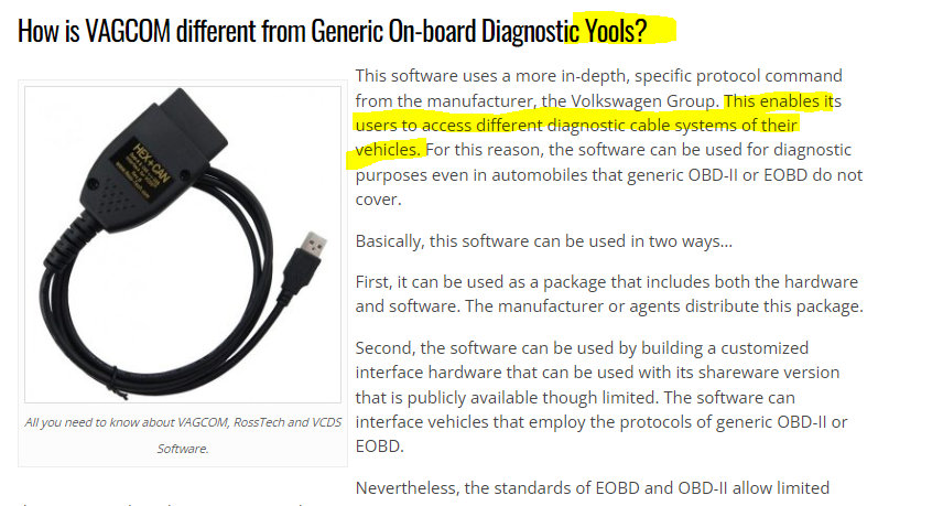

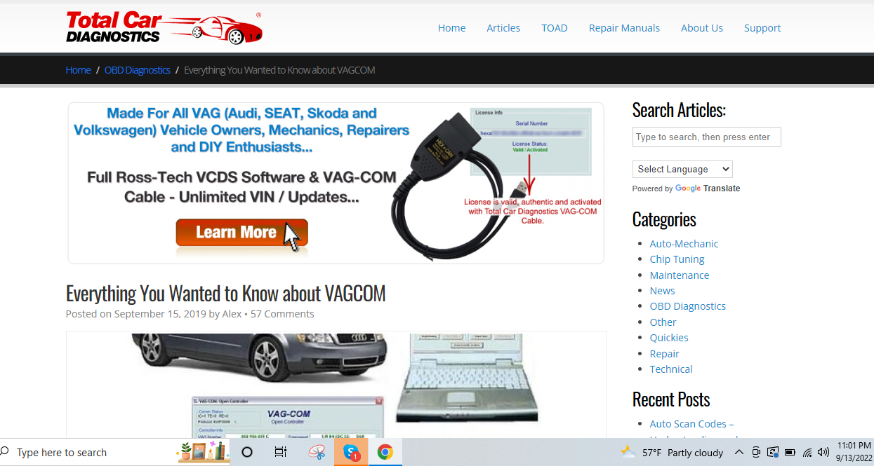

Is there any way around having to use the VW software to clear it? The dealer wants almost $200.00 to do it. I tried with an Autel Maxi IM 508 but it didn’t work. I changed the intake and the purge solenoid. Light just won’t go away
Sep 13, 2022 at 9:53 AM
  • 110,241 POSTS
Ariana,
Nice to hear from you. The idea that it is a VW limits you to what can be done with a general scan tool. You either need to get your hands on a scanner specific to VAG (VW Audi Group) or the VAG Com program for a computer. They aren't cheap and they constantly require updating. Also, they require different connector cables for different models/issues. See pic 1 below. Also, they misspelled tool. Instead, it reads Yool. LOL
Check out the place in pic 2. It explains it in more detail.
I wish I had a better answer. Does the vehicle seem to be running better?
