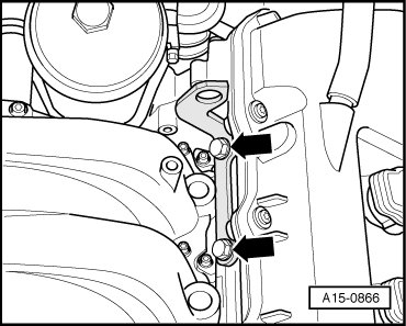

I went to replace the whole intake manifold on my car with a salvaged one that was tested to be solid. It came with a new fuel rail and injectors so I figured I’d just use those instead of the current ones on the vehicle (even tho the current ones on the car had no issues) I figured use the ones I just got because they have less miles. So I remove the old gasket, used fuel resistant gasket maker to reseal, reconnected injector connectors and fuel line to fuel rails. I let the gasket maker set for a day came back tried to start the car and it wouldn’t start. Not even a bit. It would crank until the battery died but no start. I swapped out the old injectors thinking well maybe the injectors were bad, still no start. I take the intake back off and the gasket maker was still wet and had dripped into the intake ports where the valves were. I cleaned it all out as best I could, tried to start it again and again crank but no start. Mind you the car had no issue but an intake leak before hand and I’m not sure what to do at this point. Please help. Could the fuel rails have air in them? Is it because the gasket maker didn’t seal the intake? I’m not sure what to do so if I could get some guidance it would be a big help.

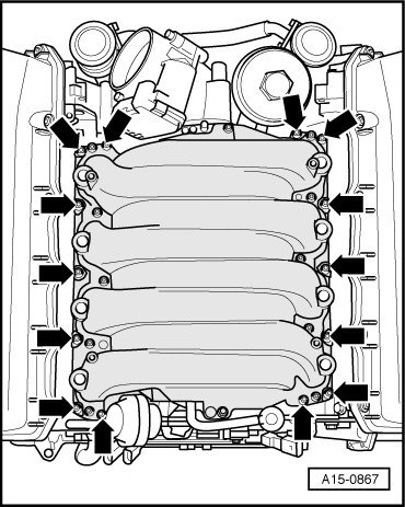

First, if you only used gasket maker, take it apart, clean the gasket maker off, and install the correct gaskets.
I have sent the directions three times and it won't send. I am going to try this on two different replies. This will include the specific directions for replacement. The next will be the pictures.
Make sure the guide pins aren't holding the manifold up from properly attaching.

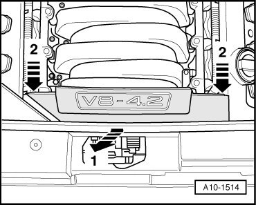

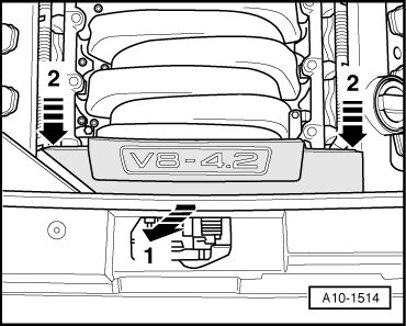

INTAKE MANIFOLD
Intake Manifold
Removing
All cable ties opened or cut during engine removal must be reinstalled at the same locations during installation.

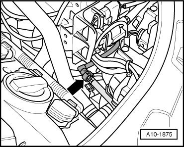

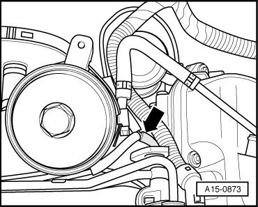

- Bring lock carrier into service position. Refer to => [ Lock Carrier, Moving into Service Position ] See: Engine > Removal and Replacement > Lock Carrier, Moving Into Service Position.

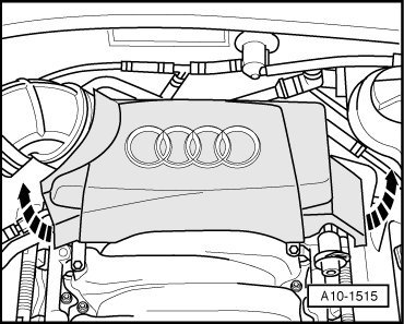

- Remove rear engine cover - arrows -.
- Remove front engine cover - arrows 1 and 2 -.

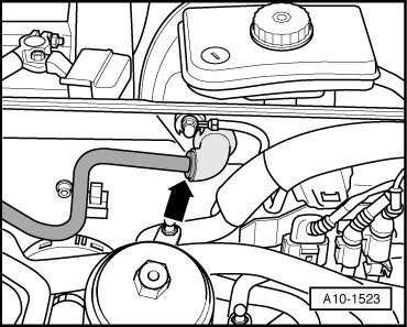

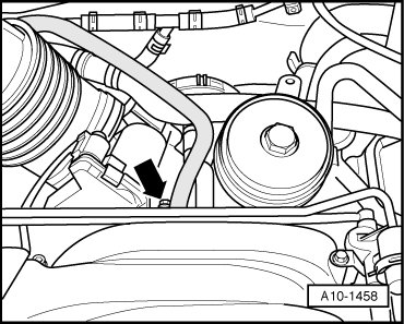

- Disconnect vacuum line - arrow - to brake booster at bulkhead.
- If installed, disconnect vacuum line - arrow - to vacuum reservoir.
- Disconnect vacuum hose - arrow - from intake manifold.

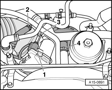

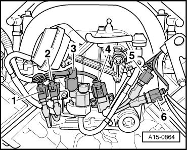

- Disconnect electrical connection - 1 - at throttle valve control module (J338).
- Disconnect vacuum hose - 2 -.
- Remove air guide hose - 3 -.
- Disconnect crankcase ventilation hose - 4 - at intake pipe.
- If installed, disconnect vacuum line at area designated with - arrow -.
- Remove electrical harness connectors - 1 to 4 - toward front from brackets on intake pipe.
The electrical connections must not be separated.
- Disconnect vacuum hose - arrow - at T-piece.
- Disconnect connector strips - 1 - and - 5 - at fuel injectors.

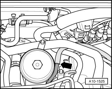

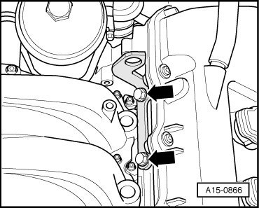

- For vehicles with fuel return line, disconnect vacuum line - 4 - on fuel pressure regulator.
- Remove retaining bolts - 2 - and - 3 - for fuel rail pipe.
- Remove fuel distributor together with fuel injectors from intake manifold simultaneously upward and place it on a clean rag in engine compartment.
Carefully protect the removed fuel injectors from contamination.
- Remove left rear engine lifting eye - arrows -.

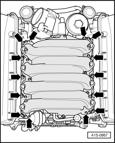

- Remove intake manifold bolts - arrows - and remove it.
Plug the intake ports of the cylinder head with clean rags.
Installing
Installation is in reverse order of removal, note the following:
Replace gaskets and O-rings.
Secure all hose connections using hose clamps appropriate for the model type.
During installation, all cable ties must be re-installed at the same location.

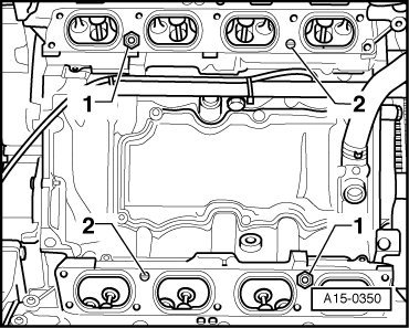

- Replace intake manifold gaskets, thereby removing the locking bolt - 1 -.
- Be aware of the alignment pins - 2 - when setting the intake manifold in place.
- Fasten intake manifold bolts in a diagonal sequence and in steps - arrows -.

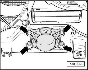

- Place torque support on rubber buffer for torque support and tighten bolts - arrows -.

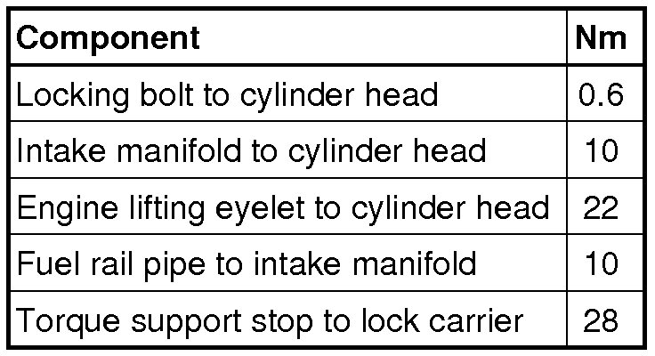

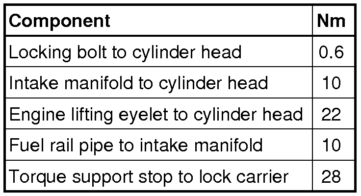

Tightening Specifications
Let me know if this helps.
+1
Tuesday, December 18th, 2018 AT 8:35 PM
  • 109,885 POSTS
Okay, I think this may work. One other thought, make sure to properly torque everything. The last picture shows torque specs.

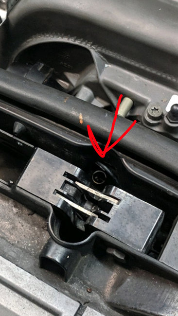

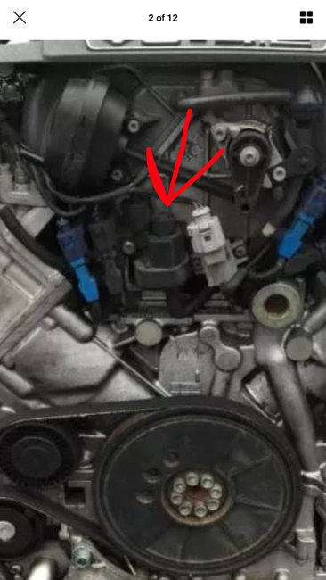

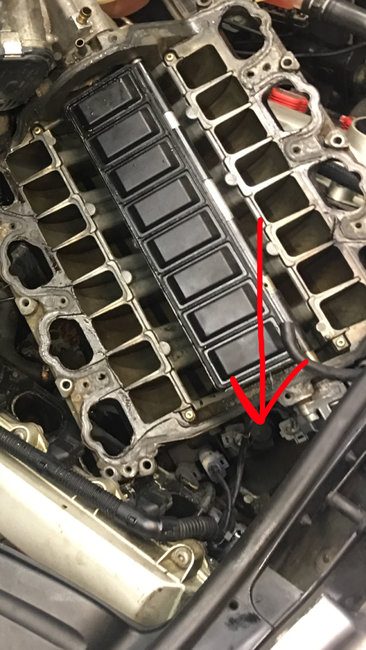

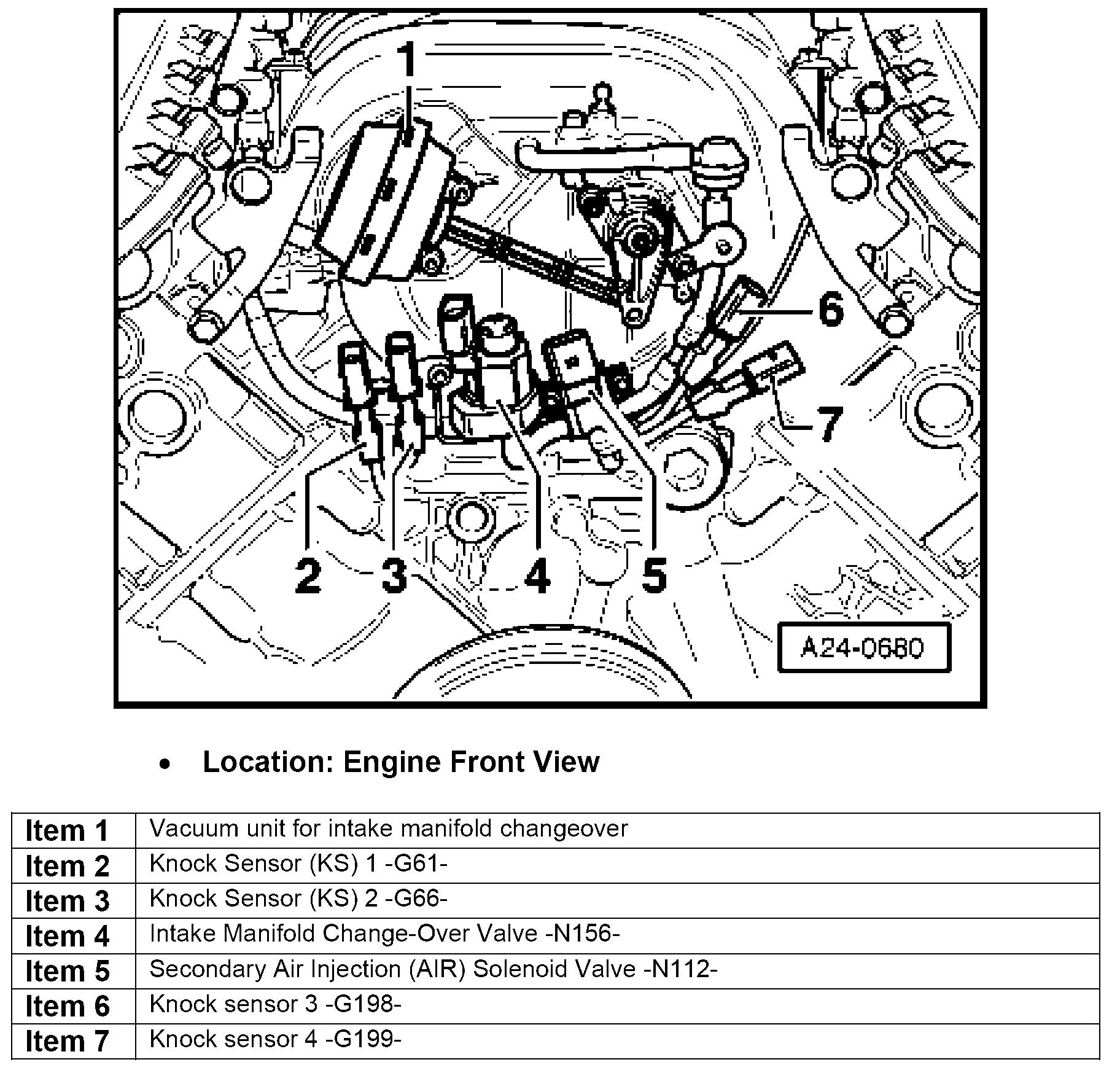

Would you happen to know what this is? It seems a tube of some sort and it’s now missing the cap or plug and I have no clue what it’s called or if it would have anything to do with my no start issue.
-1
Wednesday, December 19th, 2018 AT 7:56 PM
  • 109,885 POSTS
Welcome back:
I believe what you are pointing to is the intake manifold changeover valve. Yes, that can cause running issues, but it should still run.
Take a look at the picture I attached and see if that is the component you have in your pictures. It's number 4 in my picture. Also, let me know if it is electric or vacuum on your vehicle.
Wednesday, December 19th, 2018 AT 8:35 PM
