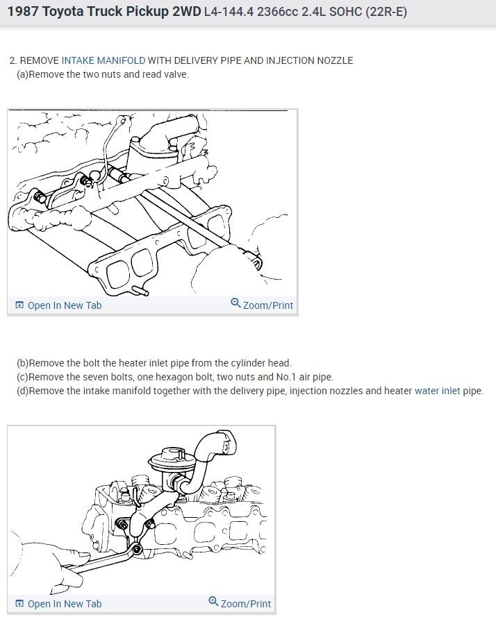

Intake manifold, how hard is it to remove and install the gasket and bolts?
1987 TOYOTA PICKUP
155,500 MILES • 2.4L • 4 CYL • 4WD • MANUAL
SFCTRIPLETT57
  • 184 POSTS
removal and installation Removal.
Sep 12, 2021 at 6:32 AM
MASTER ASE TECH
  • 82 POSTS
Hi, I'm Dan. Looking in AllData it looks to be pretty straight forward. I've attached the procedure below, it just states to remove the bolts. The job pays 3.6 book hours.
