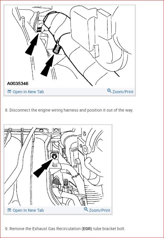

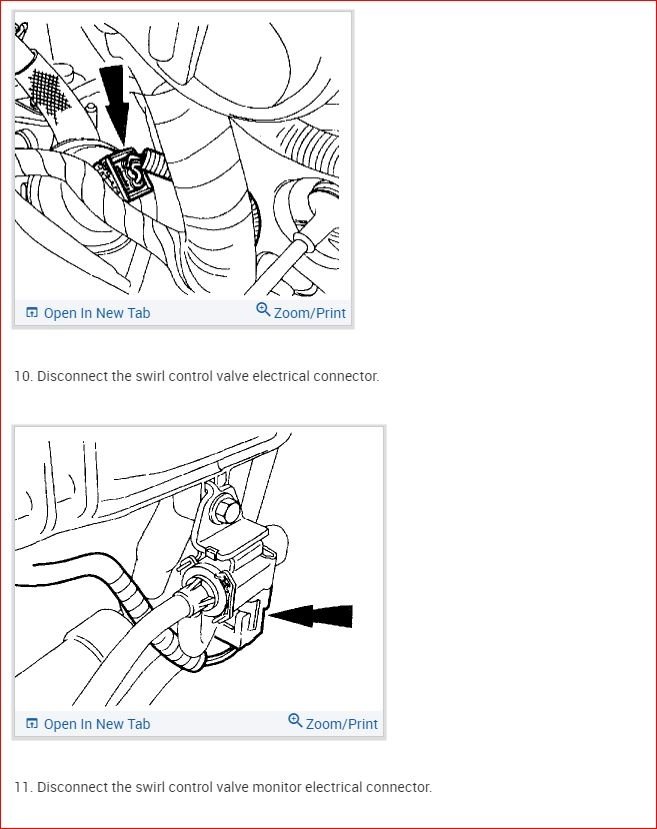

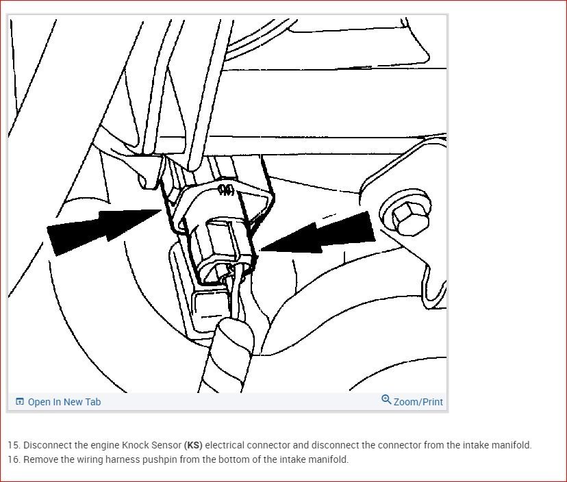

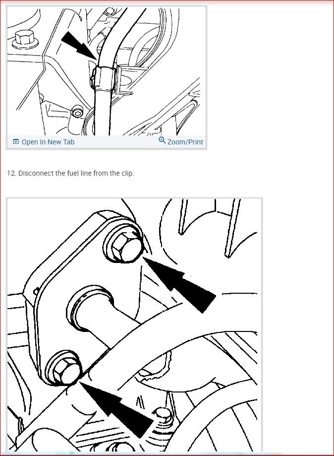

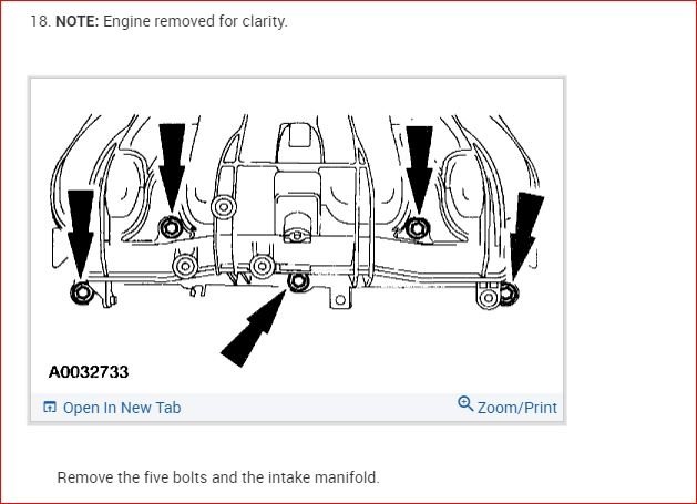

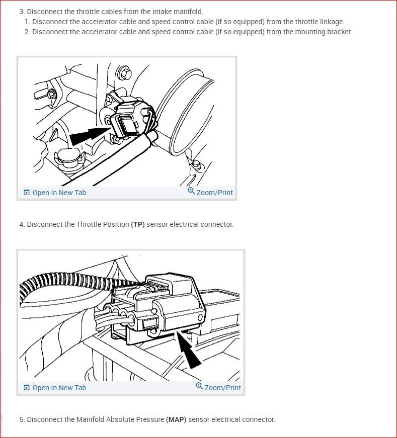

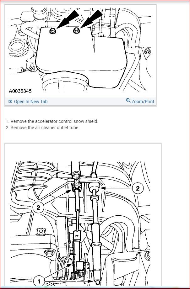

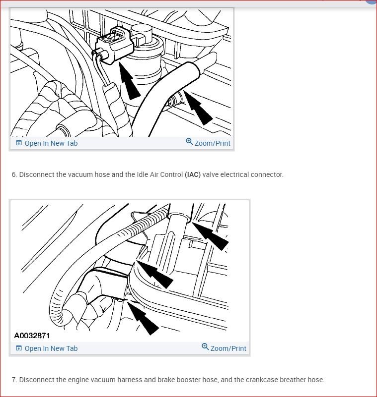

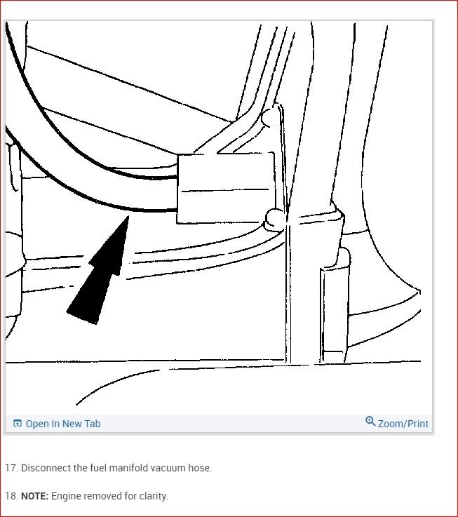

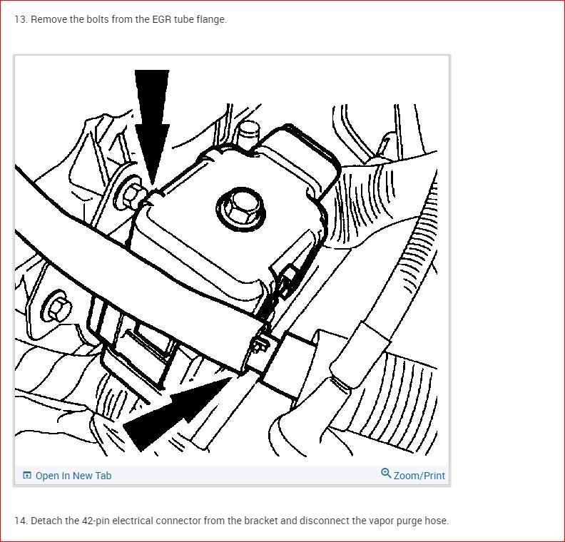

This hose goes into intake manifold on the back of the engine. Where does this hose go?
May 14, 2019 at 9:10 PM
Hi Robert,
I included the procedure for removing the manifold so if that line is going into the manifold then it is in here. You can run through the procedure just identifying the components as if you are removing it and you should be able to figure it out.
If you cannot, you can take a picture of it and I will see if I can identify which line it is.
Thanks
