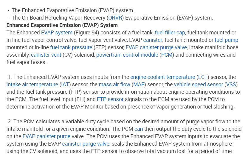

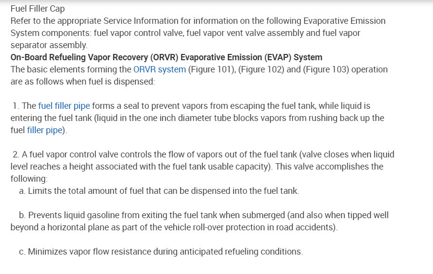

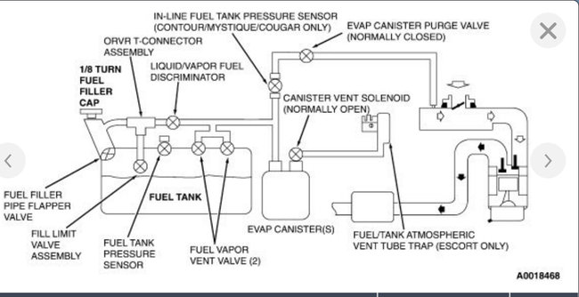

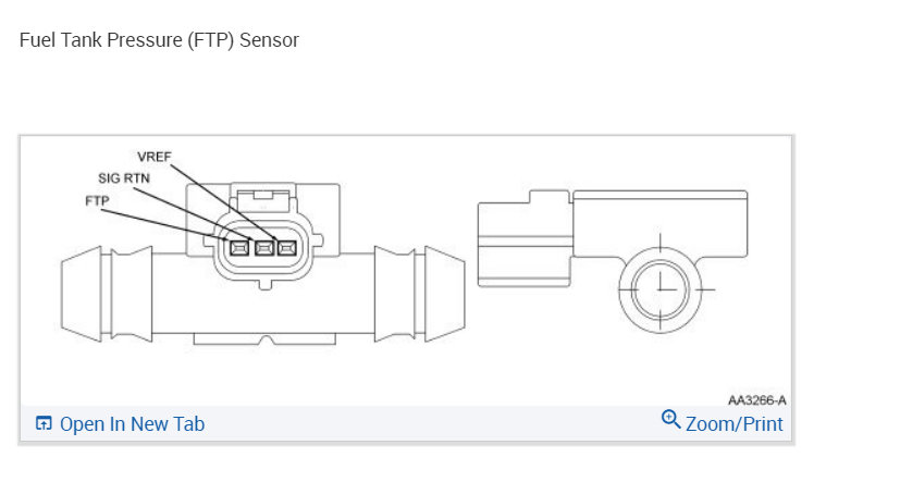

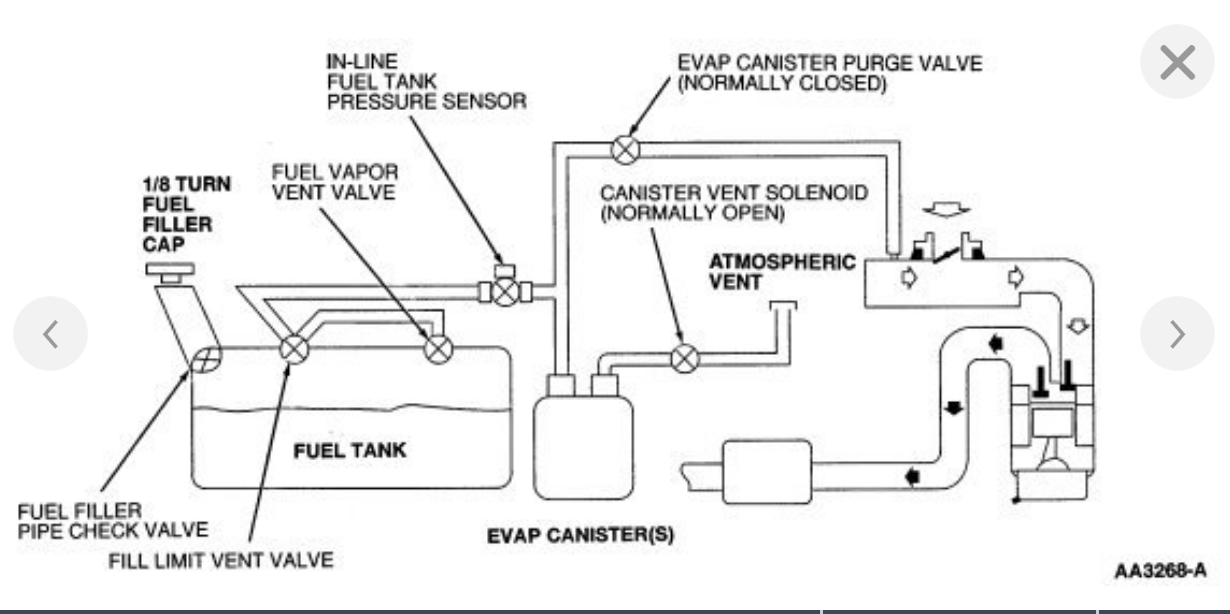

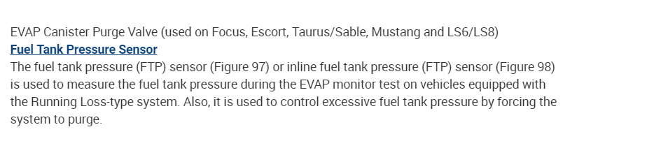

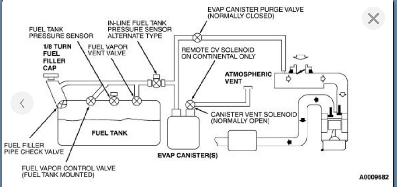

This hose goes into intake manifold on the back of the engine. Where does this hose go?

Not heater hoses. This hose goes into the back of the intake manifold and then down the back side of the engine. Appears to be a vacuum.

Hello again,

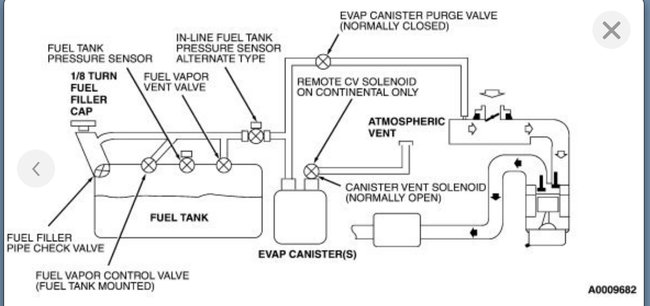

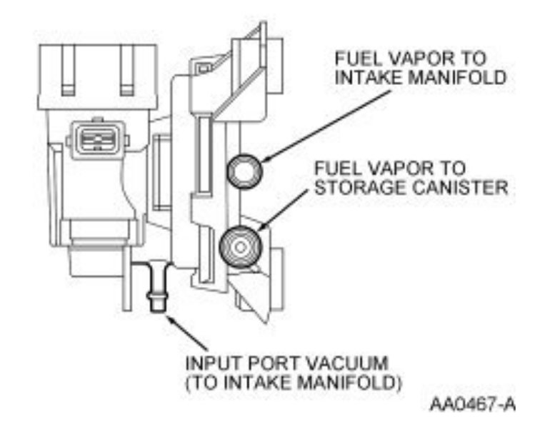

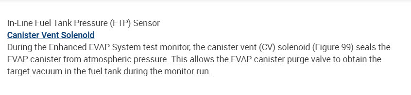

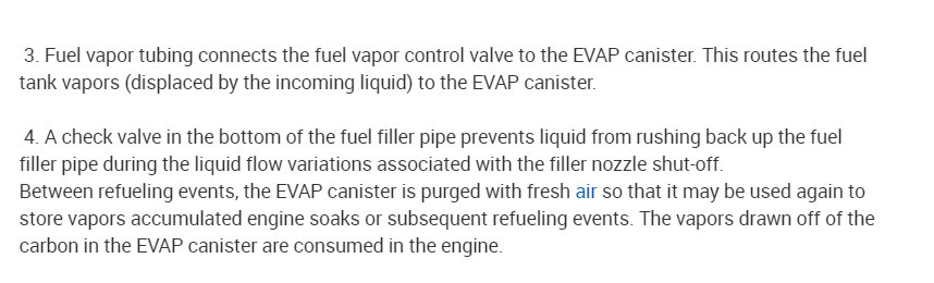

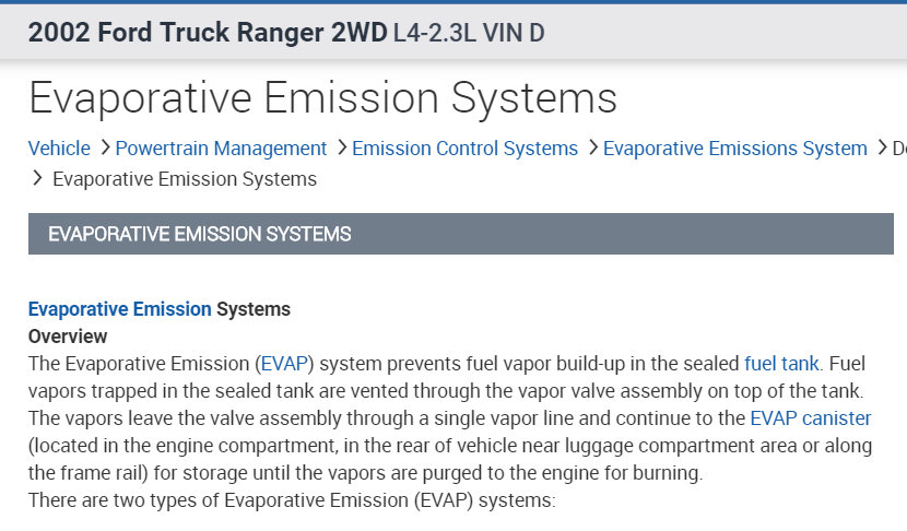

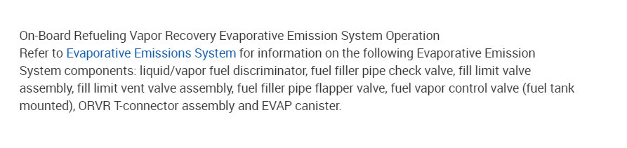

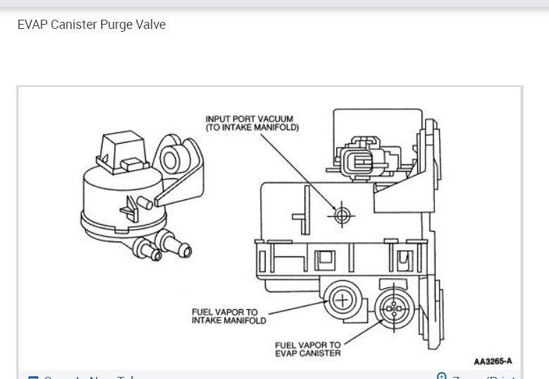

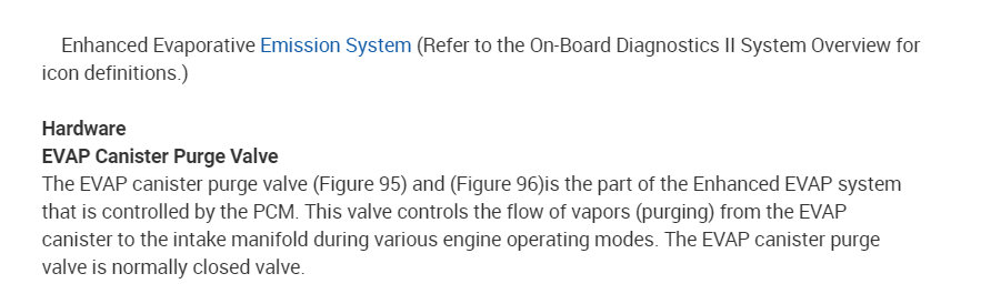

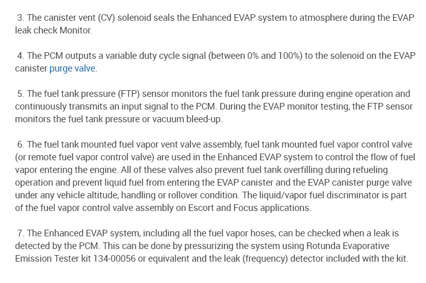

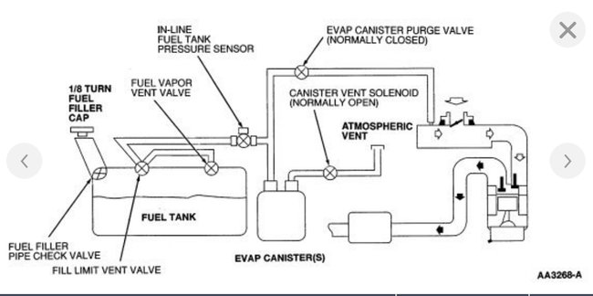

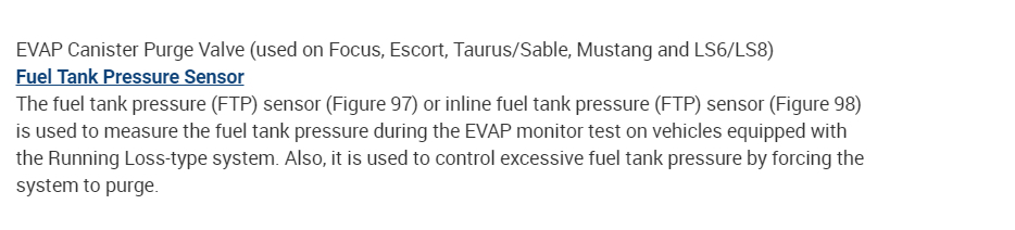

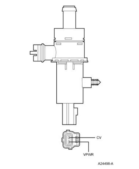

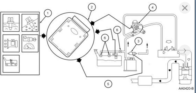

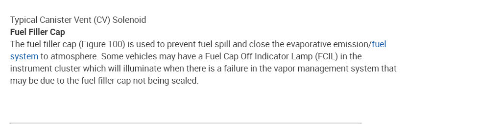

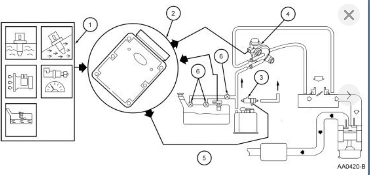

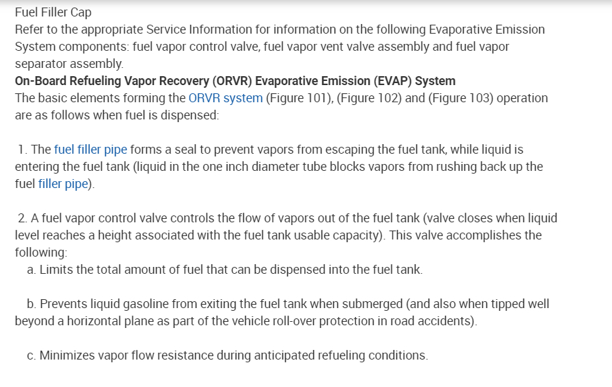

Okay, my bad. without seeing it sometimes it can be hard to get it on the first try. This is going to be your EVAP line coming your vehicle's charcoal canister. This is the final step in your vehicle's evaporative emission system that catches fumes from the fuel tank and stores them in a charcoal canister until your vehicle's Power-train Control Module (PCM) decides to purge them, then is opens a valve and they get introduced through the hose in question into the intake manifold where it is burned in the engine. I have included a factory description of how your vehicle's EVAP system works in the diagrams down below.
Thanks,
Alex
2CarPros
May 14, 2019 at 8:47 PM
ROBERT BOOP
Thanks. I've got it from here. All the diagrams I found, show it on the manifold but failed to identify it or show the hose that connects to it. Now to identify a part number and I'll have the issue solved. Thanks again.

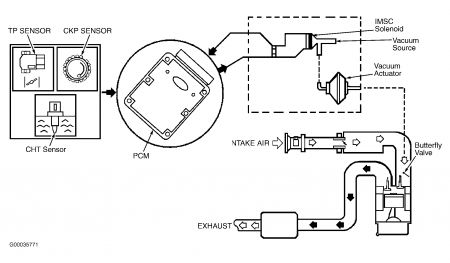

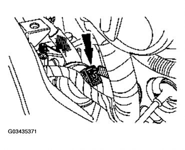

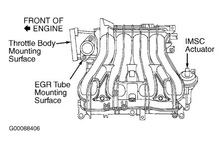

the check engine light is on. the code reads p1537. (IMRC) intake manifold runner control. engine is 2.3L. it says possible causes are vacuum leak, but I did not find one. also flap could be stuck open but they seem to be free. it also mentions something about a swirl control valve. what is it and where is it located? could carbon be the problem? what all should I check or what should I replace? I will appreciate any help. It has been very confusing and frustrating.

Hi 1537 means ICRM is not closing in required time most likely faulty actuator. see diagrams
https://images.2carpros.com/forum/automotive_pictures/198357_Graphic_581.jpg
swirl valve
https://images.2carpros.com/forum/automotive_pictures/198357_Grafic_3_143.jpg
https://images.2carpros.com/forum/automotive_pictures/198357_Grafic_4_34.jpg
Check butterfly operation for binding Hope this helps Thanks for donate
