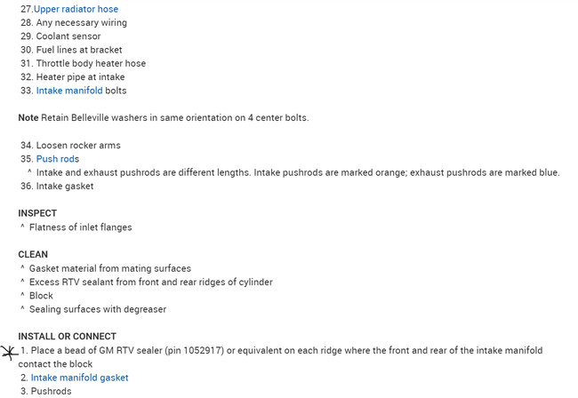

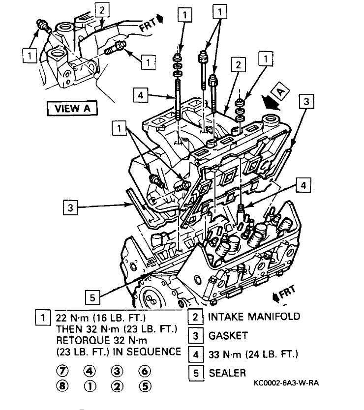

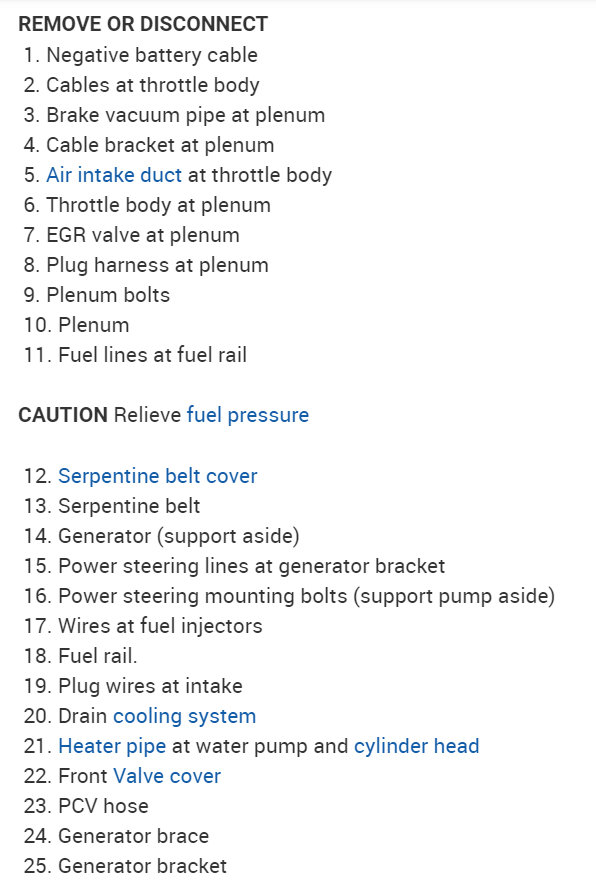

Do you really need to put rtv on the intake manifold gaskets when replacing them? I need a professional opinion. Someone told me it isn’t required because usually when you put rtv on intake manifold gaskets it will start to leak again and over time the rtv will not seal properly because gasoline decays on them over time. I know using rtv is good for cooling heat dissipation but if it’s needed where do I apply the rtv at? On the manifold or on the gaskets top and bottom?
Feb 17, 2019 at 2:11 PM
SCGRANTURISMO
  • 4,897 POSTS

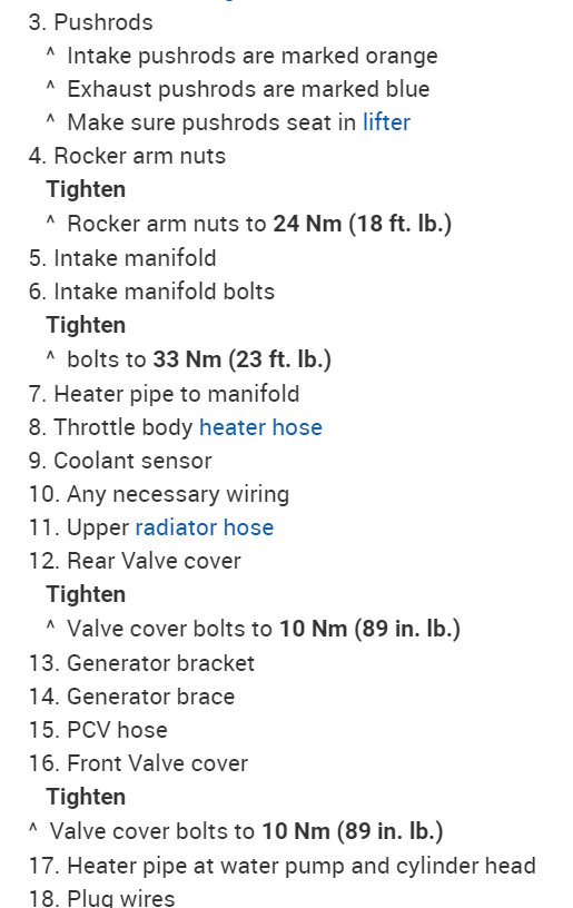

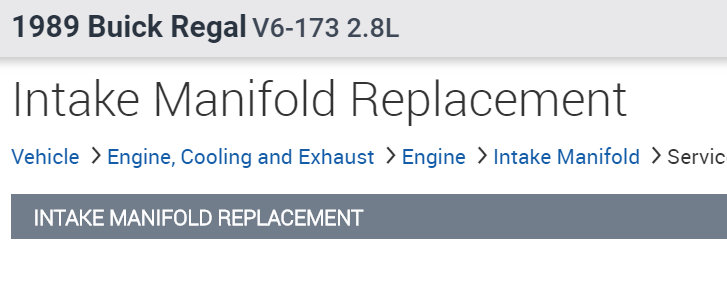

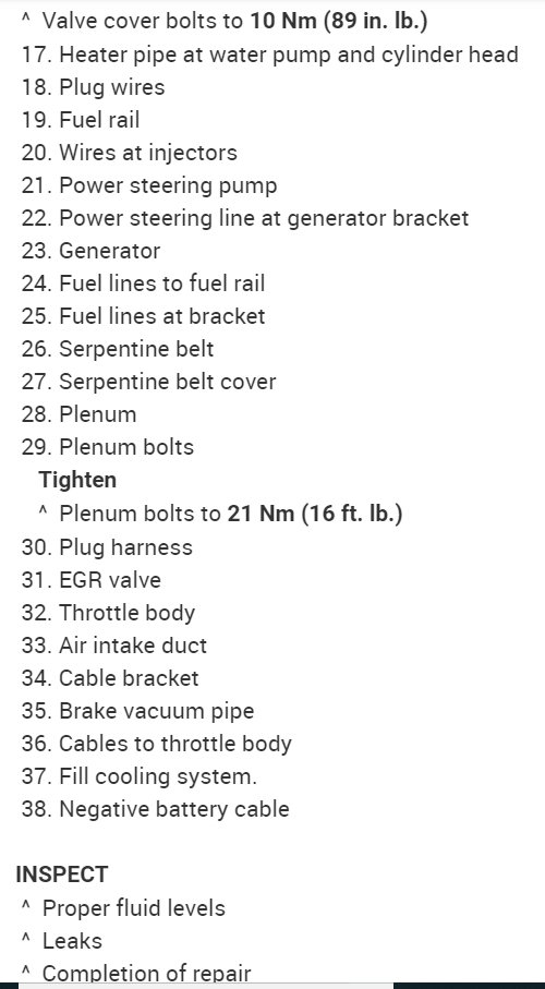

If your vehicle has dowels to hold the gasket in place, then by all means use those. If I were going to rtv on my intake manifold gasket, I would just use a small drop on each corner to "tack" it in place. An excellent quality rtv is made by permatex. It is called The Right Stuff and can be found at any parts house. I have included in the diagrams below the proper procedure for removal/assembly of your vehicles intake manifold. This should give you a definitive answer to your question.
Thanks,
Alex

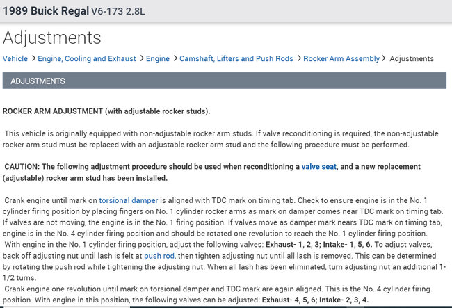

One more question. When I remove the valves and the push rods, if I put them back in the same location all I have to do is just torque them down to specs correct? The valves don’t have to be adjusted a certain position and when they seat on the rocker arm dimples it should be good to go? I don’t want to have engine knock. So I am guessing the valves in this engine don’t have to be adjusted just torque to specs seat on the push rods?

Here are the instructions for your valve adjustments.

I think this is only if you are sending the valves out to get refurbished correct? I am just removing the valves and putting them back in their same position as I take them off. All should be required is to just torque them and that’s it..

Hello again,
I believe you are correct.
