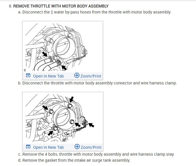

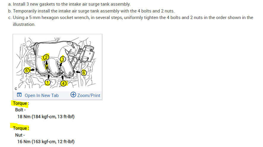

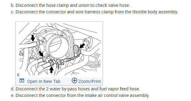

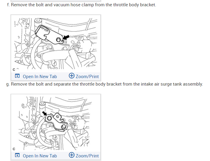

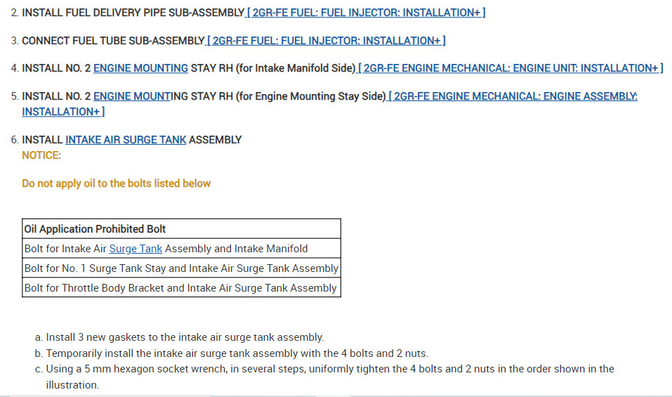

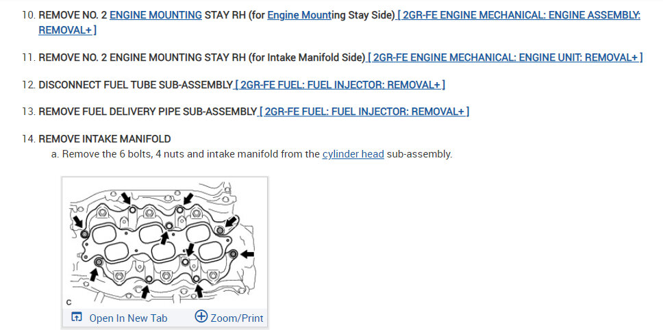

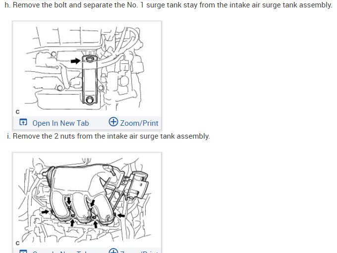

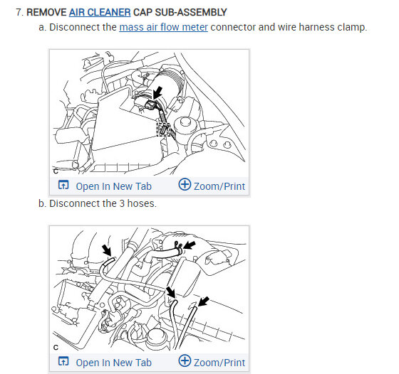

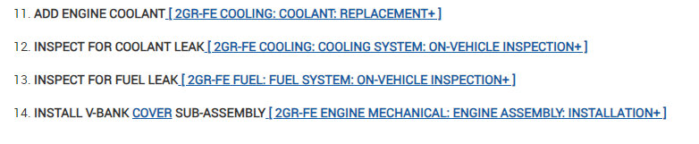

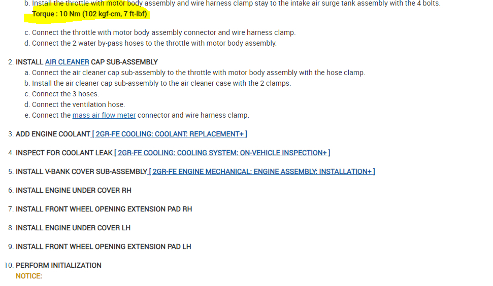

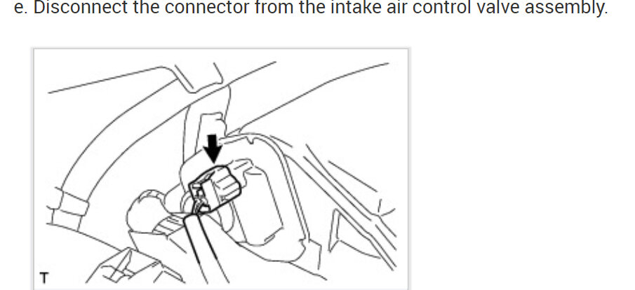

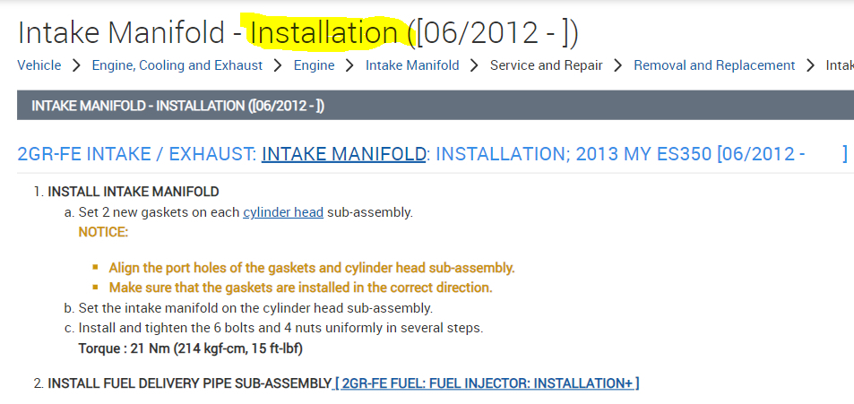

Intake manifold gasket and throttle body torque specs needed?
100,000 MILES • 3.5L • 6 CYL • 2WD • AUTOMATIC
TE6

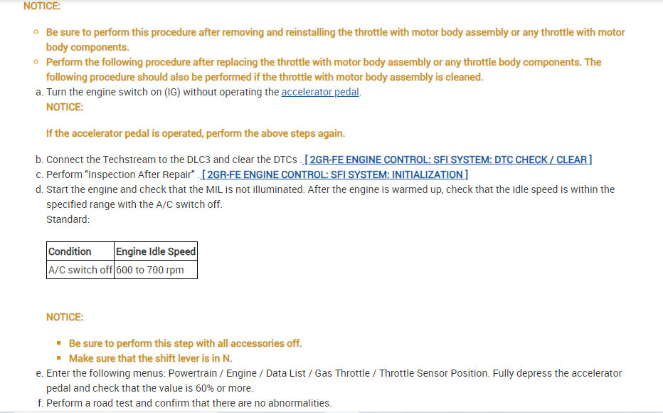

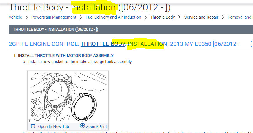

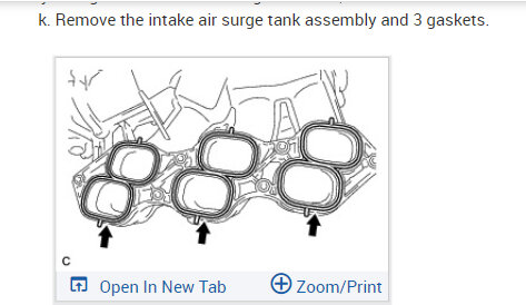

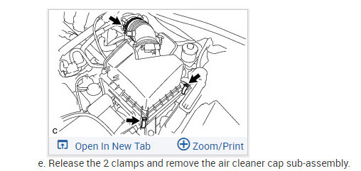

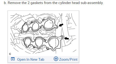

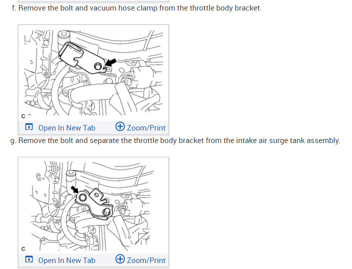

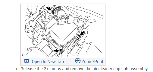

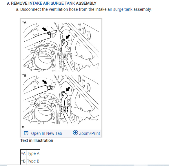

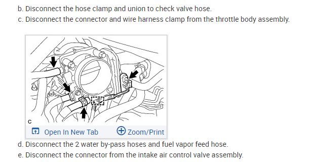

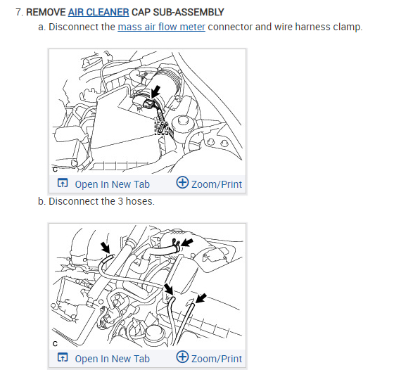

Bolt tightening pattern and bolt torque specs for intake manifold and throttle body torque specs removal and replace guide.
Nov 24, 2023 at 10:02 AM
  • 110,248 POSTS
It sounds like you have your hands full. As far as procedures are concerned, I attached them below. The first section is for the removal of the intake. Then you will notice where I highlighted different pics. Those are different steps and torque specifications.
