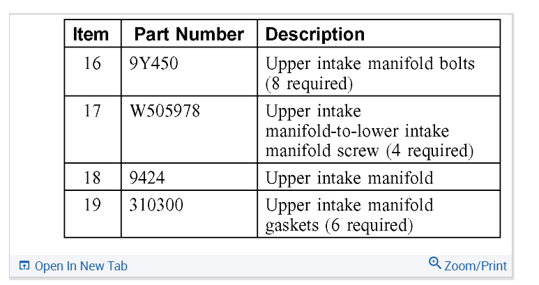

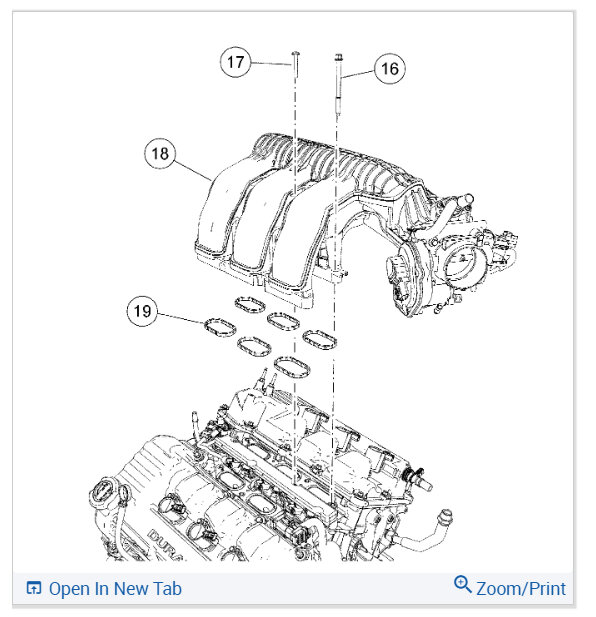

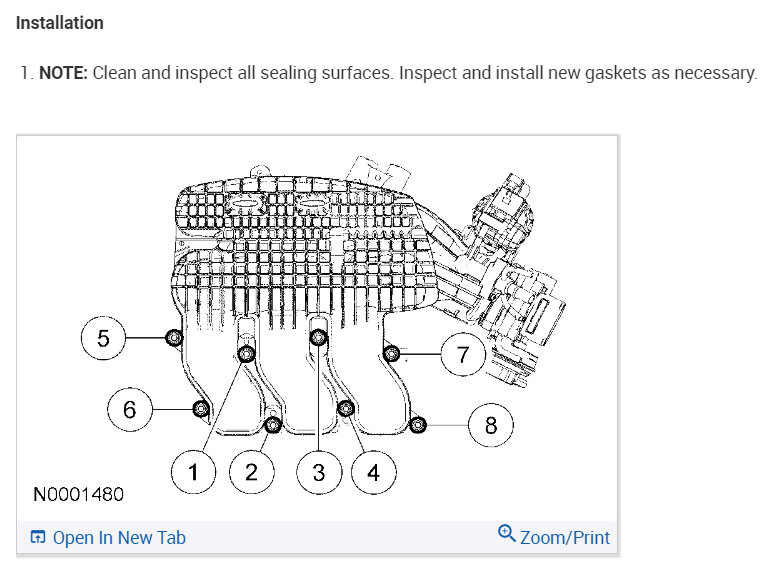

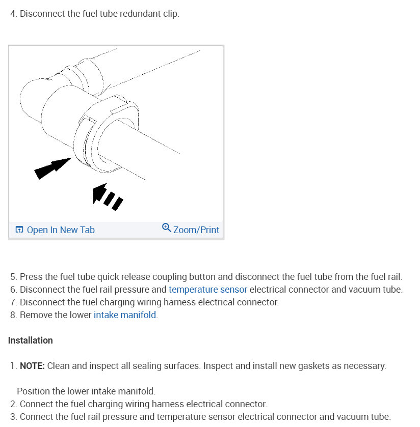

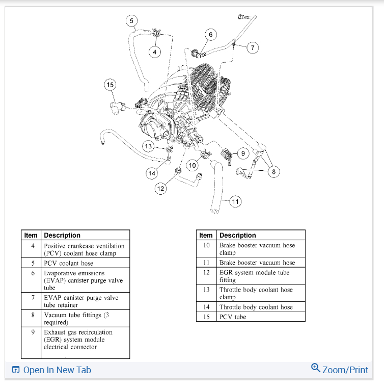

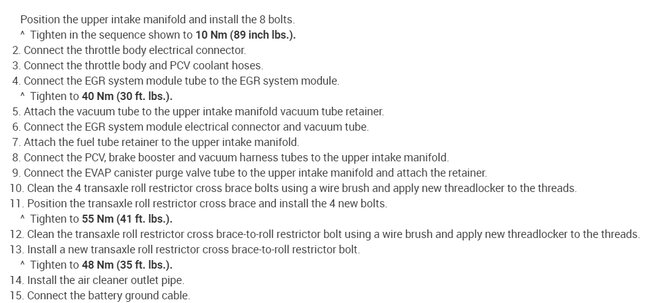

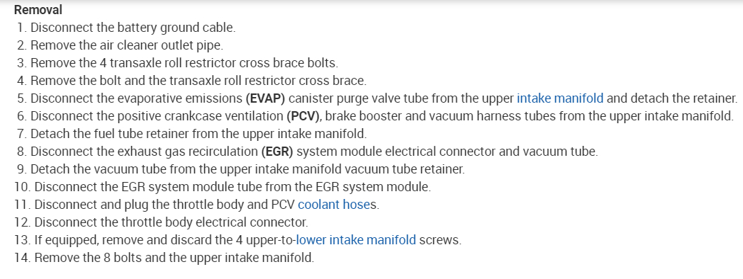

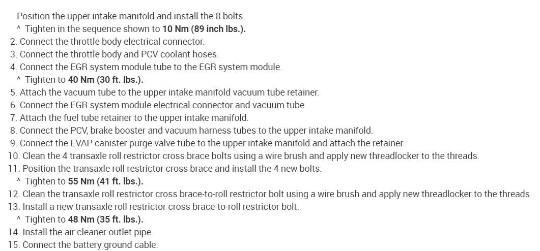

I'm looking for intake manifold bolts, but currently I'm only finding that they have been discontinued and cannot locate them anywhere else. They are for the intake manifold which has eight different bolts which are apparently torqued to yield which you're not supposed to reuse which I was not aware of at the time. Unfortunately, as I went to torque them one snapped in the block, so now only have seven out of eight that were previously used on the vehicle. I'm trying to figure out if there is a place where I can purchase them or if another bolt would work. The car has been down too long and isn't only transportation, I have for me and the girlfriend to get to work and to get the kid to school. any help would be awesome, thanks.
Sep 26, 2023 at 5:52 PM
  • 55,721 POSTS
If you can't find the bolts, I would take the remaining bolts to the hardware store and get normal bolts for it.
here is a video to help you remove the broken bolt:
https://youtu.be/py-rIWATchY?si=aFW6iNsZo8il8AL9

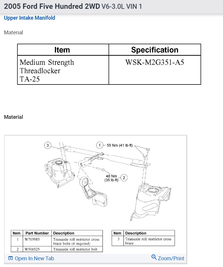

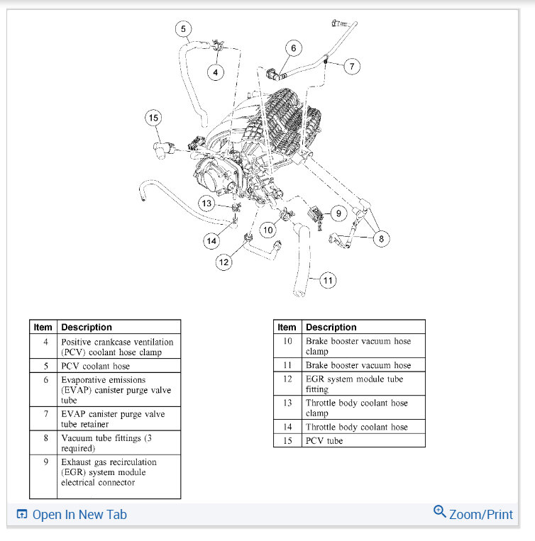

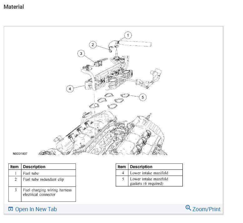

Here are the instructions for the installation and removal of the intake manifold in case you need it. Check out the images (below). Please let us know what happens.
