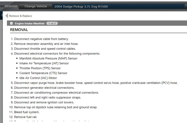

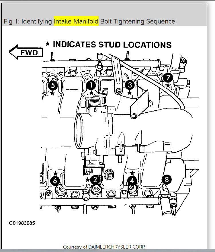

Okay, so I'm finished rebuilding the timing, putting together the engine. so, I already accounted for the bolts on the intake manifold being old and looking brittle. so of course i am over it. they aren't easily removable. they're in there on a spindle allowing them to spin infinitely. so how do i get those bolts out? I broke one off in the cylinder head and my whole day is shot now. how do i get the bolts out of the manifold itself to replace them?

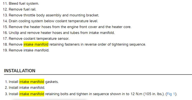

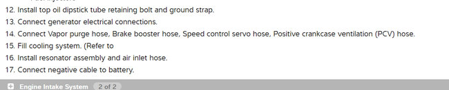

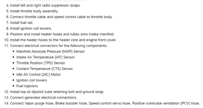

I am not quite sure what you mean by the bolts are on a spindle, but I have included for you in the diagrams down below a factory removal and installation guide for your vehicle's intake manifold. Please go through it and get back to us with what you find out, please. Let us know if you have any other questions that need to be answered.

So, it is the intake manifold hardware. they're mounted with a isolator cuff. they come factory so if you look at the bottom and see what keeps it in the manifold that is the cuff. so I spoke with a Dodge tech, they said the cuff can be knocked out from the bottom. get a punch and hammer and tap it out. I'm currently looking for replacement bolts which seem to be hard to find at a sane price. Checking OEM Dodge Chrysler parts. Everything seems to be working out so far just have to wait and get the broken stud removed later. Last day of rebuild turned into the last week of rebuild since i will have to lie in wait for parts.
