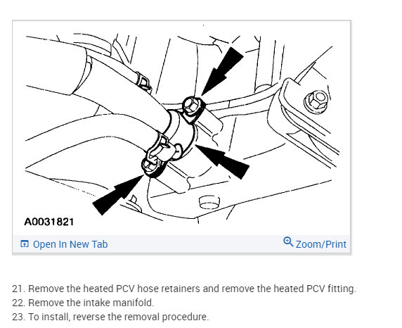

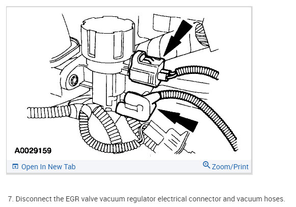

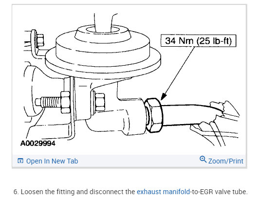

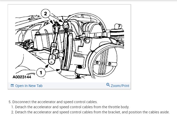

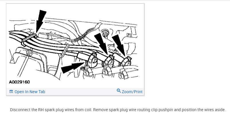

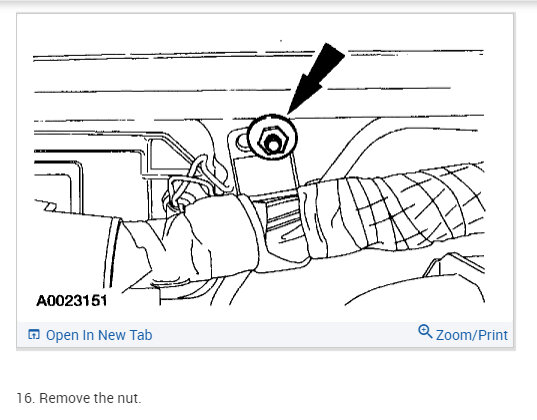

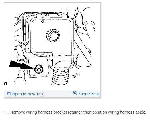

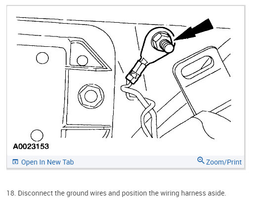

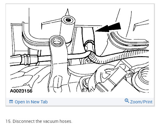

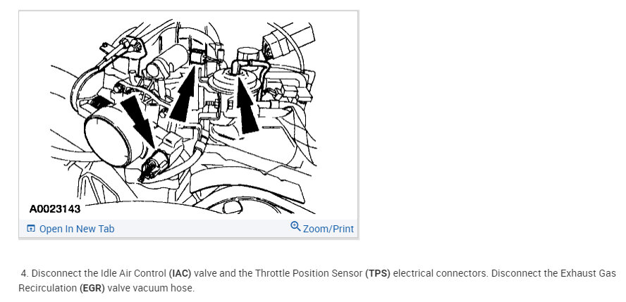

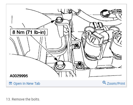

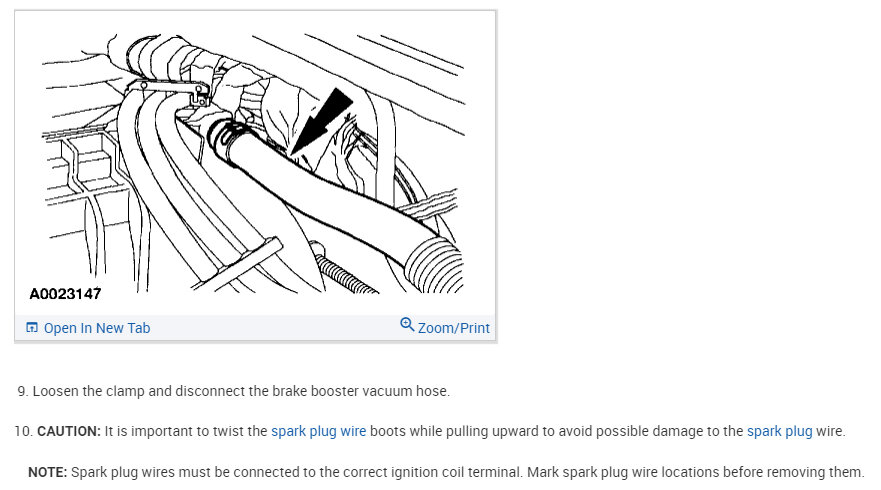

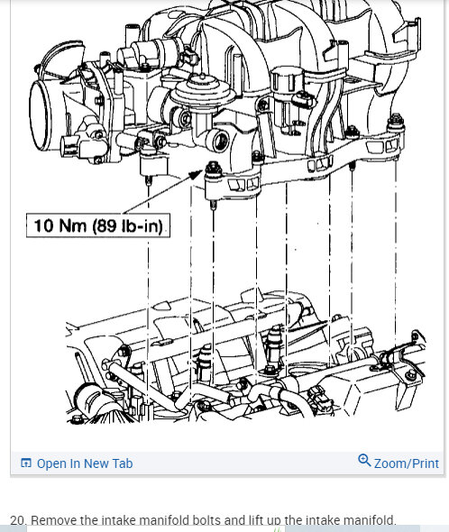

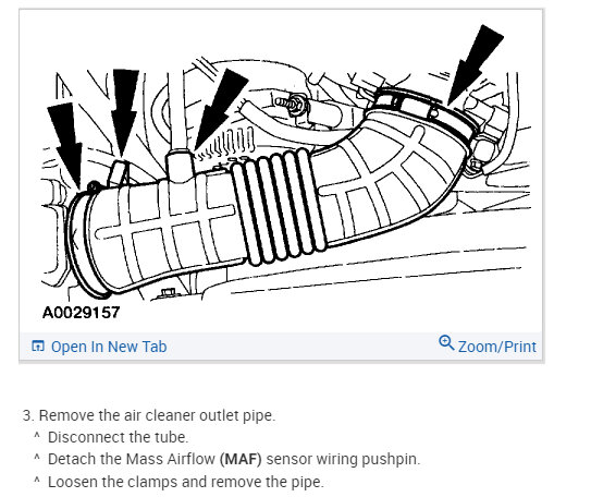

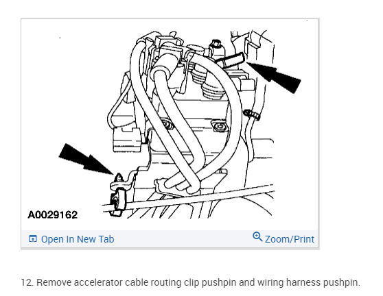

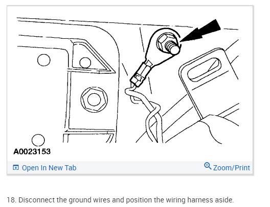

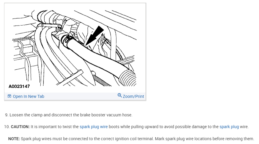

Schematics on Removing and replacing the intake manifold needed.
Feb 15, 2023 at 5:20 PM
  • 110,194 POSTS

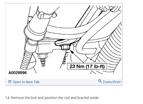

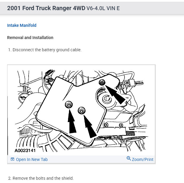

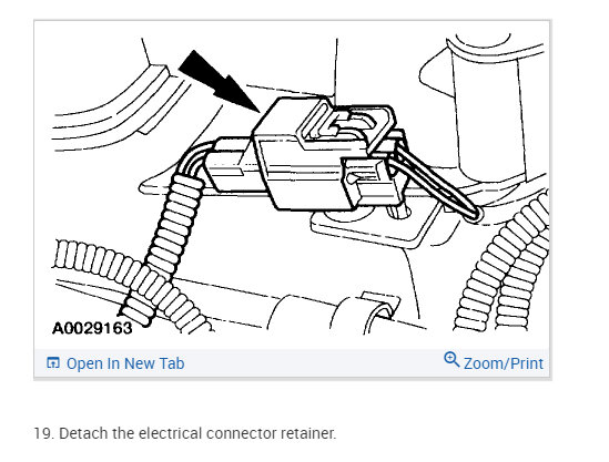

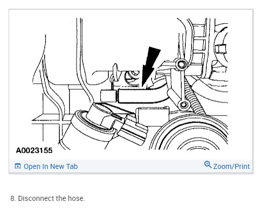

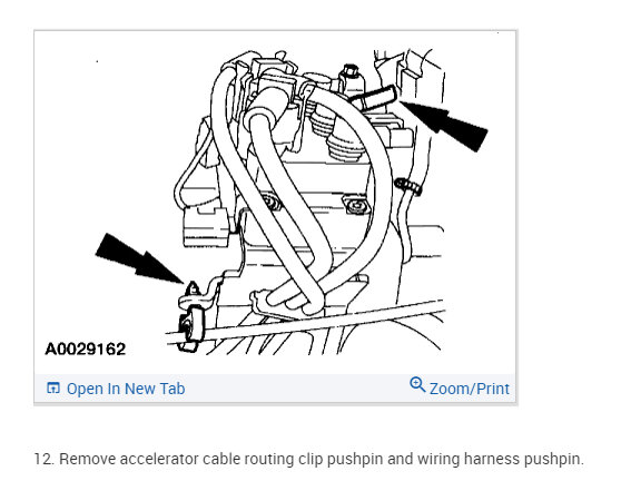

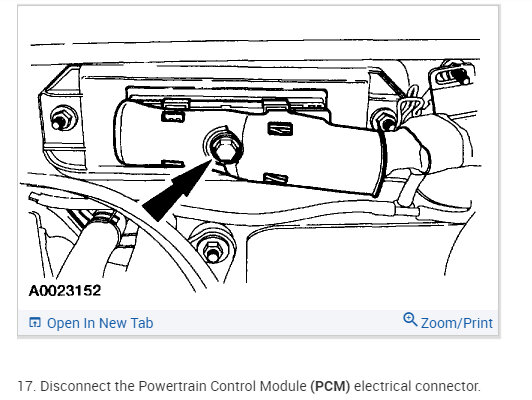

As far as removing the intake manifold, the worst part is removing everything so that you can actually disconnect it from the engine/vehicle.
If you look below, I attached the directions. Take a look through them and let me know if you have questions.
Let me know if this helps.
joe

Thanks, very helpful.
