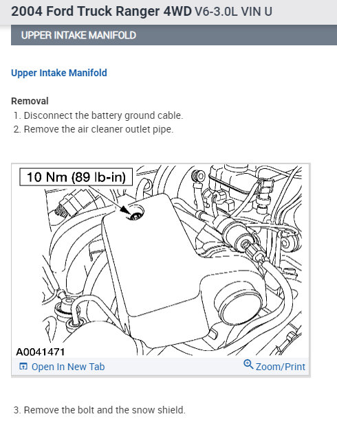

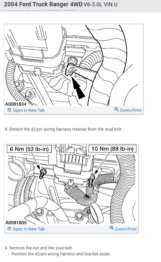

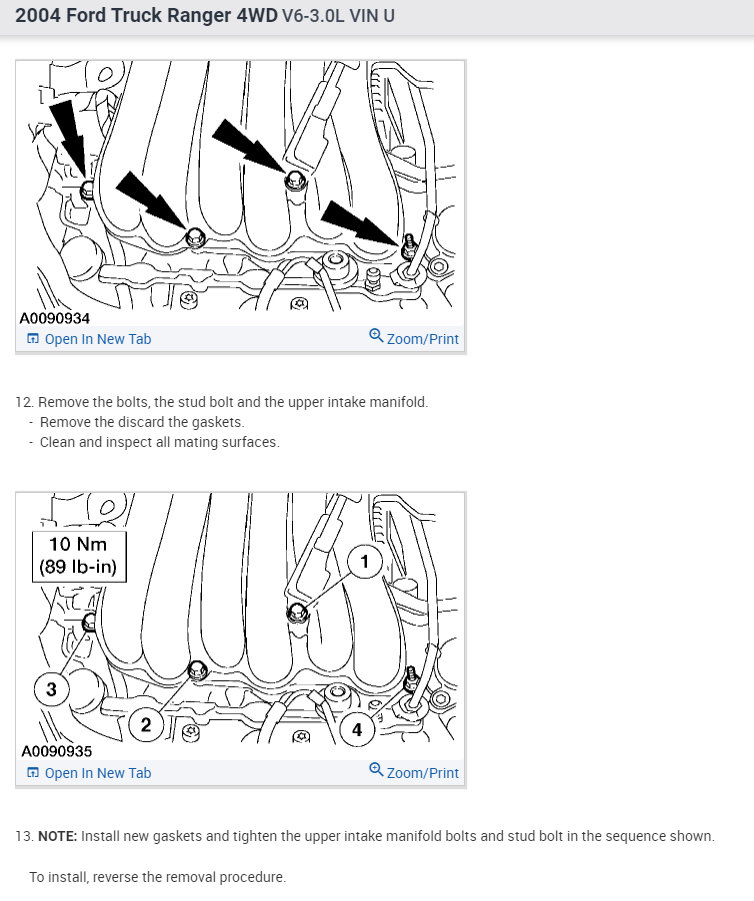

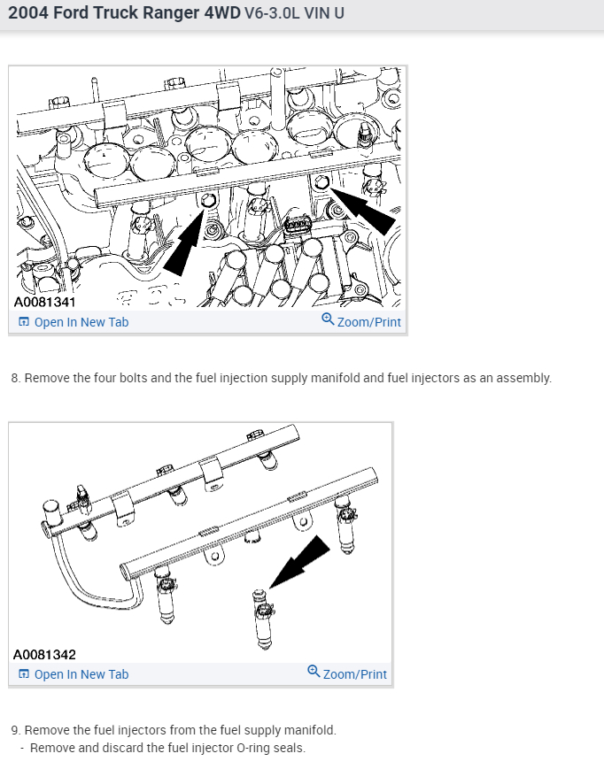

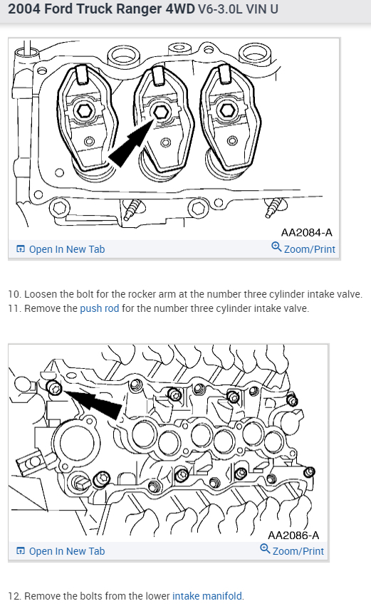

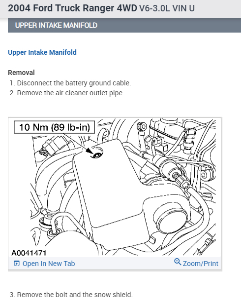

Will a 1996 Ranger XL intake manifold interchange with a 2004 Edge?
Apr 17, 2022 at 2:55 PM
SQM
  • 6,383 POSTS

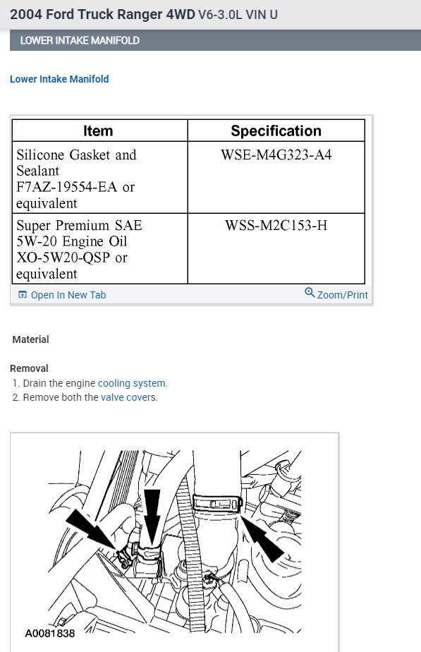

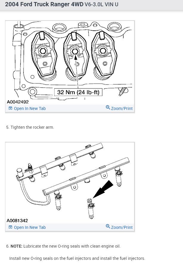

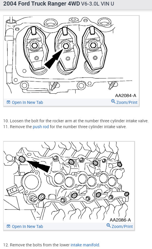

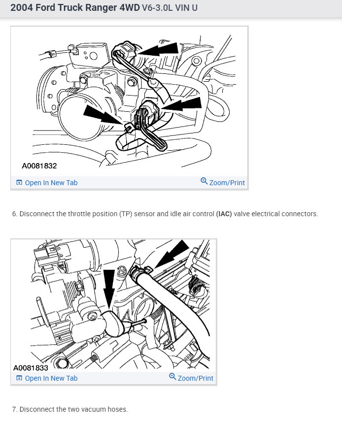

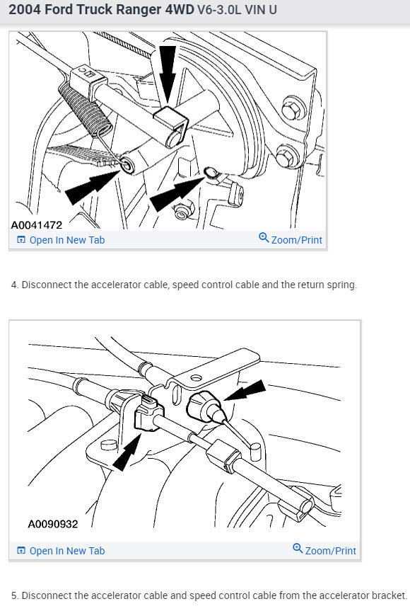

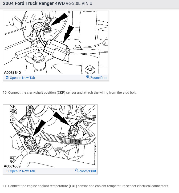

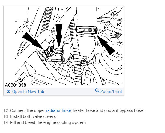

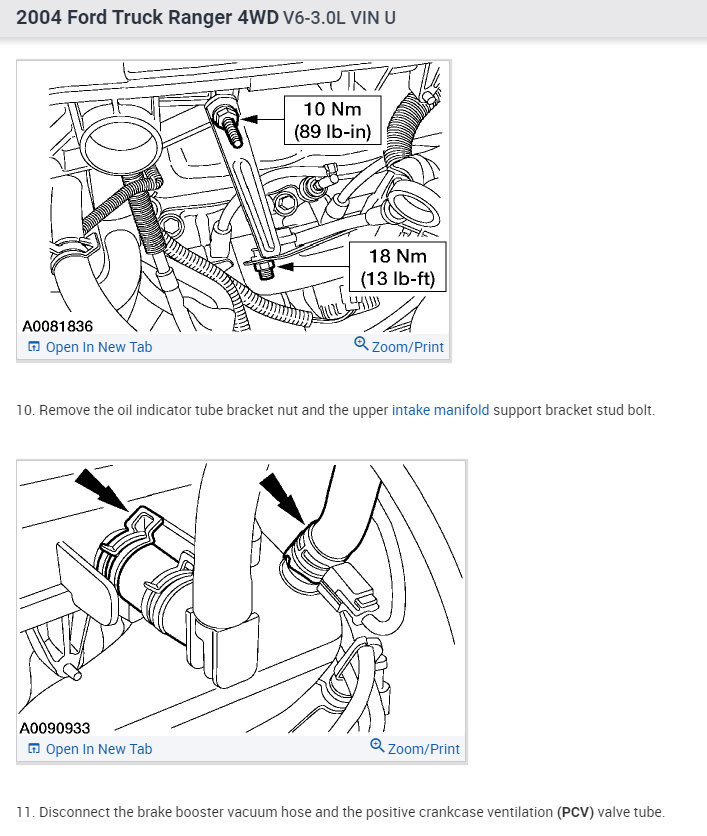

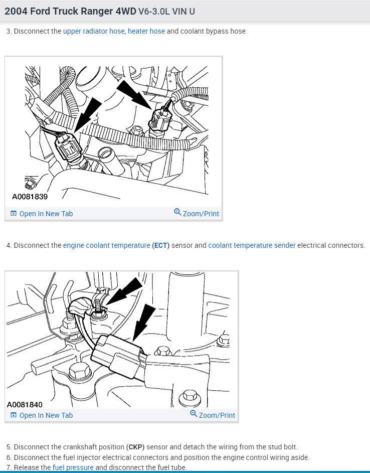

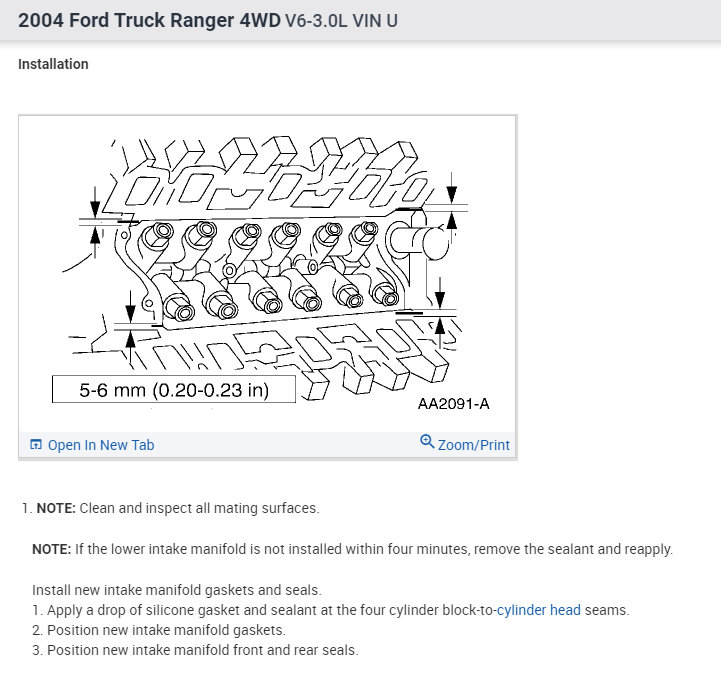

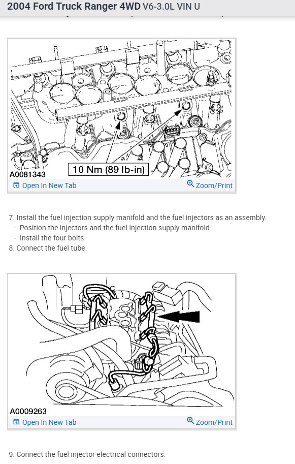

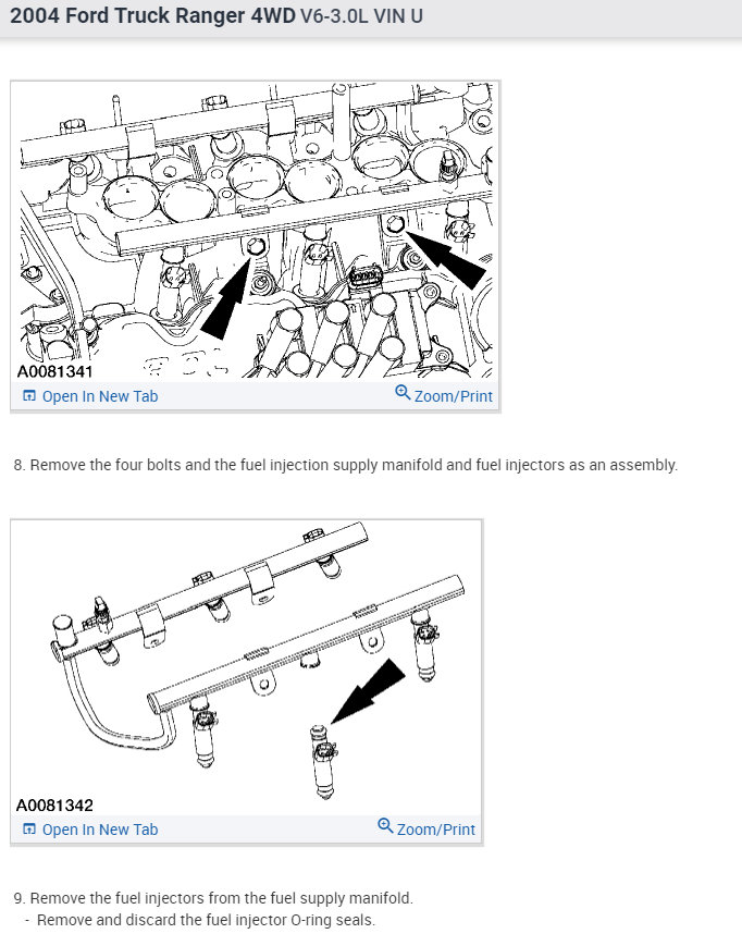

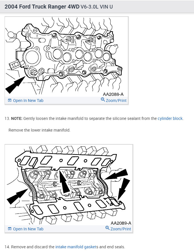

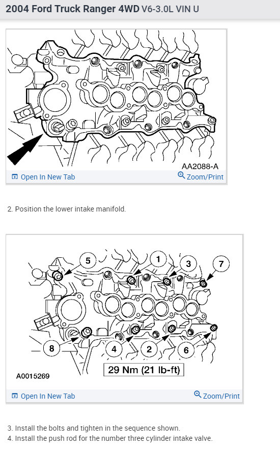

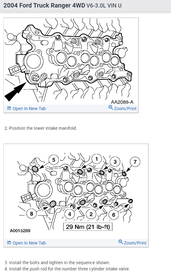

The 1996 and 2004 intake manifolds are different and are not interchangeable.
For the most part 2002-2004 uses the same manifolds.
https://www.2carpros.com/articles/replace-intake-manifold-gasket
I have attached the replacement procedure below for your reference.
Apr 17, 2022 at 3:56 PM
