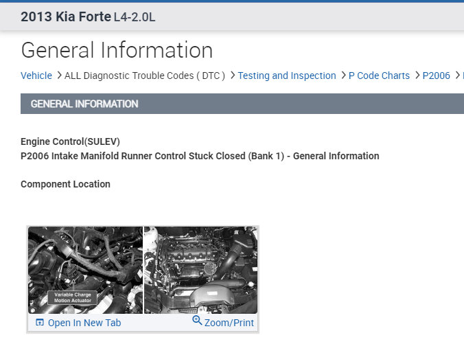

I have the vehicle listed above Koup. It is throwing code P2006 intake manifold stuck closed bank 1. I have replaced the manifold check engine light is still on I have already tried to clear the code with a computer, and I tried resetting it by driving over 150 miles and I tried to disconnect the battery for over 30 minutes. It is still throwing the same code. What do I need to try to do or what parts do I need to fix it?

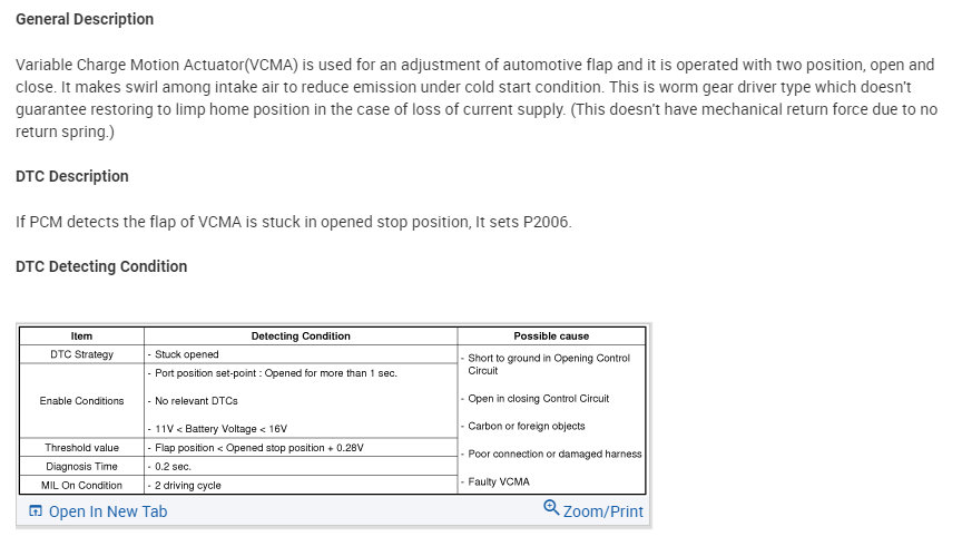

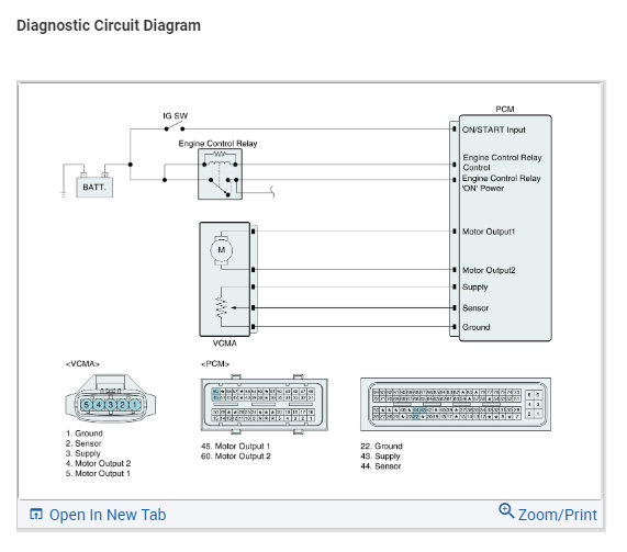

The issue is related to the runner control. Have you checked to make sure there are no wiring issues? If not, start with that. Check for a loose connector, corroded connector, or anything that may cause the light to stay on.
Next, I attached general information below specific to this vehicle. Take a look through the attached pics and see if anything is helpful.
