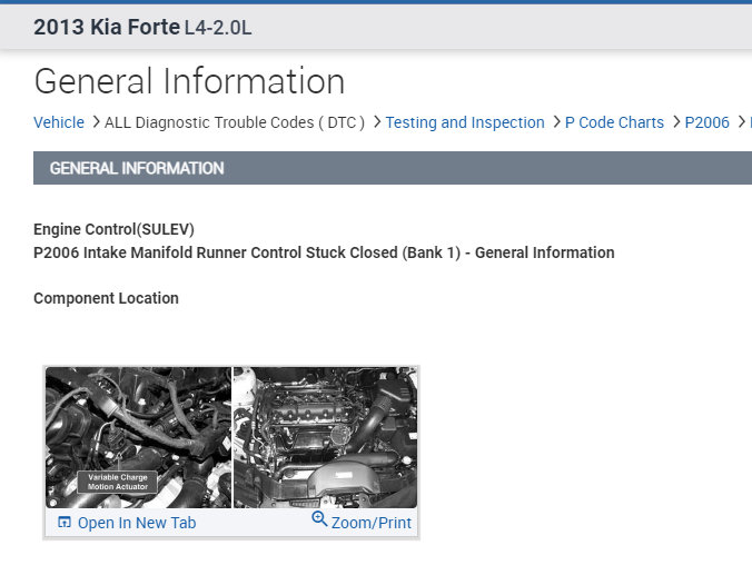

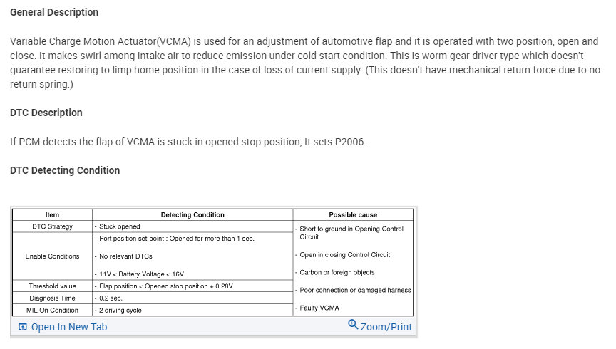

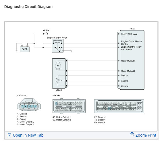

The issue is related to the runner control. Have you checked to make sure there are no wiring issues? If not, start with that. Check for a loose connector, corroded connector, or anything that may cause the light to stay on.
Next, I attached general information below specific to this vehicle. Take a look through the attached pics and see if anything is helpful.
