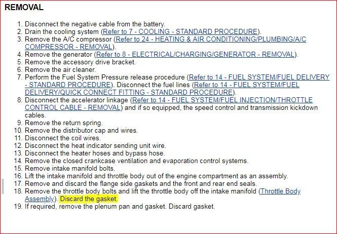

I just replaced intake manifold gaskets but over tightened two bolt and they snapped off.i drove around like that for a few days now but vehicle runs rough so I'm pretty sure I need to replace the two broken bolts.my question is, if I disassemble intake again,will I need a new gasket even though I just replaced it or will it be reusable?
Apr 18, 2019 at 11:10 AM
Hi Anthony,
Yes. Most likely the gasket has failed which is why it is now running rough. Since you are taking it apart again, I would not attempt to reuse the gasket. I attached the procedure from the manufacturer and they instruct you to discard the gasket as well so it is intended as a one time use gasket.
