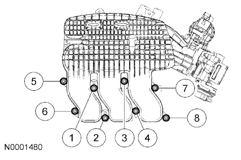

Does anybody know the torque sequence when putting the intake manifold back on?

The sequence is attached and the torque is 89 inch lbs. you need to replace the bolts. They are one time use only. Check out the diagrams (Below). Please let us know if you need anything else to get the problem fixed.
