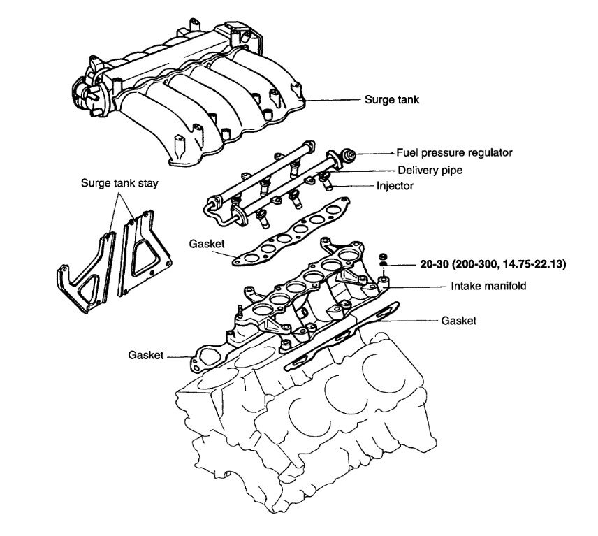

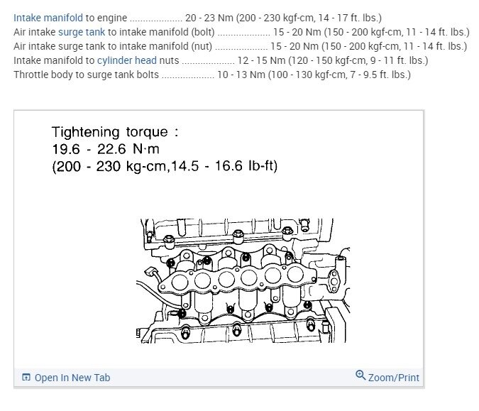

Trying to find the torch specifications to my intake manifold.
Aug 13, 2023 at 6:26 PM
STEVE W.
Experienced Mechanic
15,389 POSTS
Here are the specs for the intake pieces. Be sure to use an X pattern as you torque it down.
