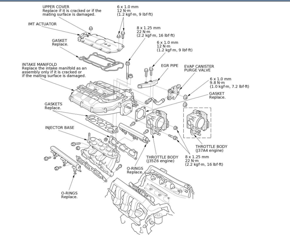

Is ultra copper gasket maker okay to use for in between the 2 halves of the intake manifold?

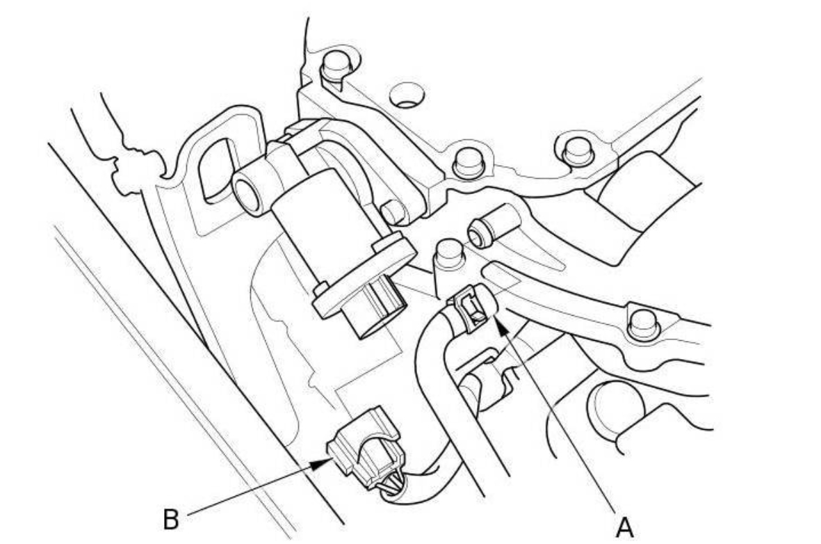

Good afternoon,
No, it is not. You use nothing but the gasket.
I attached the procedure for you of the repair.
https://www.2carpros.com/articles/replace-intake-manifold-gasket
Intake Manifold Removal and Installation
Exploded View
NOTE: Refer to the Exploded View if needed during this procedure.
Removal
1. Remove the engine compartment covers See: Access Cover, Engine > Removal and Replacement > Engine Compartment Cover Replacement.

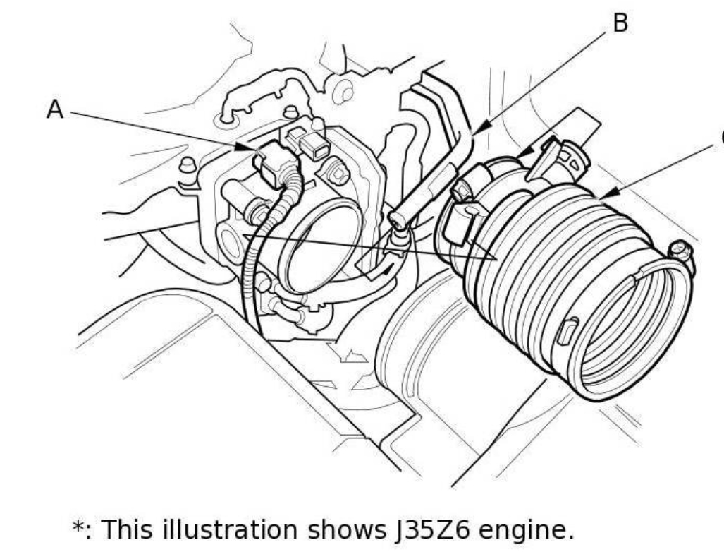

2. Disconnect the MAP sensor connector (A) and the breather pipe (B), then remove the intake air duct (C).

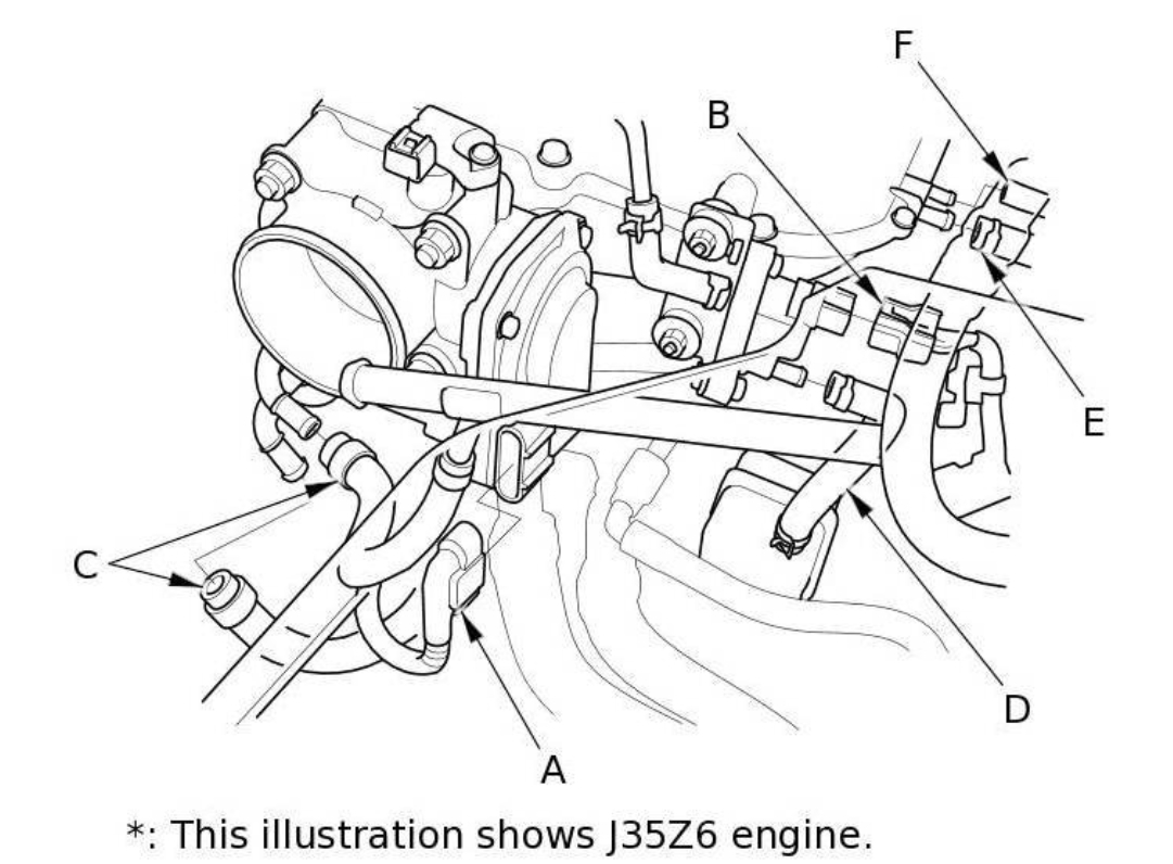

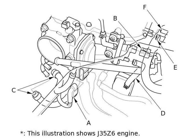

3. Disconnect the throttle actuator connector (A), the EVAP canister purge valve connector (B), the water bypass hoses (C), the EVAP canister hose (D), the brake booster vacuum hose (E), and the vacuum hose (F).
4. Disconnect the PCV hose (A) and the IMT actuator connector (B).

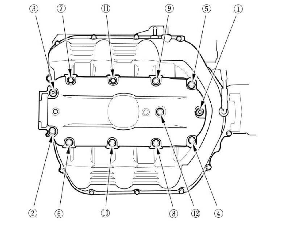

5. Remove the upper cover mounting bolts and nuts sequentially in three steps, then remove the upper cover.

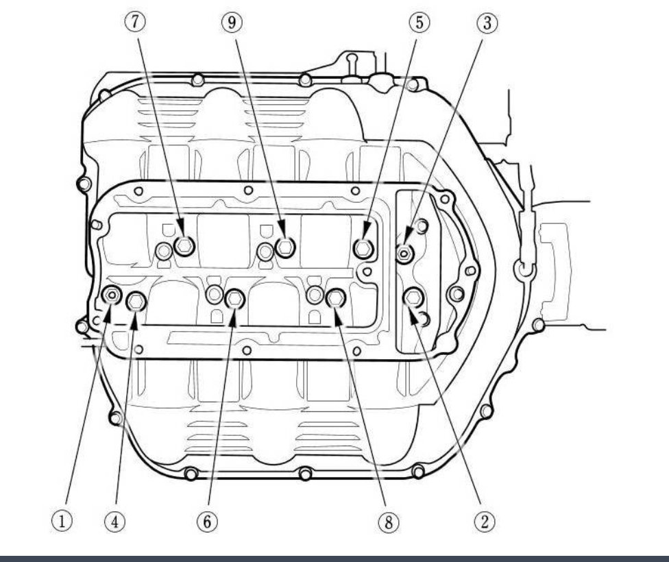

6. Remove the intake manifold mounting bolts and nuts sequentially in three steps, then remove the intake manifold.

I'm talking about plenum itself. It splits in two inside are the tubes that go to the runners. There was no "factory" gasket. I vaguely remember something about Honda bond for this, but now I can't find anything on that. I appreciate you help. Thanks
Dec 7, 2020 at 2:48 PM
Honda bond is what you use. It is the same a gray sealer and works great.
Dec 7, 2020 at 3:10 PM
IRONMAN433
Do you think the copper gasket maker is a good substitute? I don't have Honda bond. But I do have a big tube of ultra copper gasket maker. I'm about 70%-30% on using it. I just wanted a professional opinion. Thanks again.
Dec 7, 2020 at 3:19 PM
No, not at all. Get the Honda bond.
