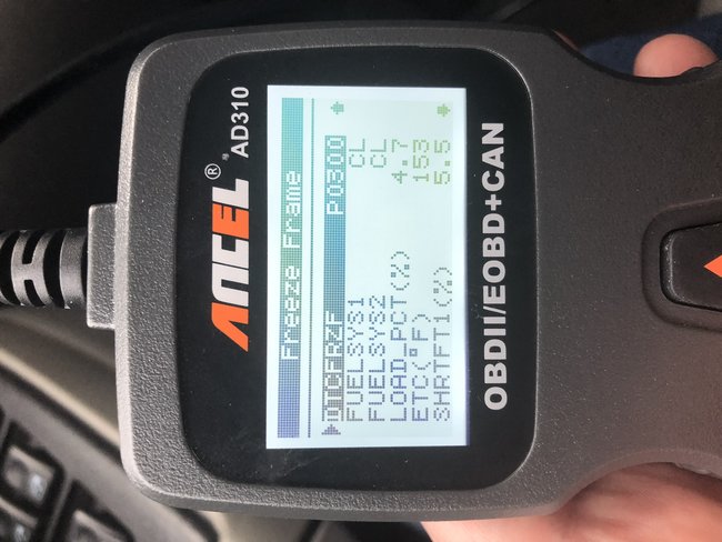

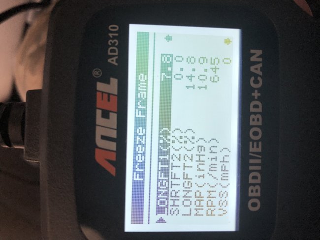

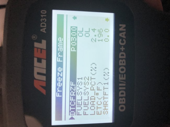

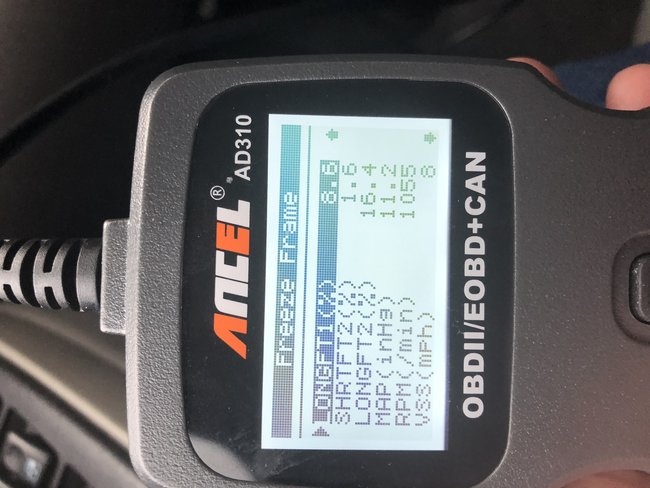

Pictures below are from freeze data. Trims on both banks above 10% with bank 2 being worse.
Since I have new injectors, new MAP, and intake is not leaking would this point to bad O2 sensors? I will get two new sensors in mail tomorrow. Should I replace both upstream, or a full bank?

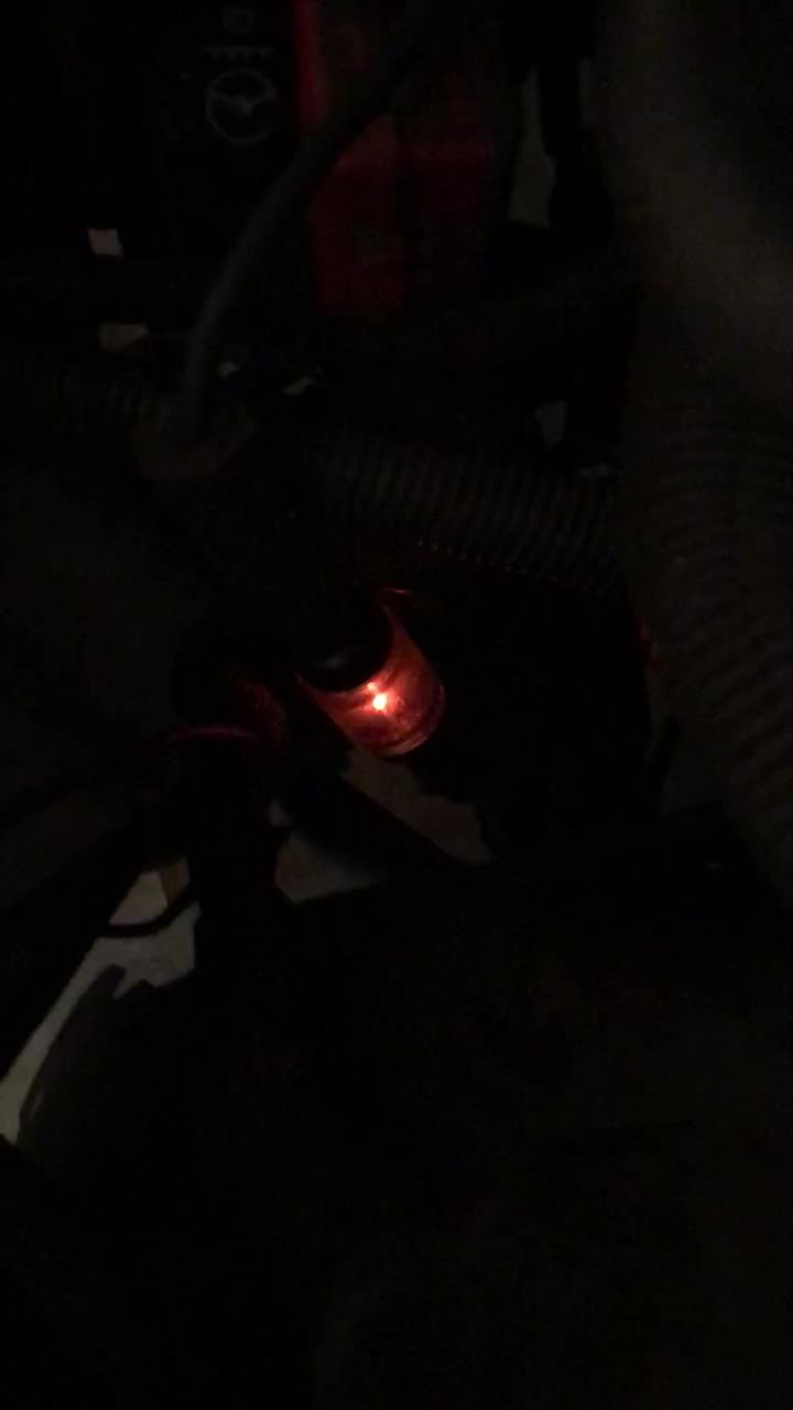

Were you able to see my video I sent yesterday of the spark test on cylinder #1? Did the spark appear to be missing?

Bank 2 is too high. You have a lean condition for bank 2 only.
No to the O2 sensor. It is doing its job.
No video came up from yesterday. Please resend.
Swapping injectors from left to right will verify injectors if the long term goes to bank .

Roy, I am trying to attach the spark test video again (cylinder 1). Hope it works.
It indicated it compressed the video and uploaded it. Hope you can see it.

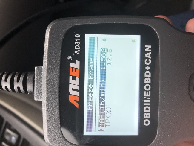

1. You cannot clean a mass air flow sensor. There is no cleaner that can get the burned carbon off the probe. If the sensor was bad, both banks would read the same. not one side high and one side low,
2. A vacuum leak definitely affects fuel trim. The fuel mapping will change when unmetered air enters the intake.
3. Your misfires are not enough fuel mixture, not too much so there is no additional unburned fuel/air mix.

I read in an article about fuel trims. Would this mean that if my MAF was bad only cleaned it) or there were a slight intake leak (none found) that high trims would not be caused by higher air intake so I got a new MAF that fixe it thank you.

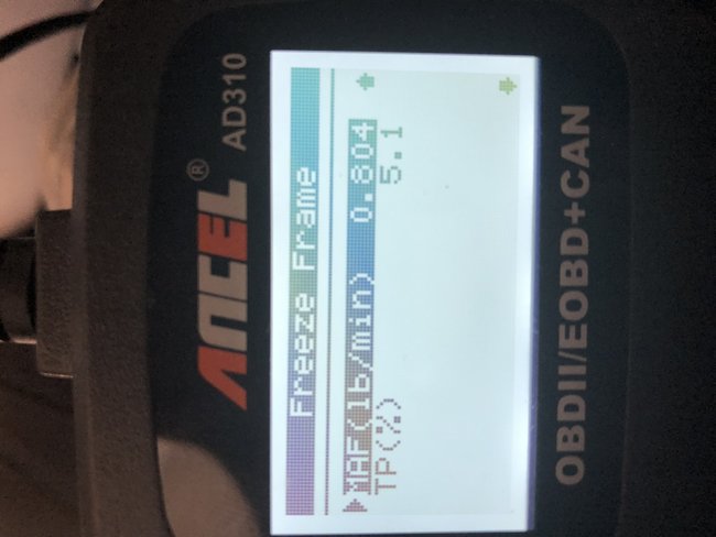

Roy attached is freeze data screens from drive this morning where P0300 code set.

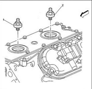

engine falls flat under load and sounds like spark knock checked for codes and got code p0300 multipel misfires changed plug did not help
May 6, 2021 at 5:58 AM (Merged)
  • 110,251 POSTS
They are two different items. The knock sensor's job is to keep engine timing at it optimum position, just before you get valve ping. Here is a picture:
https://images.2carpros.com/forum/automotive_pictures/249084_5_28.jpg

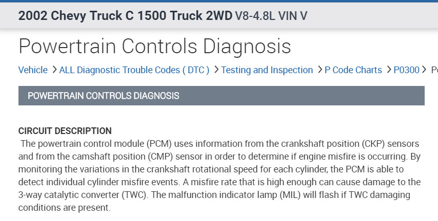

2004 Chevy Truck Silverado 1500 4WD V8-5.3L VIN T

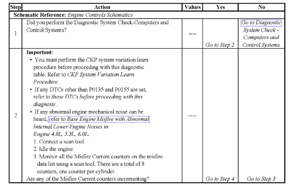

Important Information - PIP 3056

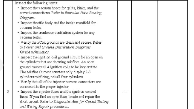

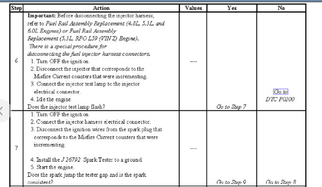

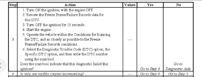

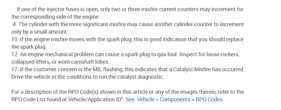

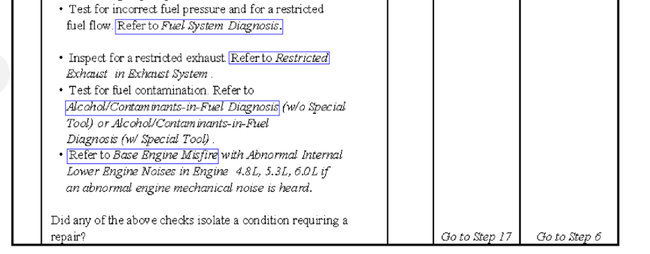

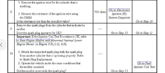

Vehicle ALL Diagnostic Trouble Codes ( DTC ) Testing and Inspection P Code Charts P0300 Important Information - PIP 3056
IMPORTANT INFORMATION - PIP 3056
Subject: 97-05 Vehicles with 4.8 5.3 5.7 and 6.0 Gen III V8 Engines and Misfires on One Bank - kw CEL diagnostics driveability DTC P0171 P0172 P0174 P0175 P0300 P0301 P0302 P0303 P0304 P0305 P0306 P0307 P0308 #PIP3056 - (07/12/2004)
Models: (00-05 Cadillac Escalade - C6 and K6) and (02-05 Chevrolet Avalanche - C1, C2 K1 and K2) and (99-05 Chevrolet Silverado - C1, C2 K1 and K2) and (00-05 Chevrolet Suburban - C1, C2, K1 and K2) and (00-05 Chevrolet Tahoe - C1 and K1) and (99-05 GMC Sierra C1, C2 K1 and K2) and (00-05 GMC Yukon - C1, C2, K1 and K2) and (03-05 Chevrolet Express G1, G2, G3, H1, H2 ) and (03-05 GMC Savana G1, G2, G3, H1, H2 ) and (04-05 Buick Rainier S1, T1 ) and (03-05 Chevrolet Trail Blazer EXT S1, T1 ) and (03-05 GMC Envoy XL XUV S1, T1 ) and (03-05 Hummer H2) and (04-05 Cadillac CTS-V DB) and (98-02 Chevrolet Camaro FB) and (97-04 Chevrolet Corvette YB) and (98-02 Pontiac Firebird FB) and (04-05 Pontiac GTO VB)
The following diagnosis might be helpful if the vehicle exhibits the described symptoms.
Condition/Concern:
Check Engine Light with a P0300 due to 2 - 4 cylinders misfiring on the same bank of the engine. DTCs P0171, P0172, P0174 or P0175 may also set for the misfiring bank.
Recommendation/Instructions:
If the published misfire diagnostic does not isolate the cause, perform the following suggestions as necessary:
- Perform a fuel injector balance test for all 8 cylinders. If a fuel injector concern exists, it is possible to misfuel an entire bank of the engine, causing multiple cylinders on the same bank to misfire even though the root cause is a single fuel injector.
- Inspect O2 sensor connections on the misfiring bank for corrosion or water intrusion. If water intrusion is found on the right bank, it may be due to the AC Evaporator Condensation dripping onto the O2 sensor harness. If this condition is found, reposition and shield the harness to prevent a repeat concern and repair the connections.
- Check for excessive exhaust backpressure using the restricted exhaust diagnosis.
- Swap the Position 1 O2 sensors side to side to see if the misfires move to the other bank of the engine. If so, replace the O2 sensor.
Please follow this diagnosis process thoroughly and complete each step. If the condition exhibited is resolved without completing every step, the remaining steps do not need to be performed.
NOTE: GM bulletins are intended for use by professional technicians, not a "do-it-yourselfer". They are written to inform these technicians of conditions that may occur on some vehicles, or to provide information that could assist in the proper service of a vehicle. Properly trained technicians have the equipment, tools, safety instructions, and know-how to do a job properly and safely. If a condition is described, do not assume that the bulletin applies to your vehicle, or that your vehicle will have that condition.

Compared all scanner data with another truck that is known to be operating properly
the only difference noted being bank#2 sensor#2 is staying down around 100-200 mv.
At 1 point there was a map sensor code.
I suspected a possible cracked or leaking upper intake.
but when I called the dealer they told me they had never sold one or even priced one before. I'm running out of things to check.
Does anyone have any more ideas?
Thanks in advance.
May 6, 2021 at 6:00 AM (Merged)
FISHERMAN
  • 937 POSTS

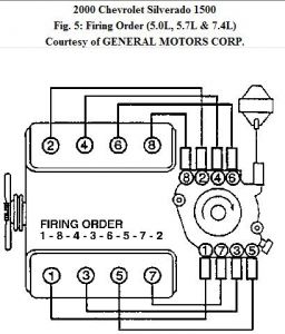

Hello !! Cyl #3 and #7 are in the same side.. not next to each other...
https://images.2carpros.com/forum/automotive_pictures/576_0_13.jpg
On the same side on the distributor cap... Did you replace the "cap" How about the spark plugs? When did you replace them? Are the correct "heat"? Did you check the pick-up coil? could be "missing" at low RPM`s Let me Know and I`ll be thinking about it.. BTW thanks a Lot for your donation!!
ROWTIEAR
  • 91 POSTS
Hello and thanks for responding
The spark plugs are approx. 2 months old and installed by myself at the shop where I work.
I am also a tech
The 5.3 litre is d.i.s. "one coil per plug"
#2 cyl and #7 cyl are the problem cyls
I am aware that they are on opposite ends of the engine.
The only thing I have found is that they follow each other in the firing order but I can't see the crank sensor causing the problem on just the two cyls.
Any other input would be appreciated.
FLEXY5
  • 512 POSTS
Replace the intake gaskets, not the intake. That should fix your problem. You were getting a MAP code because the engine is sucking unmetered air, more that what the computer thinks should be. Basically, your computer is confused. It is taking the readings from the TP and O2 sensors and says that the intake should be sucking a certain volume of air, based on MAF. When you have an intake leak, it produces a lower vacuum that what the computer thinks it should, making the computer think that the MAP is bad. This also explains the O2 sensor reading (which is lean). The engine is sucking more air than what the computer can compensate for. Hope this helps. If you need any more info, don't hesitate to ask.
Dave
