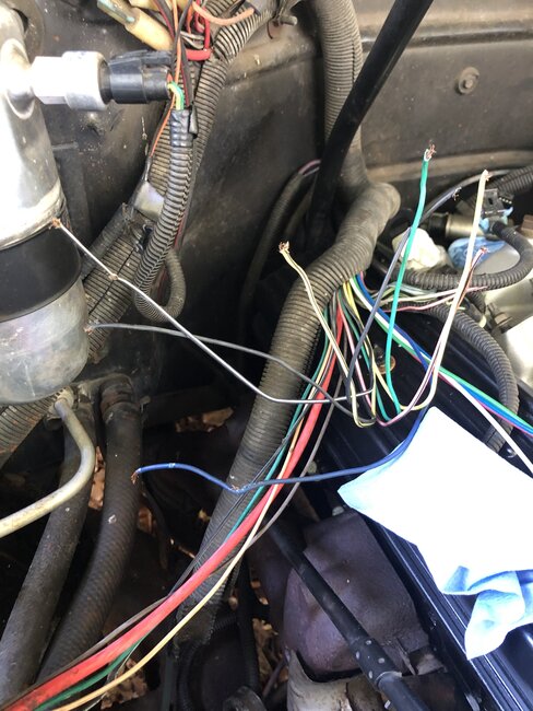

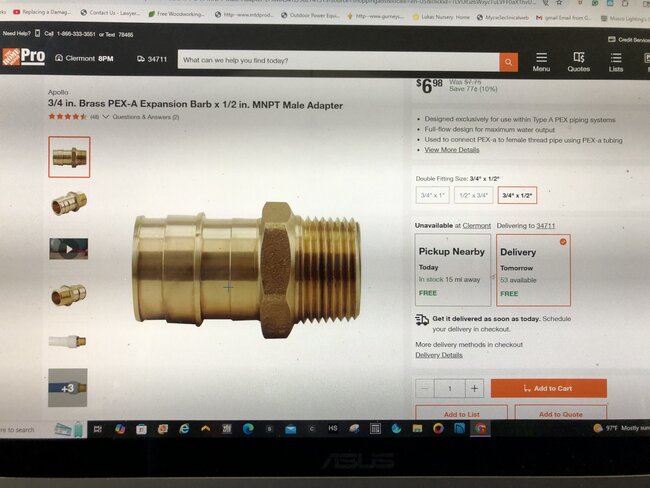

Can I use a brass barbed 3/4 x 1/2 fitting to replace the quick connect fitting to avoid leaks. They just don't seem to last. My only worry is the pressure reducer that is in the factory fitting will not be there. Will that be a problem? I see people doing it on 95 and later models but my line goes right from the intake to the heater core. Any suggestions for some type of upgrade would be greatly appreciated.

I hear you. I have already removed the old pot metal connector and replaced it with the brass fitting in the first picture (I went with the one used in the 1Road video on YouTube). My concern is some people say if I don't use a reducer like the one in the pot metal fitting I will be putting too much flow on the cylinders and heater core and cause future problems. My question is: If I hook up just a heater hose of the same size (5/8 or 3/4) from the back of the intake to the right side of the heater core outlets (in second picture) just like it was, am I looking for problems with the cylinders or heater core from too much pressure or coolant?
Aug 20, 2025 at 7:59 AM
  • 55,433 POSTS
Well, they say the flow from the coolant is to fast and can make the heater core leak, so a restriction plug maybe in order.
