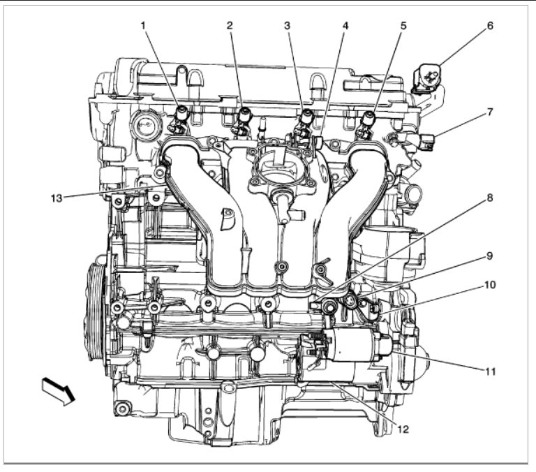

When stopping car jerks and has a miss
2011 CHEVROLET HHR
112,000 MILES • 2.2L • 4 CYL • AUTOMATIC
GGHOLAR
car has a miss and jerks when you come to a stop. intake camshaft position actuator circuit open bank 1.
Apr 16, 2018 at 8:18 PM
  • 54,840 POSTS

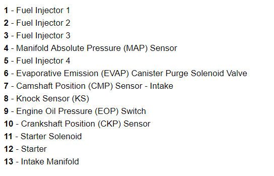

I would replace the camshaft position sensor or make sure it is plugged in. Here is a guide that will show you what you are in for when doing the job:
https://www.2carpros.com/articles/camshaft-angle-sensor-replacement
Here is the location for your car.
Apr 19, 2018 at 10:40 AM
