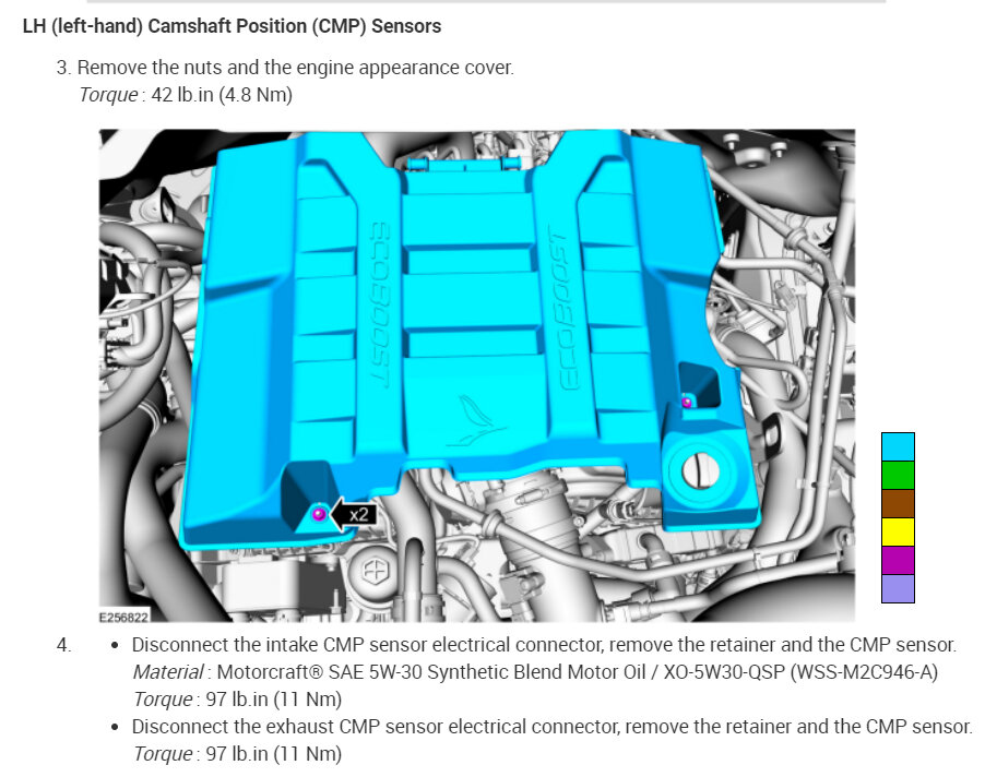

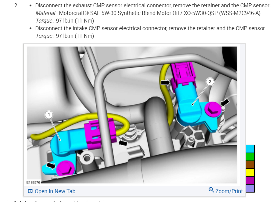

Where can i find the intake camshaft sensor for bank 2? I've tried looking at videos but cannot find my 2020 diagrams.
This is an ecoboost as well.
Aug 11, 2023 at 6:15 AM
  • 55,402 POSTS

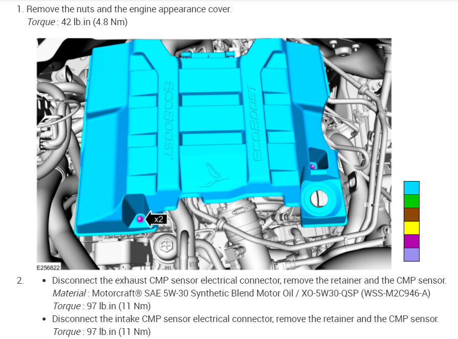

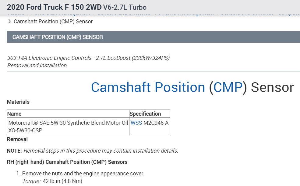

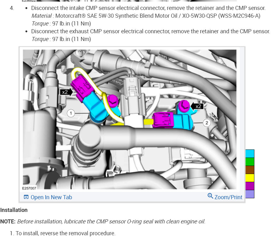

Sure, here are the right and left bank camshaft position sensor for the engine you have requested. Check out the images (below). Please let us know if you need anything else to get the problem fixed.
Aug 12, 2023 at 3:55 AM
MJR346
  • 132 POSTS
Drivers side.. bank 1 is passenger, bank 2 is drivers.
