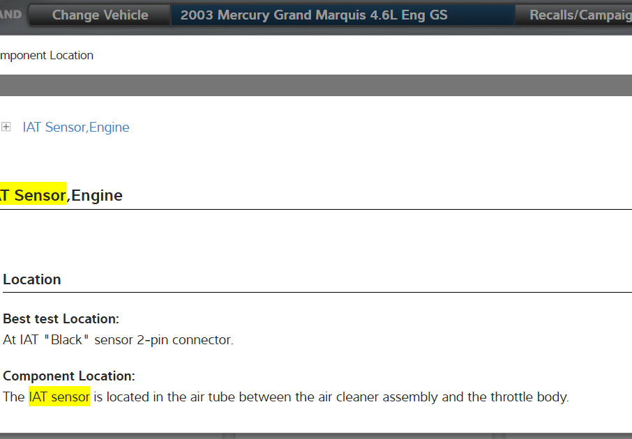

Can’t find the intake air temperature sensor.
Mar 29, 2019 at 1:04 PM
SCGRANTURISMO
  • 4,897 POSTS
The Intake Air Temperature sensor(IAT) is going to be in the intake air duct inbetween the Mass Airflow sensor(MAF) and the throttle body. I have included information about this in the diagrams down below. Please let us know if we can help you with anything else.
