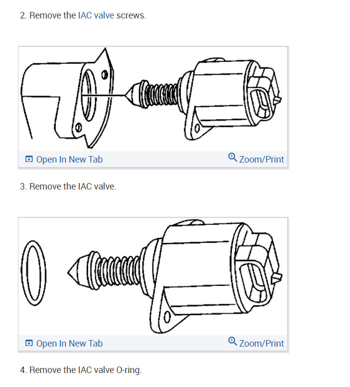

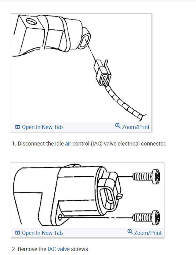

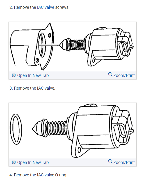

Engine idles up when put in gear and take off just like put on cruise control. intake air flow?
Nov 2, 2021 at 12:50 PM
Experienced Mechanic
52,796 POSTS
Good morning,
This sounds like the idle air control valve is sticking causing the engine to surge forward.
https://www.2carpros.com/articles/how-a-idle-air-control-valve-works
I attached the procedure for you to follow below and pictures of the valve on the throttle body.
https://www.2carpros.com/articles/how-to-replace-an-idle-speed-control-motor-iac
Important: The powertrain control module (PCM) will reset the IAC valve whenever the ignition is turned On, then Off. Turn the ignition on for 10 seconds, then Off for 5 seconds.
