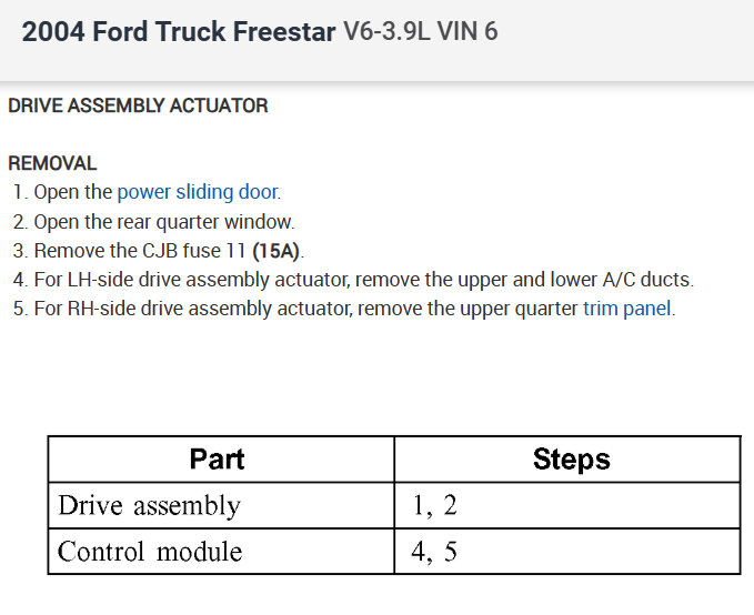

I would check the tracks to make sure something is not stuck and if not, it sounds like the drive motor/cables are having an issue. You might want to try a re-initialization:
POWER SLIDING DOOR INITIALIZATION
1. Disconnecting the battery or smart junction box (SJB) fuse 11 (15A) will cause the power sliding door control module to lose memory. The power sliding door initialization procedure must be carried out before the power sliding doors will operate under all conditions. The power sliding door initialization procedure is a learning process for the module to identify the full open position and the full closed position. After power is restored to the vehicle, initialize the sliding doors as follows:

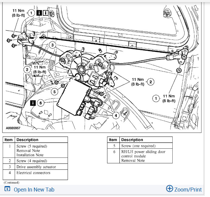

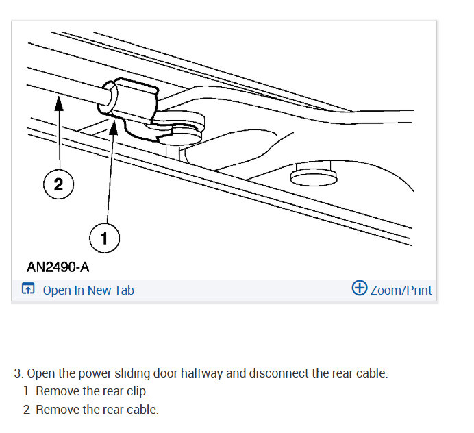

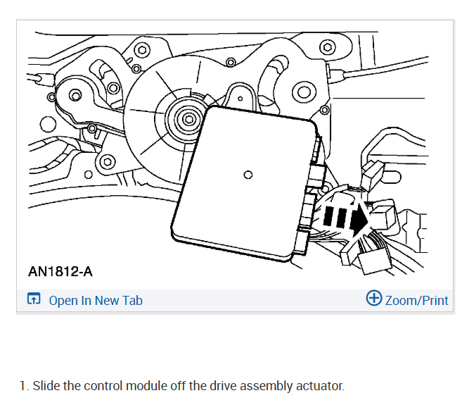

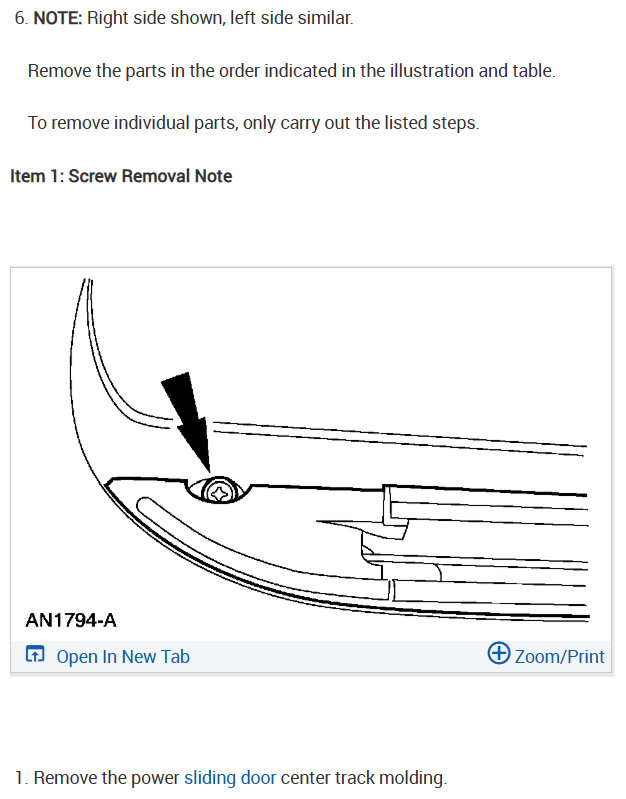

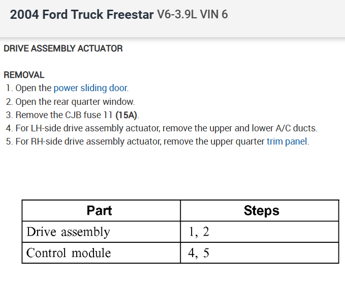

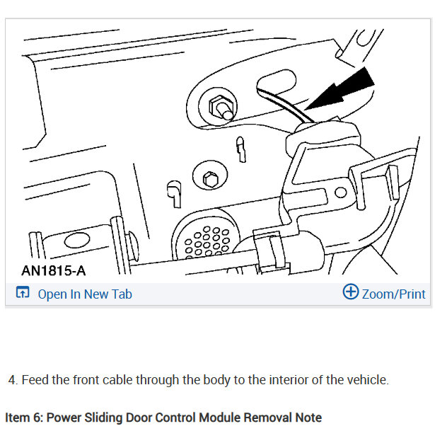

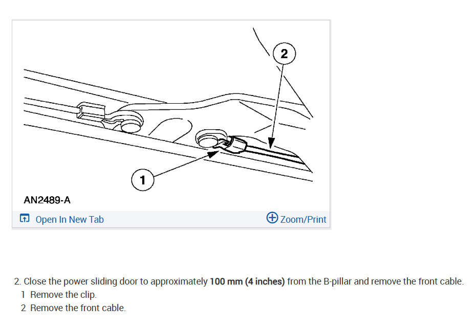

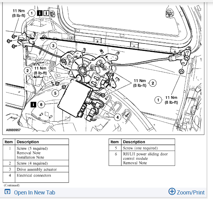

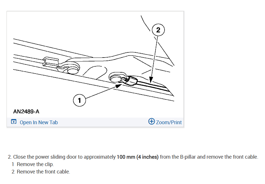

If this does not work here is how to change the motor and drive cables out. Check out the images (below). Please upload pictures or videos in your response of any problems so we can see what to help you with.
