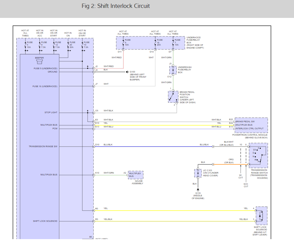

insturment cluster issue
2001 HONDA CIVIC
200,000 MILES • 1.9L • 4 CYL • 2WD • AUTOMATIC
CHAD MORRIS2

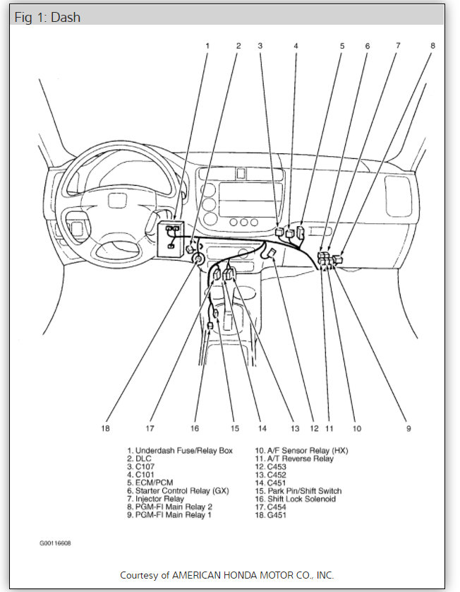

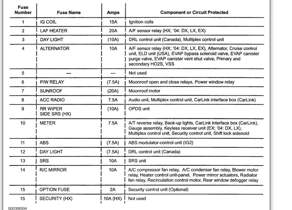

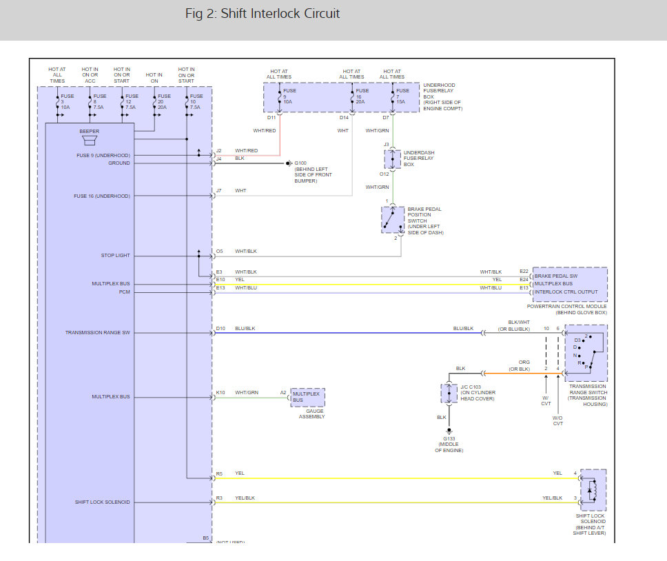

The instrument cluster wont light up at all and car will only go into gear when you unengaged shift lock.
Jun 17, 2019 at 1:02 AM
  • 55,167 POSTS

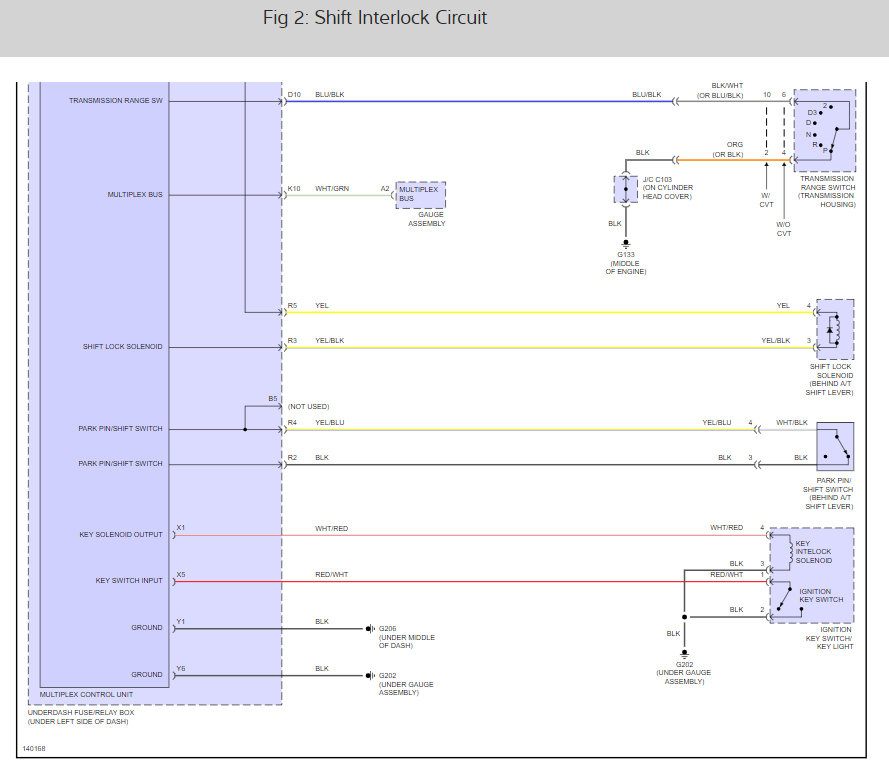

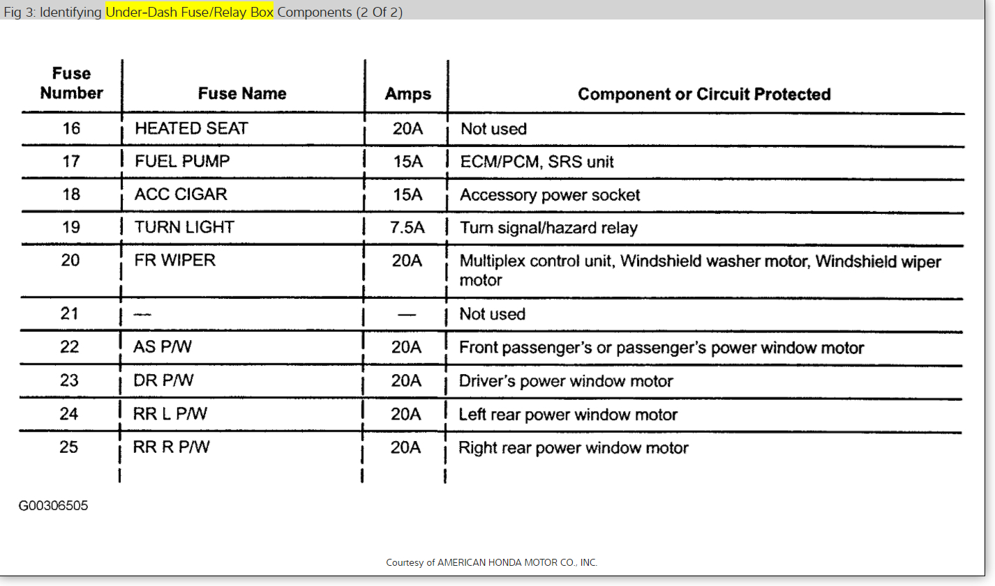

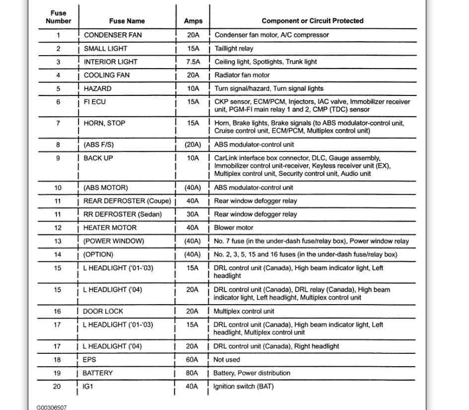

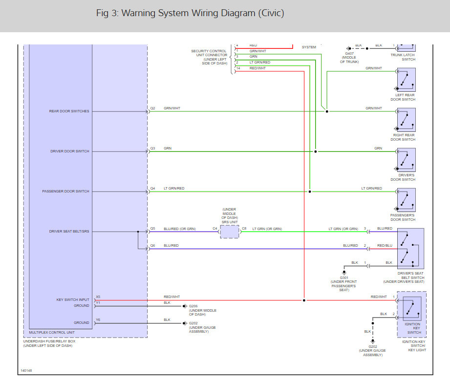

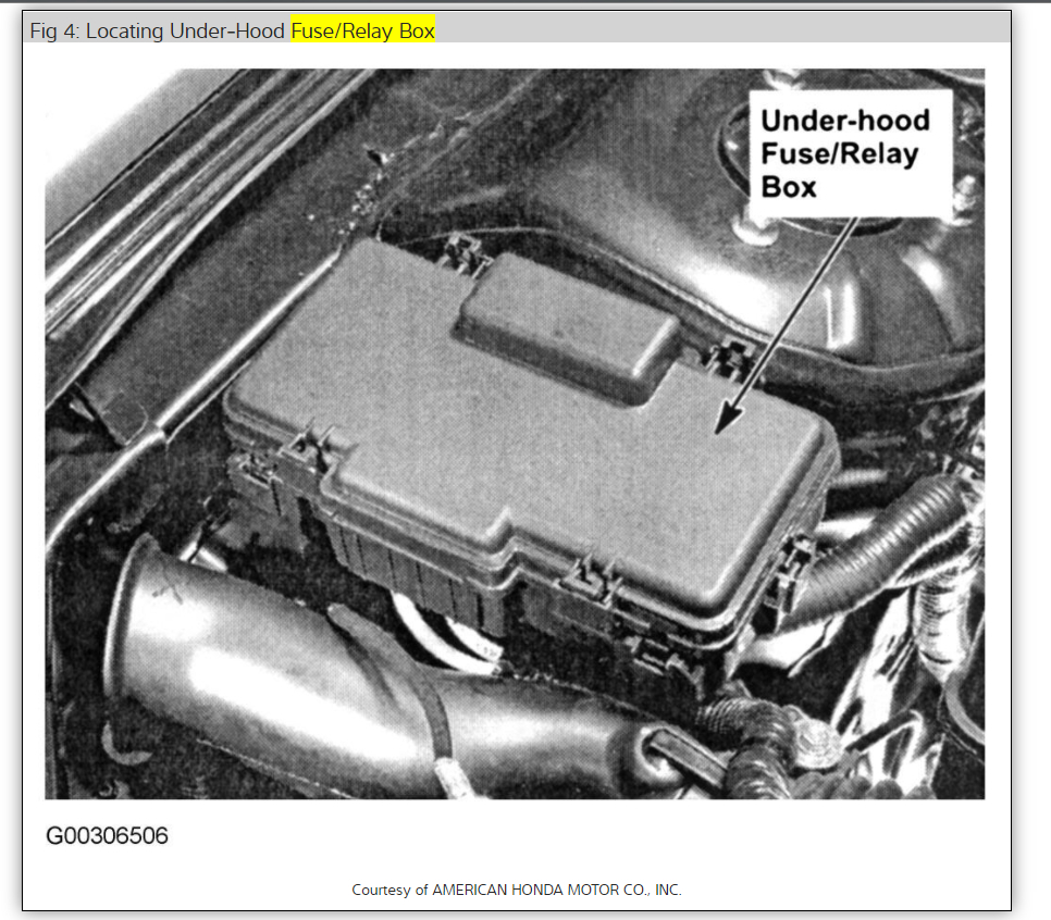

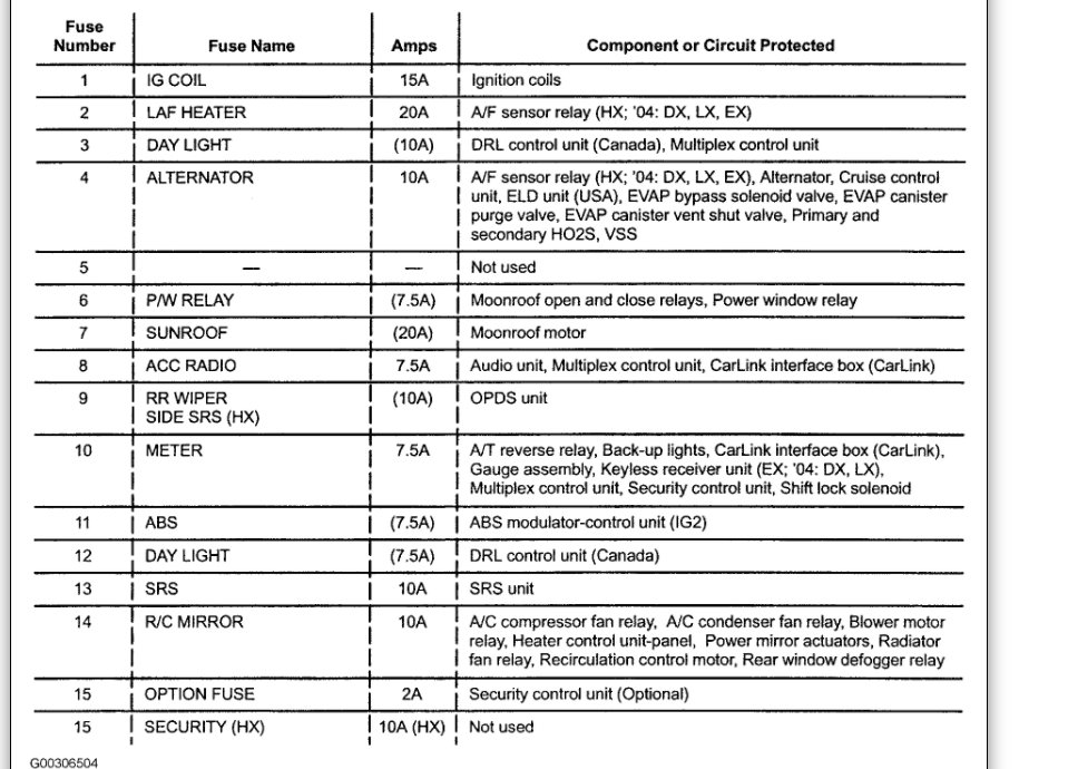

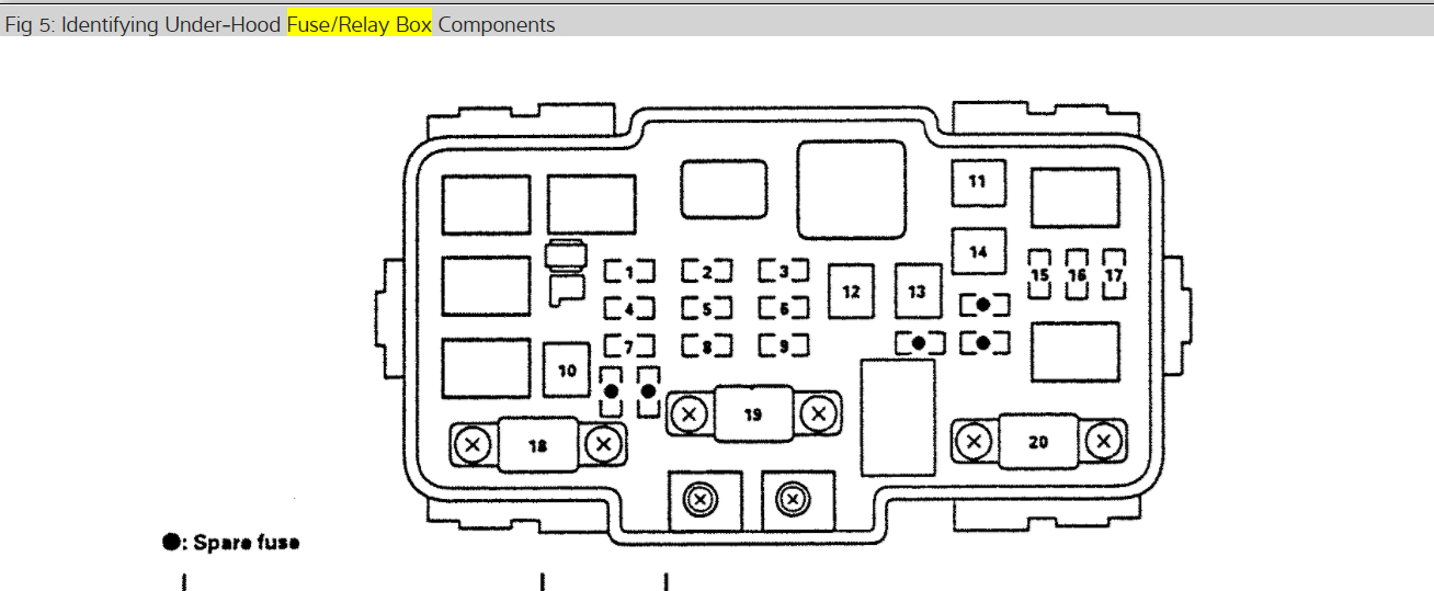

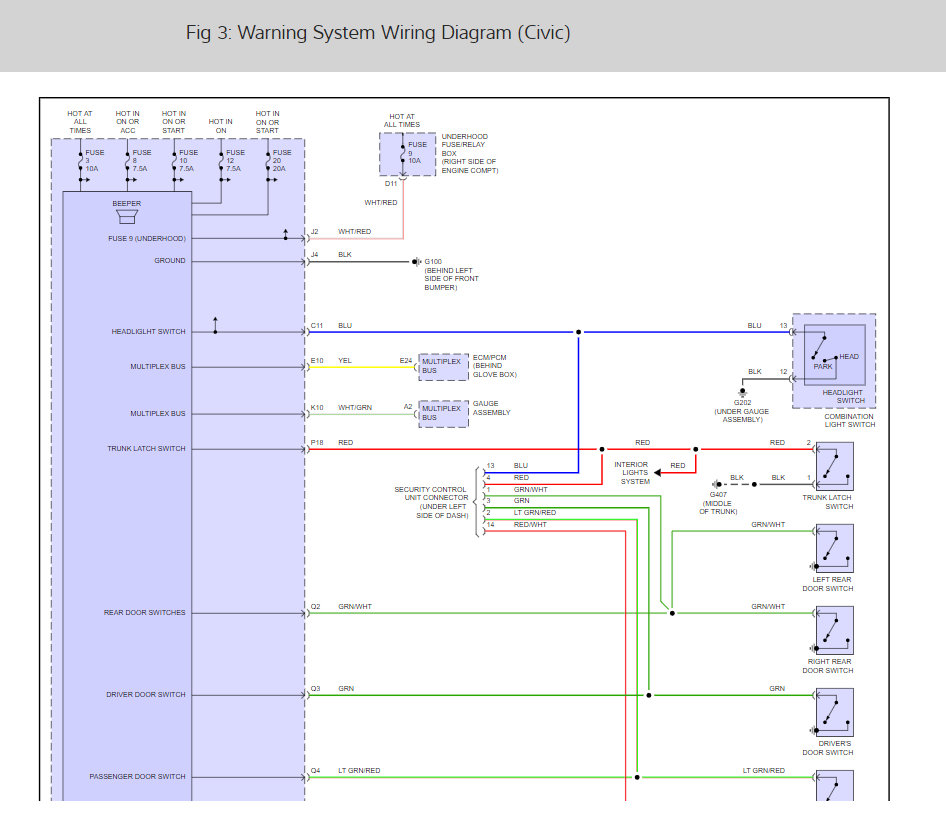

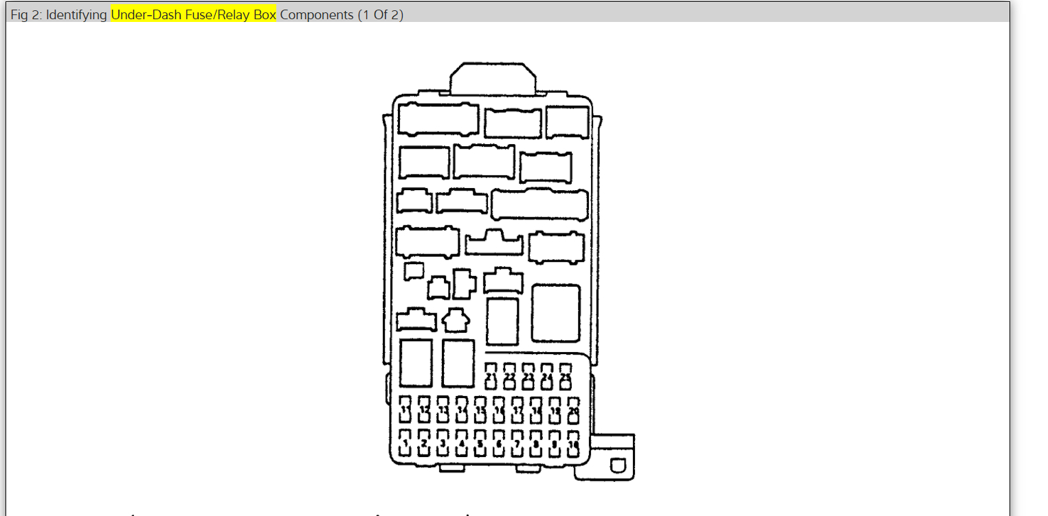

It sounds like the multiplex control is out. I would start by checking the 6 fuses that run the multiplex controller. Here is a guide to help and the fuse location with the wiring diagrams so you can see which fuses to check:
