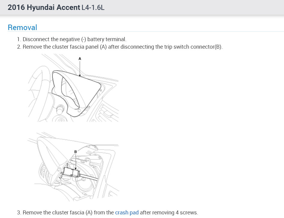

As i was driving the instrument lights turned off for a second, then turn on back and the odometer trip reset to 0.0. i would like to know what is wrong with that?
Apr 7, 2023 at 2:16 AM
  • 55,421 POSTS
This sounds like the cluster is going out but to be sure we need to do a CAN scan. You can get a CAN scanner (Controller Area Network) from Amazon.
https://youtu.be/u-4syLc-ifQ
and
Here is one for about $99.00 if you need it:
https://amzn.to/3ZixY4v

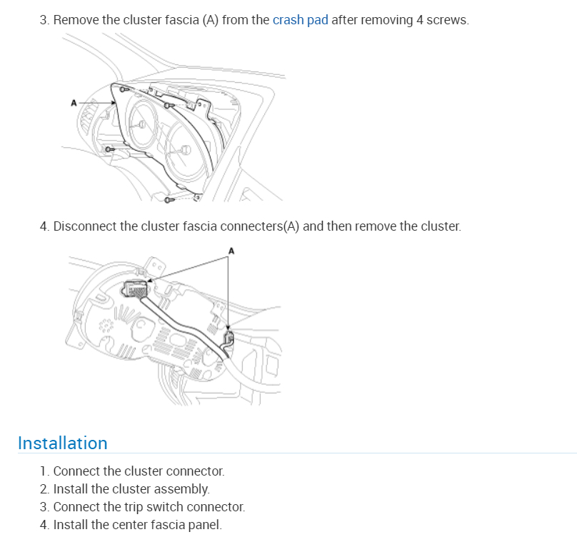

here is how to change the cluster out which you can get a rebuilt unit by searching google or eBay. Check out the images (below). Please let us know what happens.
