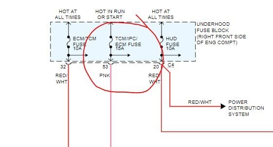

Instrument panel went black. The check engine light illuminated on startup and then shuts off. (Normal) but nothing else is illuminated. No oil pressure, speedometer, fuel gauge. I pulled and test the fuses, they all seem good. Any ideas?
Thanks.

I need to confirm that the two fuses in picture 1 were checked. Also, did you check the fuses for continuity and the circuit for power?
Often times, a fuse can look good and not work.
