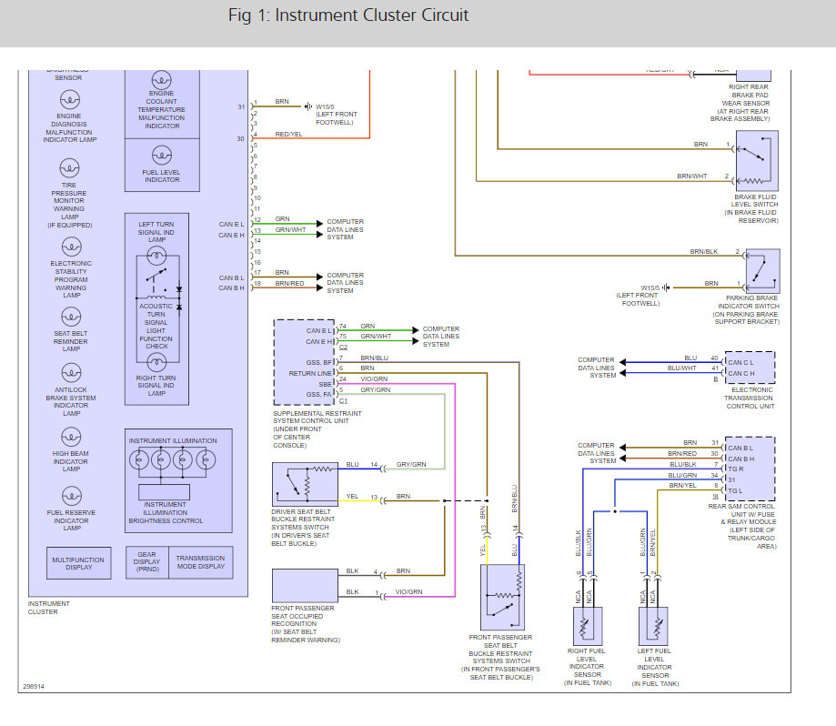

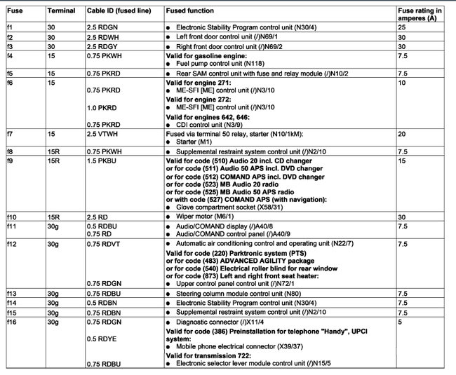

Just got in the car and central dashboard is blank, also gauges are not working for fuel, temperature, speedometer, tachometer. Also no sound for indicators, although they do work. I am hoping it is a fuse, but suspect an engine management unit? Car has been sitting for a couple of days.

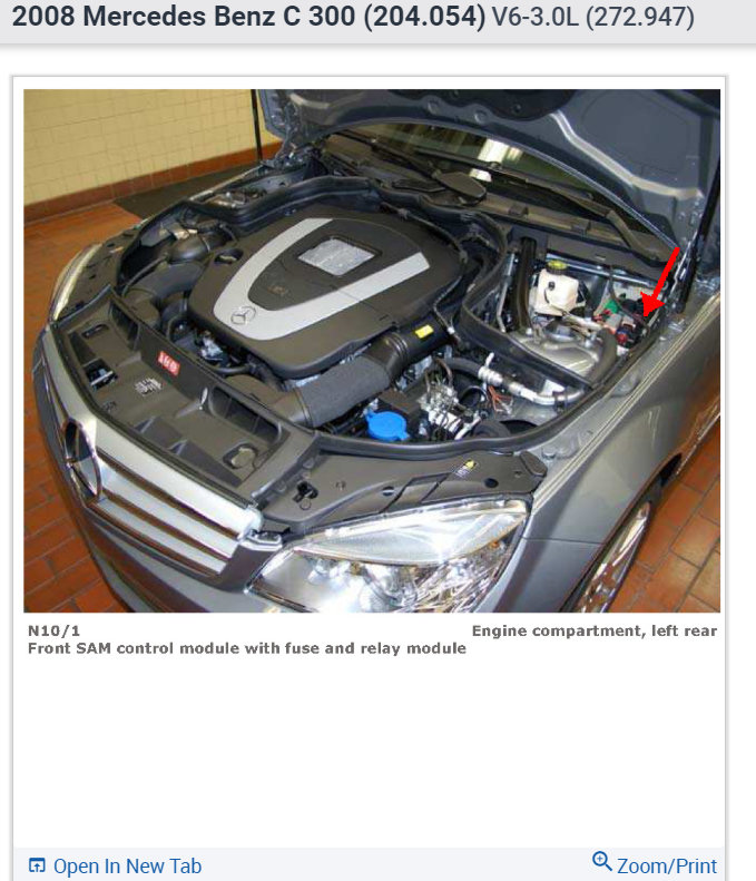

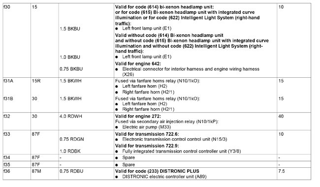

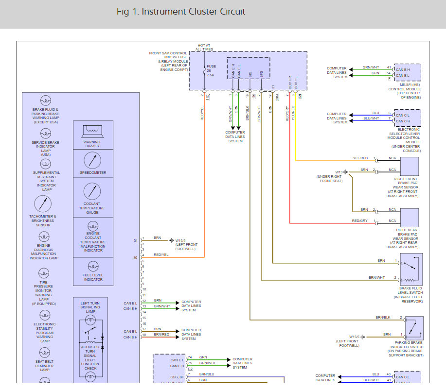

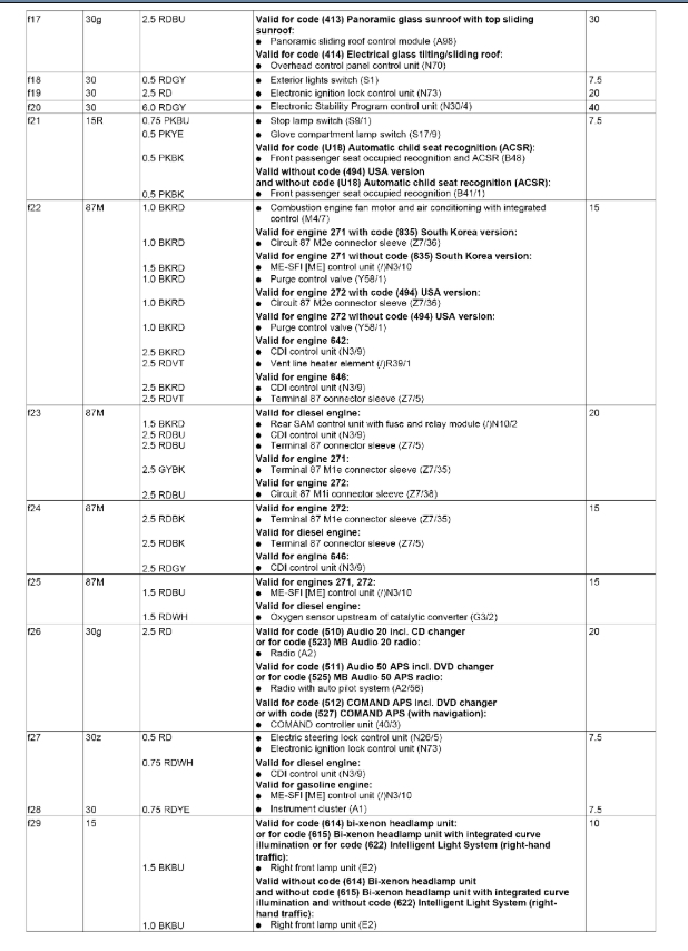

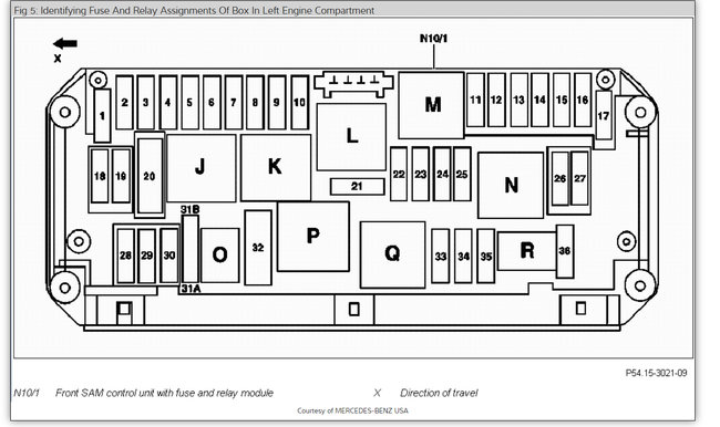

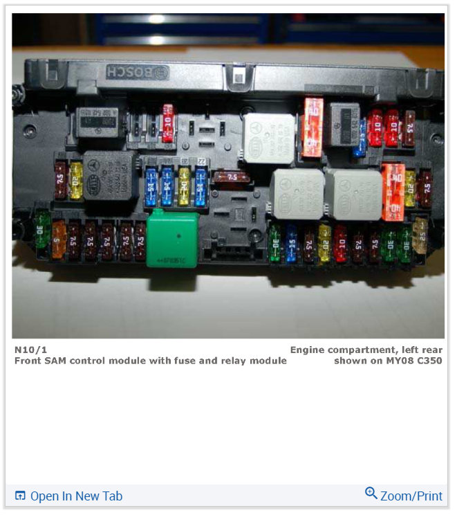

We must test fuse #28 7.5 amp under the hood is the front sam control. Here is a guide to walk you thought he steps with the fuse location and wiring diagrams so you can see how the system works below:

Thanks for the suggestion, unfortunately it did not solve the issue. I didn’t mention that there was a back-light to the main dash, that is on twenty four hours. I put in a new fuse, and nothing. I then replaced the old one and it came on, but as soon as I got the fuse box lid on and shut the bonnet, it had gone off again, it happens a couple of times. So what’s next?

It sounds like the SAM controller or the instrument cluster has gone out. You will need to do a CAN scan to see which one. Whichever one it is will need to be programmed in by a shop which shop cost about $130.00. We are doing a video on this on Saturday and have saved this post which will be updated then so you can see how the job is done.
