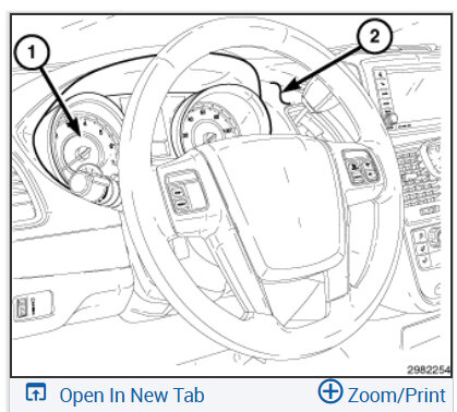

text display on instrument cluster has disappeared. Most of the info is displayable on small panel below the dead area, able to be toggled through various measurements. Three relevant fuses checked and okay.
Jun 17, 2025 at 1:36 AM
  • 55,616 POSTS

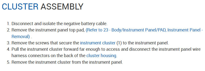

Yep, the cluster is bad and you need a rebuilt one. This is a common problem with these cars. Here is how to remove the cluster so you can send it in. Please go over these guides and get back to us.
