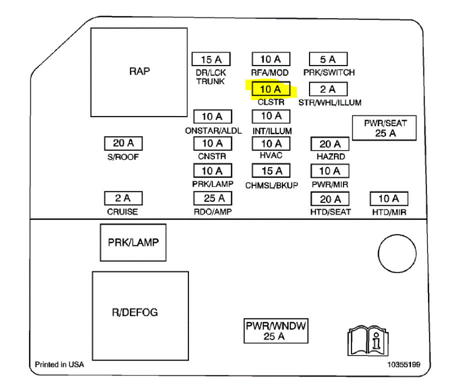

My car wouldn't start without a jump, though the battery was only a few months old. I had the battery replaced and drove 2 blocks when it shut off and wouldn't start. The mechanic checked and said it was the fuel pump, so he towed it and replaced the pump. The car still wouldn't start, and he said the ECM was bad, so it was replaced. Still wouldn't start and he said the BCM was bad, so it was also replaced. He said the car wouldn't accept the re-learn process, so I had another mechanic get the car. He found they had broken a part while replacing the fuel pump and the car wasn't showing it was in park. He repaired this and it started and runs fine. However, the instrument gauge still isn't working (it worked prior to all of this). The mileage does show, but it's registering. I'm hoping this is something I may be able to repair or at the least, not get taken again (the old BCM was still in the car and the second mechanic said it tested fine). I would appreciate any help.

When you say instrument panel, are you referring to the lighting, gauges, speedometer, or something other?
The first thing I would like for you to check is the cluster fuse in the interior fuse box. I attached a pic below of its location.
When you check the fuse, first confirm it is good. If it is, then confirm there is power to and from it. Here is a link that will explain how that is done:
When your vehicle wouldn't start, did the starter engage? If it didn't, chances are the park issue was the cause the entire time.
One other thing, just be prepared. The body control module (BCM) provides a lot of input to the instrument cluster.
Let me know what you find.
See pic below.

Thank you for your help. I'll check the fuses tomorrow. As far as the instruments are not working, it's the fuel gauge, speedometer, etc. I just got the car back, so I don't know about the lights because it was during the day. The mileage does show, however it isn't changing.

It sounds like you have had a difficult time with this. I'll try my best to help get the cluster working again for you. Let me know what you find with the fuse. If it's good and has power, then we will need to start checking wiring.
