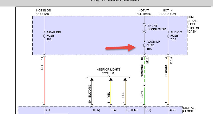

The instrument panel in dashboard is not functioning
Could this be a fuse problem, is so
How do I change the fuse?
Apr 8, 2016 at 4:29 AM
HMAC300
  • 48,601 POSTS
check fuse in pic if bad pull it out and push in a new one... you can use a test light or volt meter to test it if power on both sides' it s good. if cluster still doesn't work have it checked for being bad they are digital and can do that and be rebuilt.
