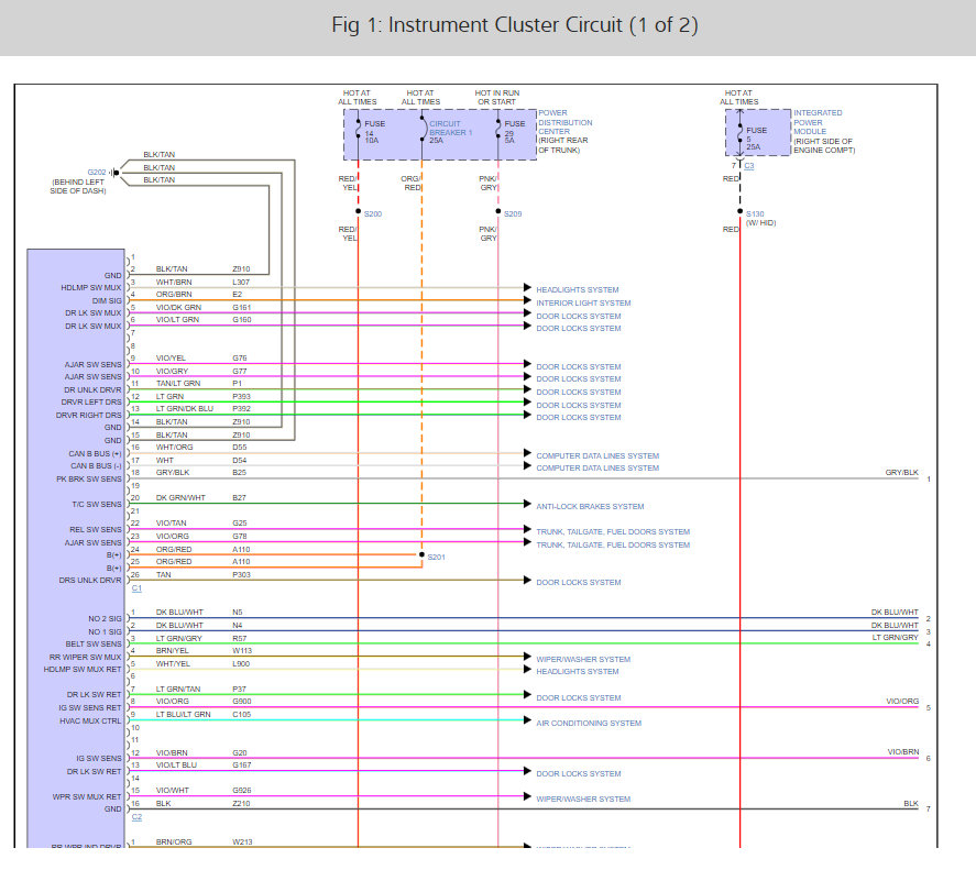

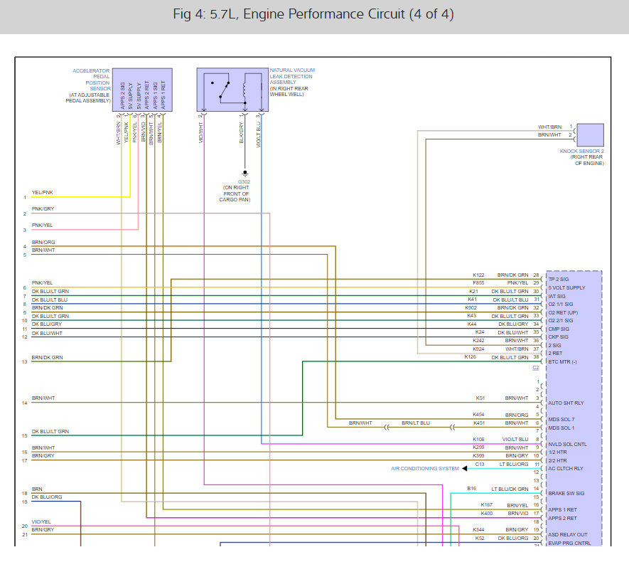

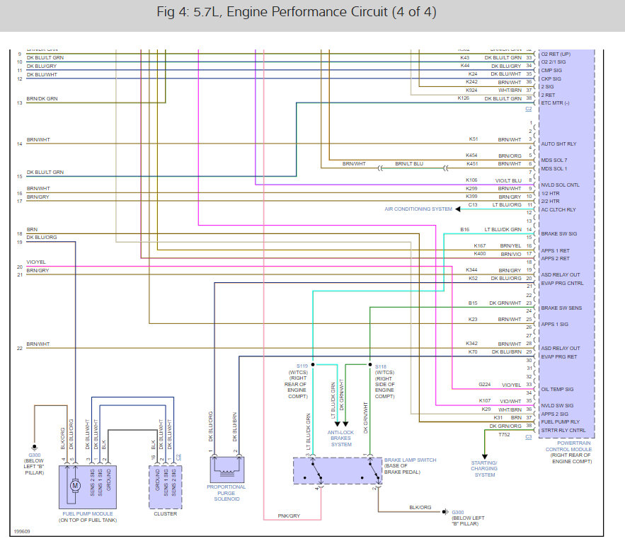

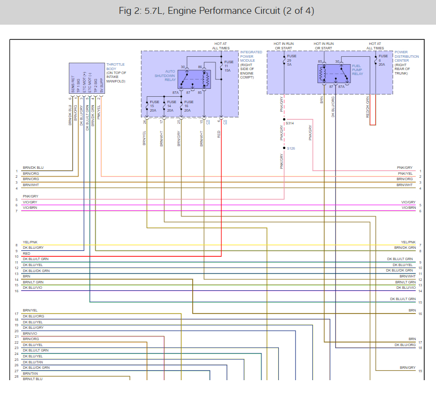

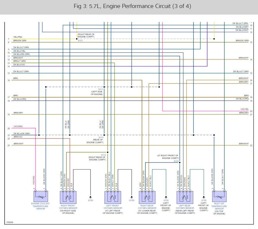

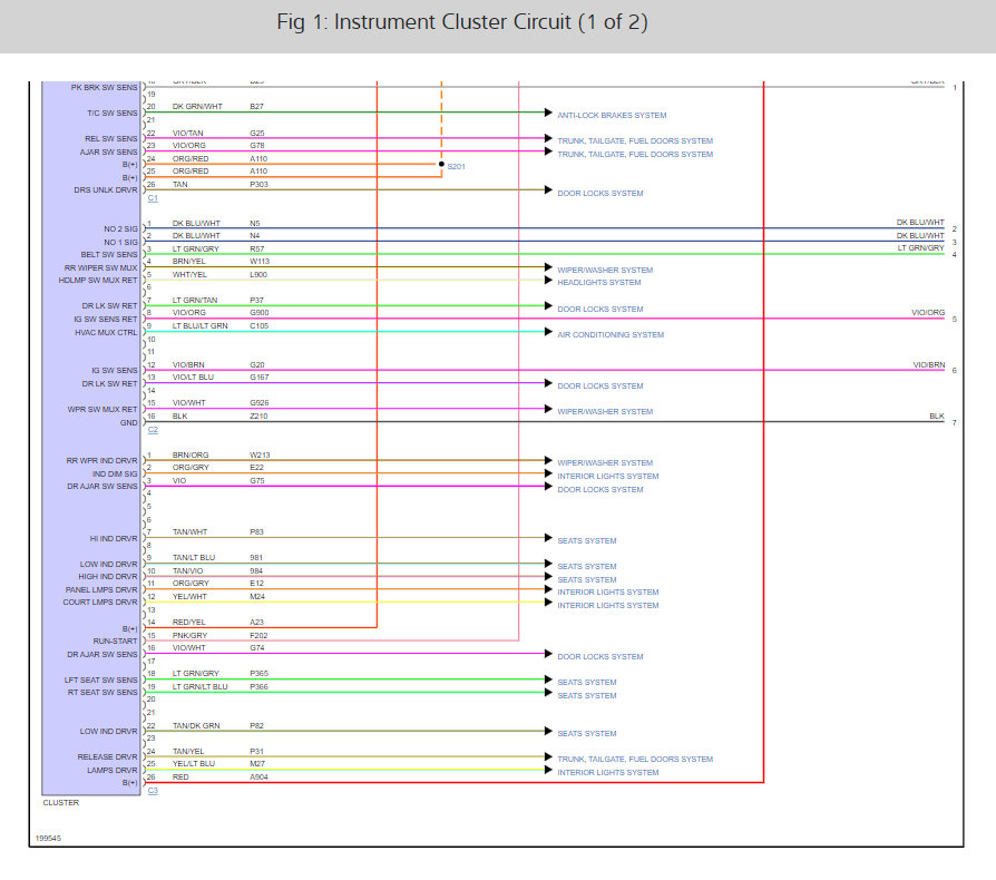

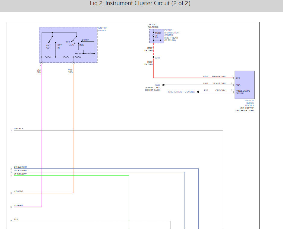

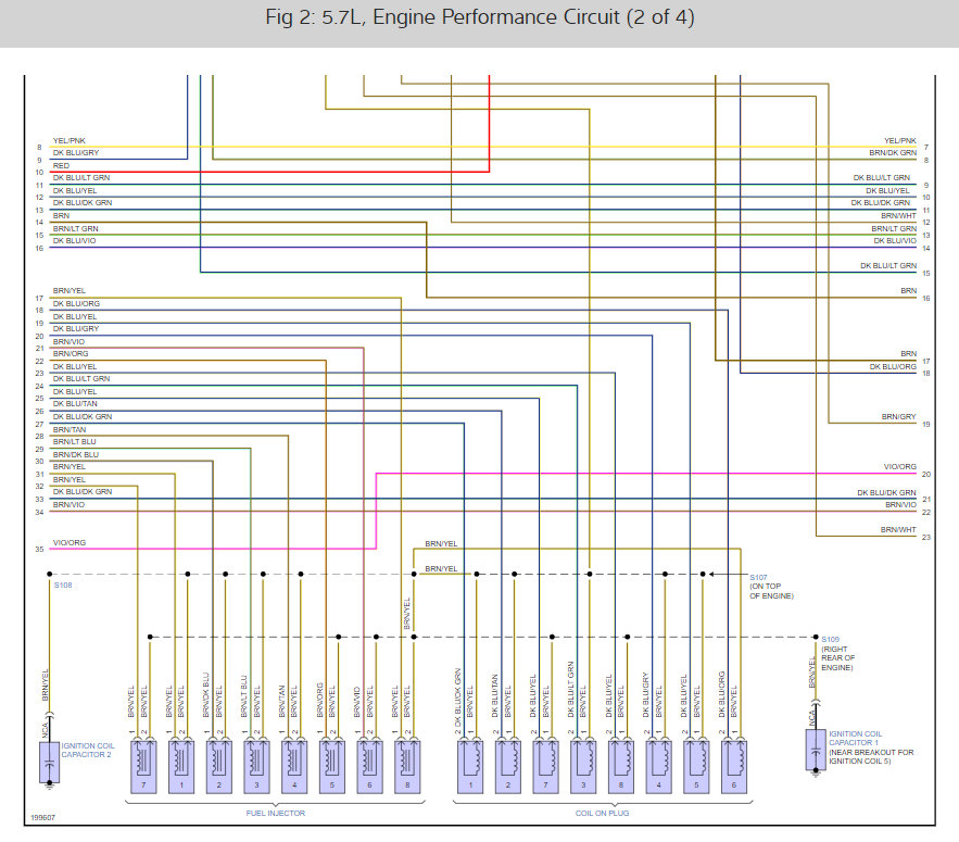

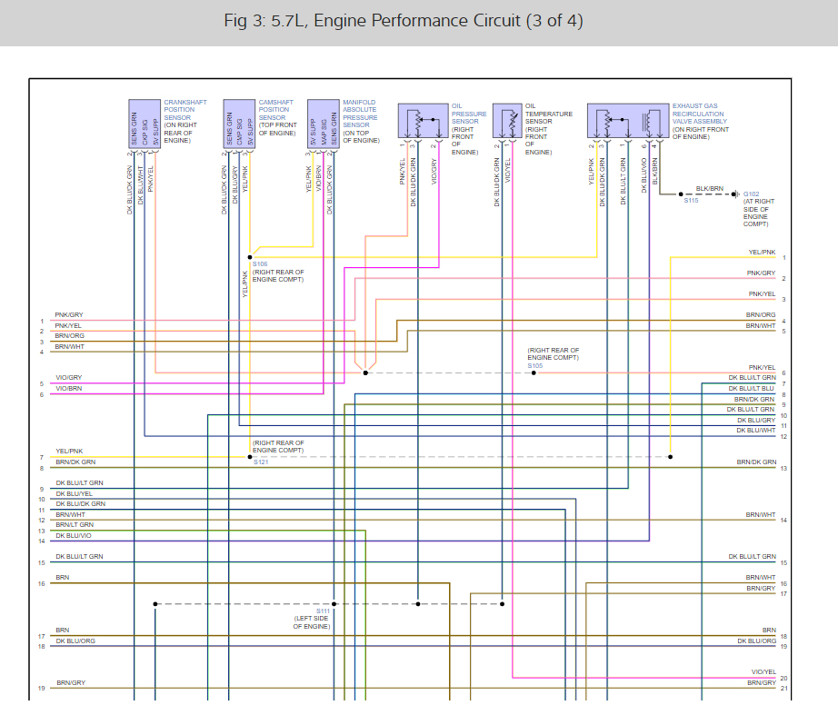

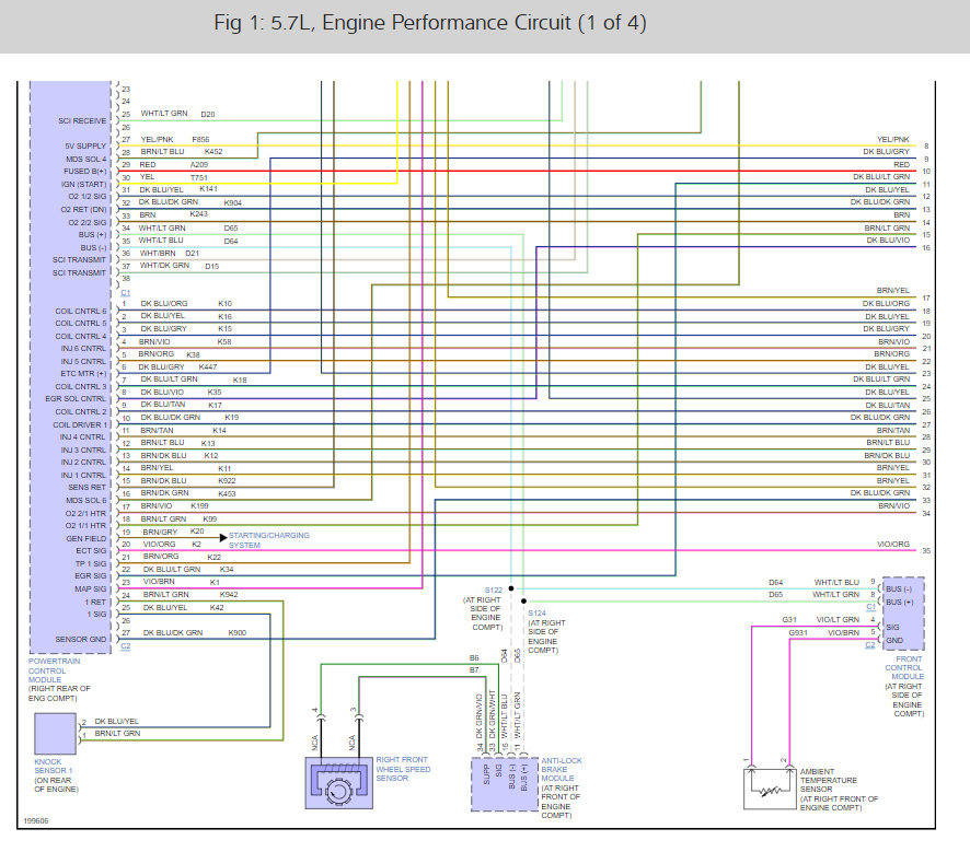

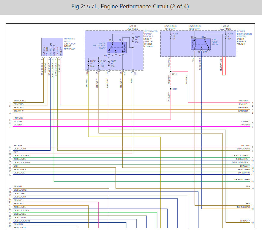

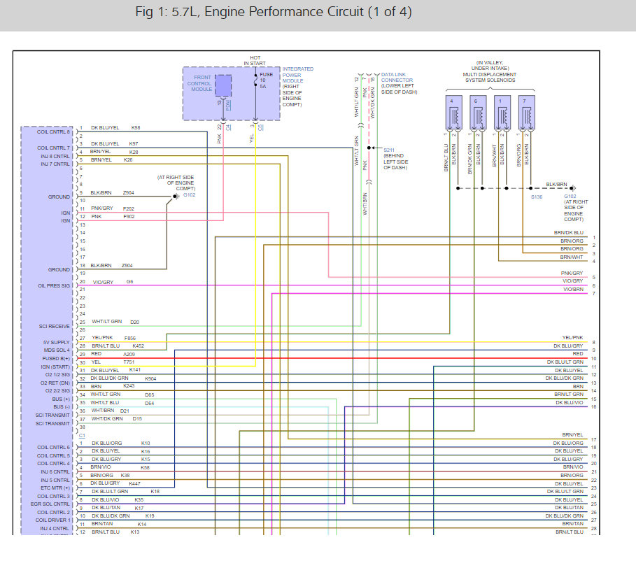

Turn the key no lights on instrument panel, no accessory lights on dash, no 5-volt reference on coils. I need color wire diagram for driver side dash ignition and PCM color diagram.
Jun 2, 2022 at 6:59 PM
  • 55,399 POSTS

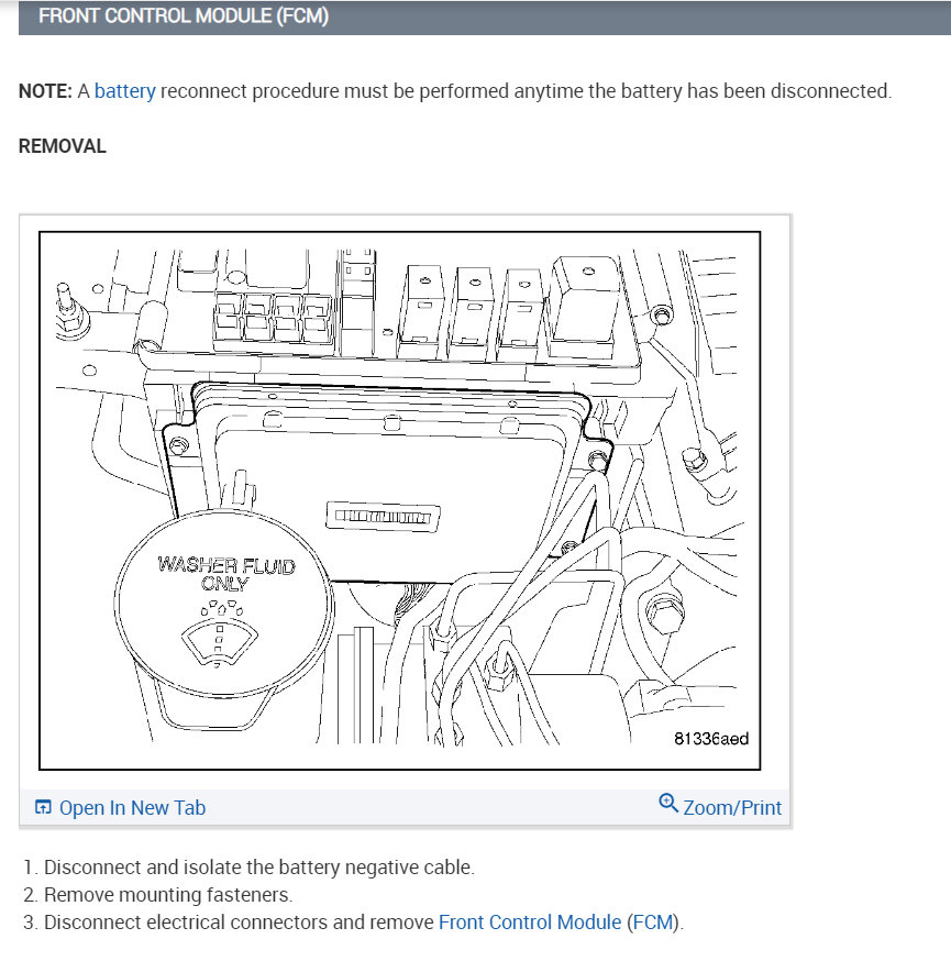

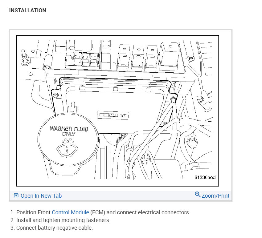

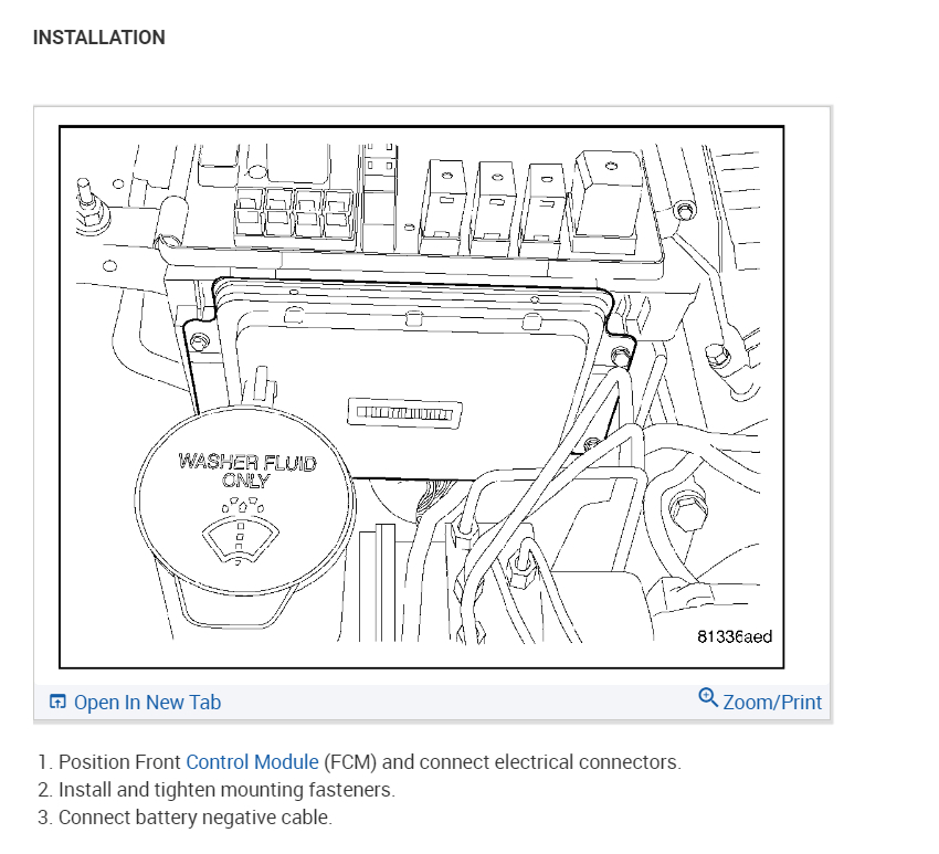

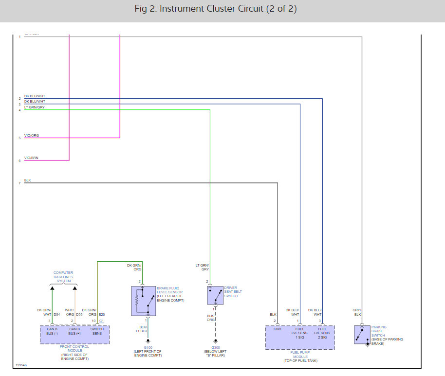

I have seen the front control module cause this issue. To be sure here are the wiring diagrams you have requested and a guide to help you check for power using a test light. I have also included the instructions on how to replace the front control module. The front control module is easy to replace because you don't need to program it. Check out the diagrams (below). Let us know what happens and please upload pictures or videos of the problem.
