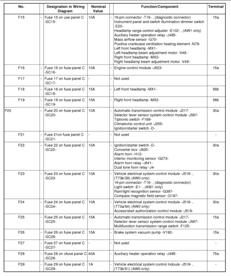

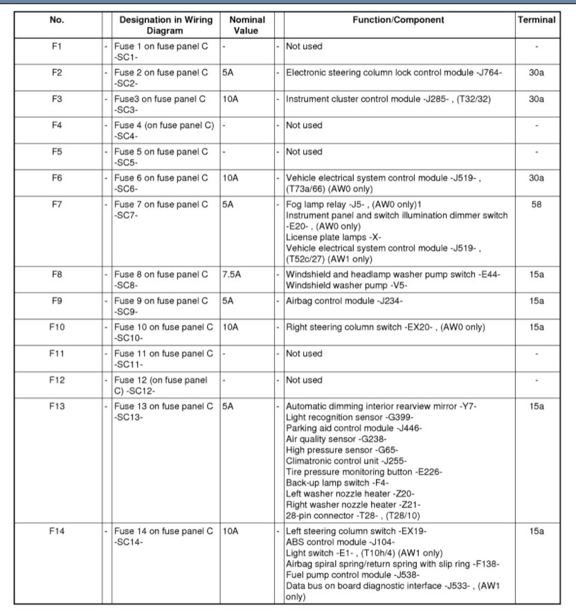

Since I've gotten this car when i turn the switch for the headlights, the instrument panel would light up. Recently i replaced some fuses that were blown. Now when I turn the headlights on the dashboard stays dark and i can't see to drive at night. I can't find which fuse would belong to the actual control panel switch, but i found the fuse to the dashboard itself. Especially because it appears to light up during the day. Is there a sunlight sensor? Is it a blown fuse? If it's a problem with the switch, do i get a new one or do i need to replace a fuse? I just need some professional guidance. Thank you so much.

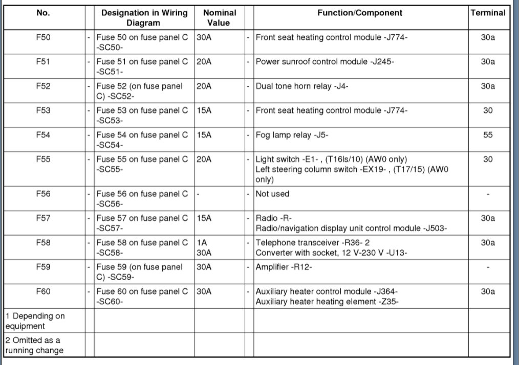

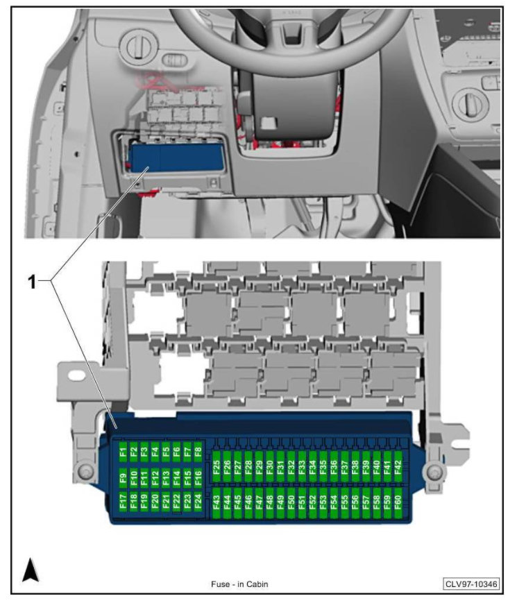

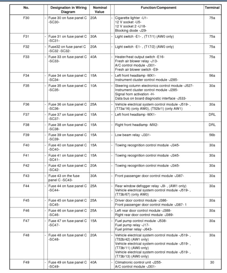

Lastly it could be fuse issue, so I am attaching the fuse diagram for the ones addressing the cluster and interior lights. However, the easiest way to find any issues is to turn the engine on and then use a test light and just run over all the fuses.
Basically, this will allow you to touch each tab of the fuse and the test light should come on for all of them on both sides of the fuse and that means they are all good.
