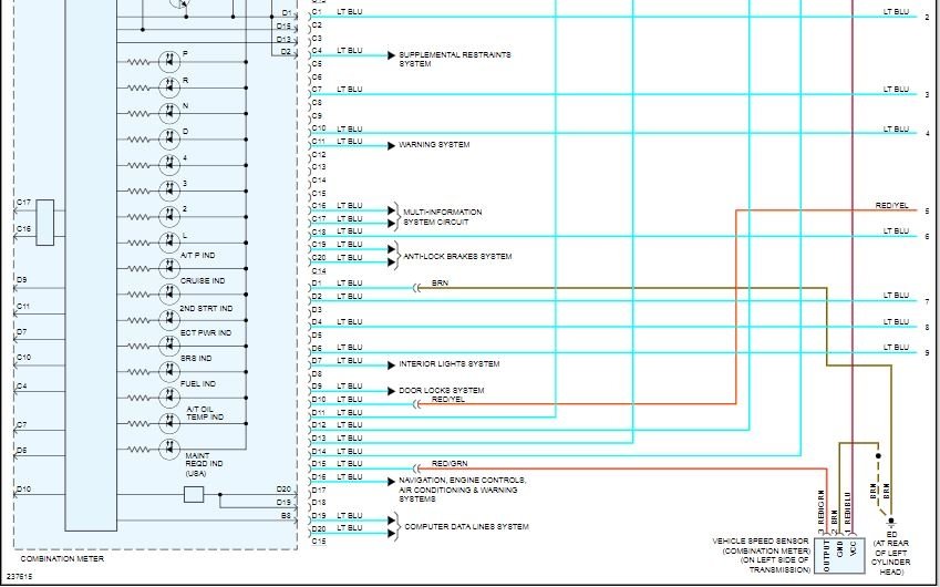

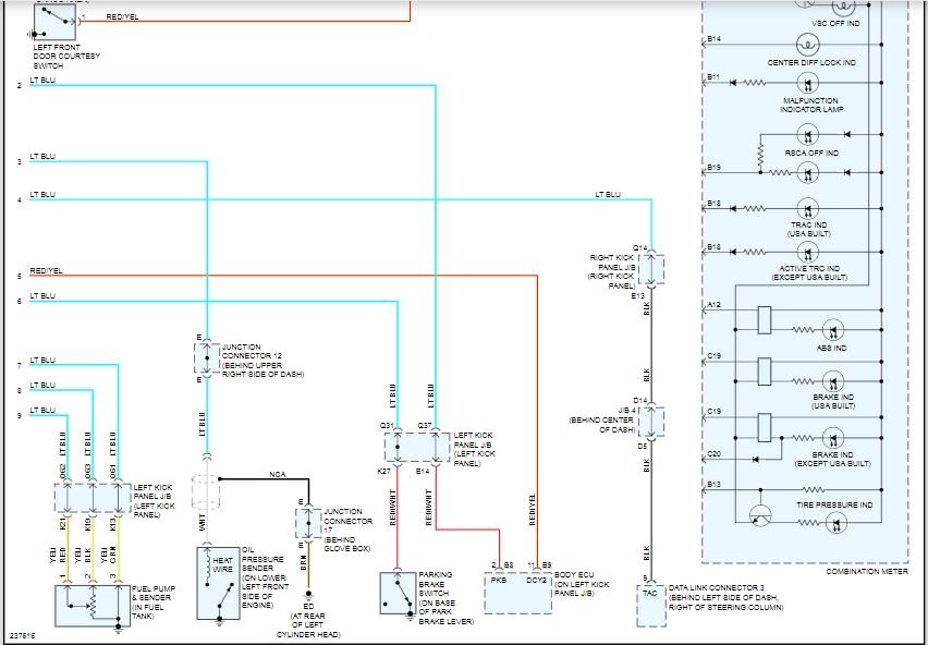

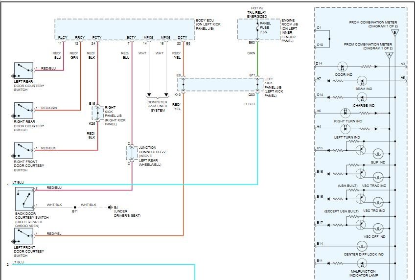

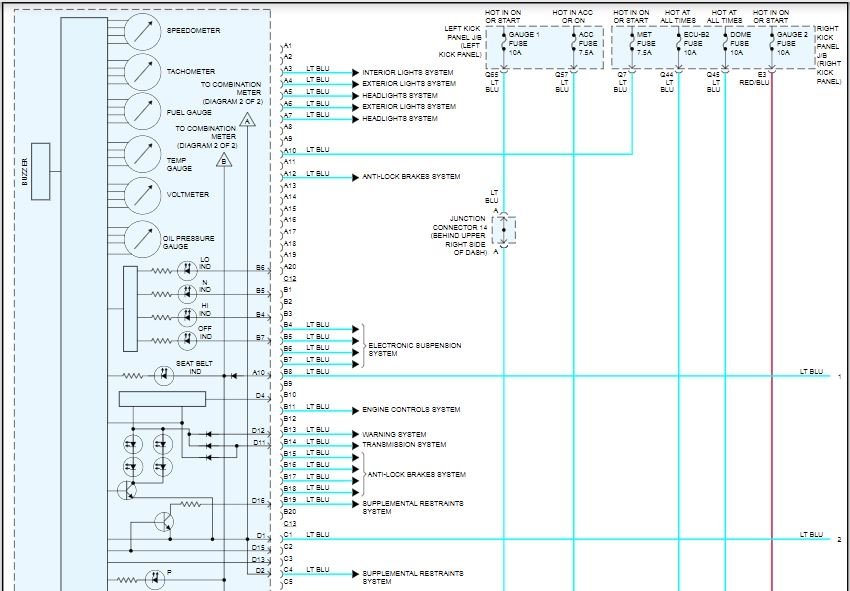

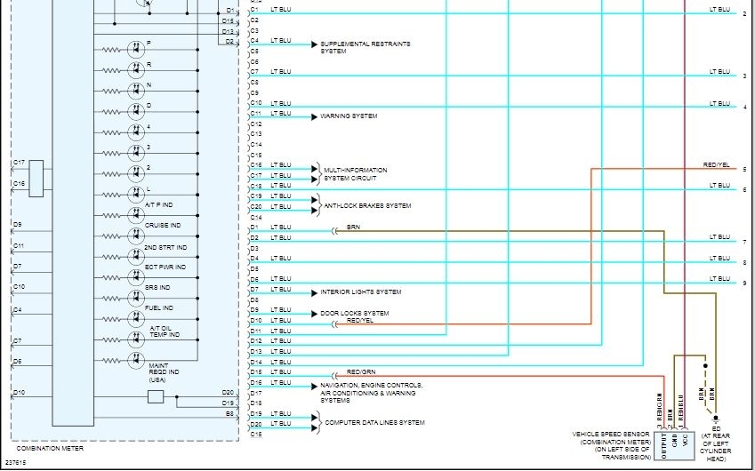

I'm trying to find the pin out of all 4 instrument panel connectors. each is a 20 position connector so 80 positions total.
I'm looking for the schematic of the whole thing.
I'm only able to define 47 positions so far.
Thank you
Oct 9, 2020 at 8:01 PM
4DRTOM
  • 467 POSTS
Here are the diagrams for your pins. Let me know if you need anything else on this. Check out the diagrams (Below). Please let us know if you need anything else to get the problem fixed.
