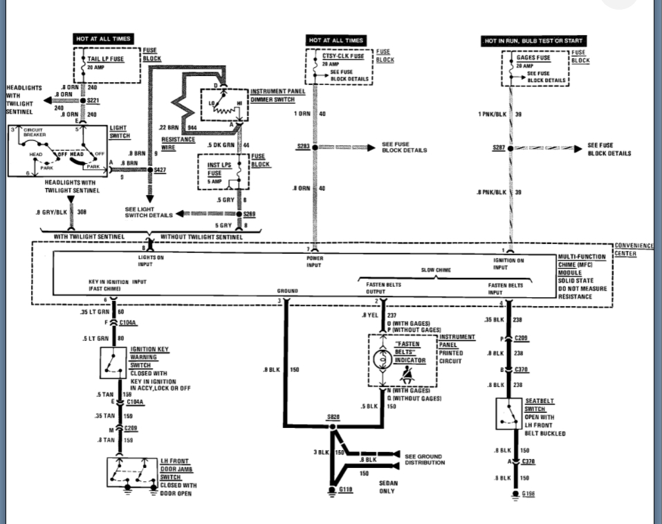

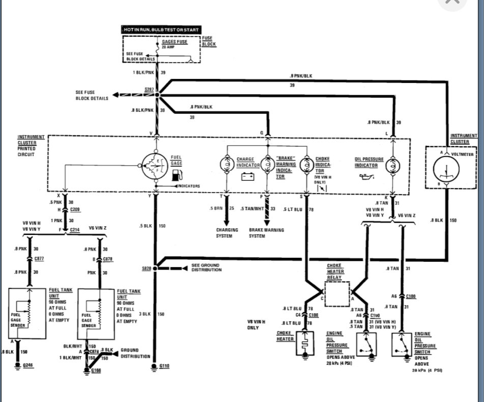

I am doing a digital dash install in the car listed above and I cannot find an accurate wiring diagram or pinout for the instrument panel cluster connector. I have to connect the new wires on the new dash to the old wires in the cluster.

We do not have a connector view on this cluster just because GM didn't provide the actual connector views for anything other then the ECM back then. However, I am attaching the wiring diagrams for this cluster/dash.
Please review this and let us know if you have questions or need other info.
